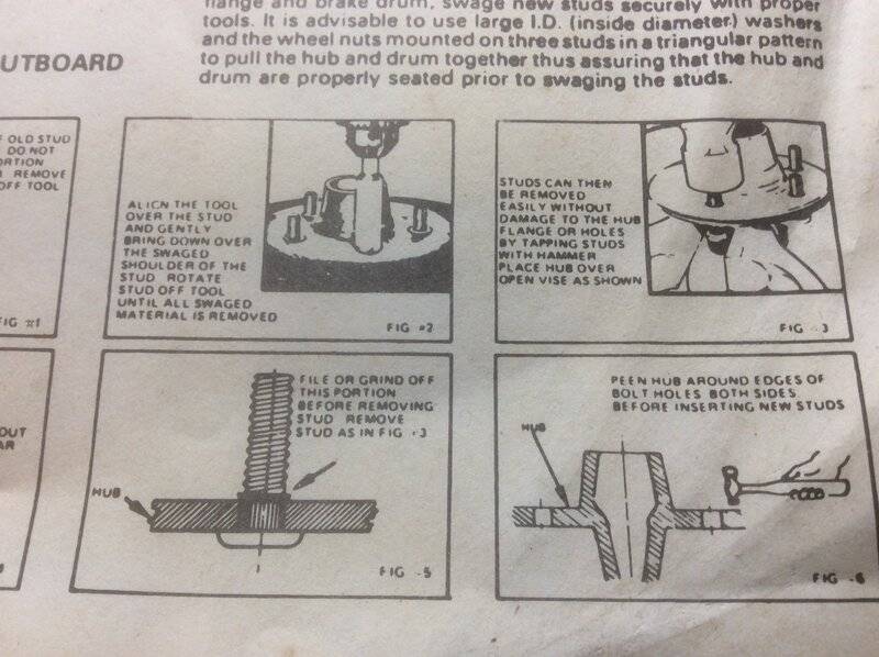

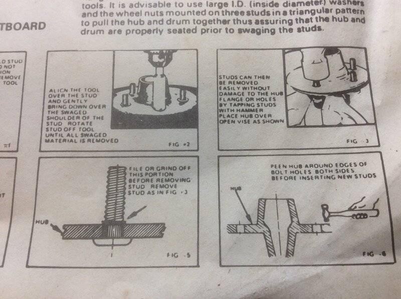

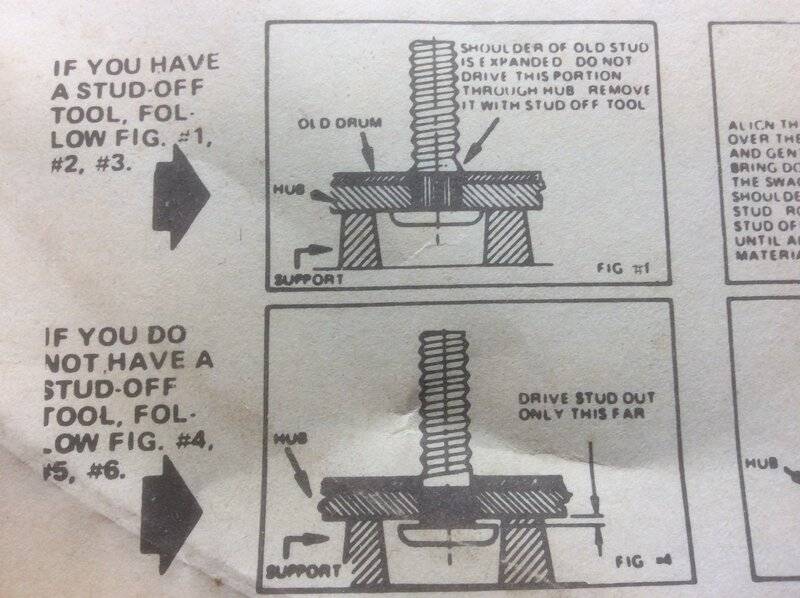

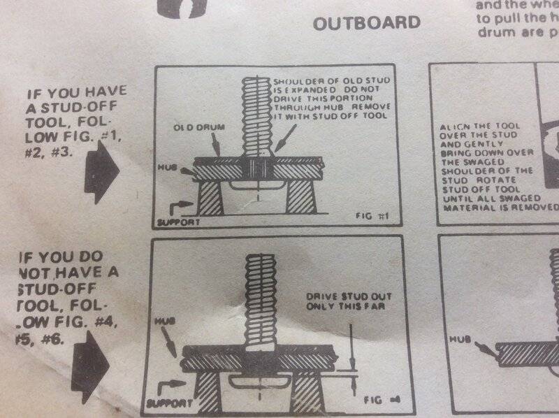

Here are directions for changing drums maybe they'll help? They aren't order. Maybe one duplicate.
drumray5.jpg drumray7.jpg drumray6.jpg drumray7.jpg drumray8.jpg drumray9.jpg

You can grind off the swedges with a small angle grinder or die grinder and knock them out. Might nick the drums a little but it'll work.
