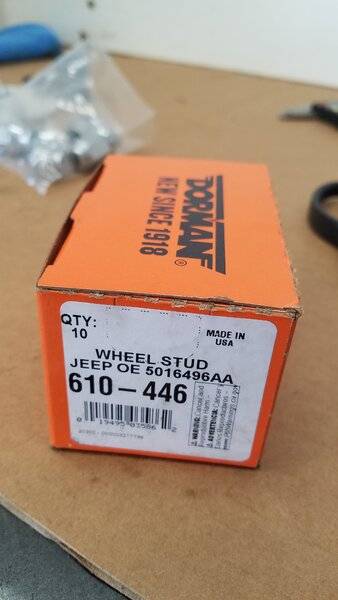

Try Dorman 610-446. They are about .35 inch longer than stock. They also have a .010 larger knurl. They are listed for Jeeps. I just bought them for my front disc brake conversion.

thanks!i ordered 10 last nite from autozone...just 2 bux each
