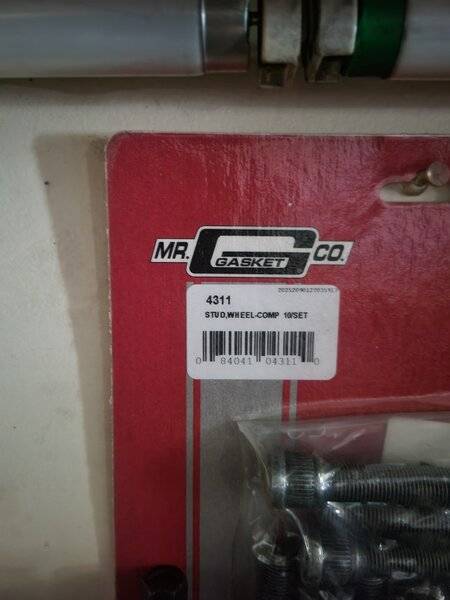

These are the long back ones.. you could cut them down..
