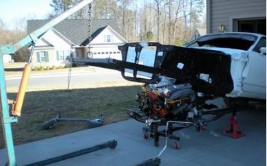

Some C channel and 2x2 box tubing bolted to the front bumper bracket bolt holes. I cut a thru hole in the C channel and laced the square tubing, fillet weld and your all good. Take a swing by any local metal salvage yard, costs pennies on the dollar brother.

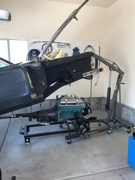

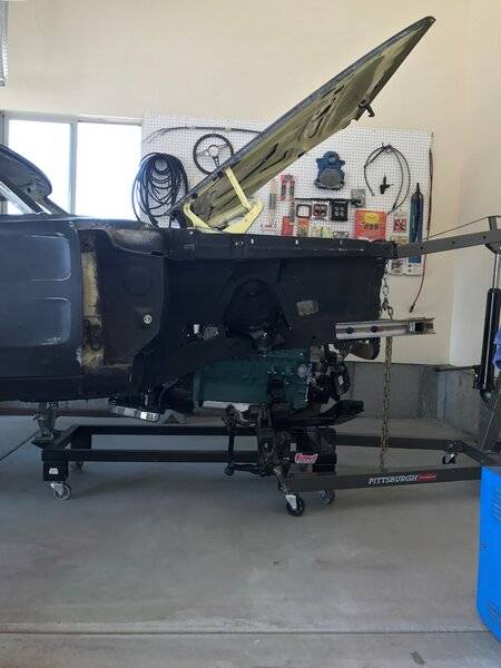

View attachment 964285 View attachment 964286
Good stuff. Do you know about what height you had the k-frame attachment points off the ground? I had originally been thinking as low as possible, but it just occurred to me that I wont have any upward adjustment on the dolly so the k-frame needs to off the ground a fair bit to meet the car.
If you are up for a drive I have the whole set up for sale cheap. I do not want to ship it. uni-lift, k frame stand, front and rear body wheels. I am in zip code 14040. PM me if interested,
I can get you some measurements after work... So you want the numbers from ground to top of K frame mounting points?
