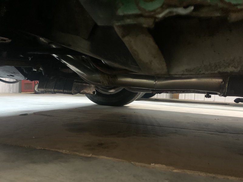

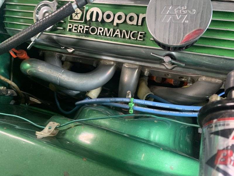

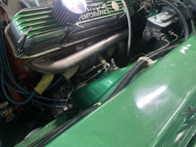

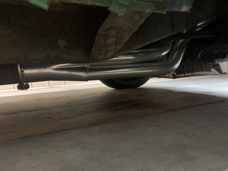

Nice thanks for the pics. Is it straight piped or do you have a H pipe with themView attachment 1473083
As stated, these are 10+ years old ceramic coated Patriots. The car always sat on my carport until last Summer.
Long tubeDid you go shorty mid or long tube?

Remember not all of these Headers will work with angled plugs
The Doug's work fine with my Edelbrock RPM Heads (angled plugs) and I dont burn any boots
I do use a protective sleeve over the boots
I have an H pipe. I wouldn't think there would be a difference between 66 and 67 Charger's as far as headers are concerned.I have searched the internet and all I have found for the patriot long tube ceramic coated headers is for 67 and up can’t find a 66. Is there a difference in the 66 and 67?
