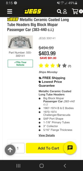

I'm going to recommend Jegs brand ceramic coated long tube headers. 1 7/8" primaries, 3" collector. I've had them on my car since mid 2017 and they are still holding up. I did have to clearance a tube on the pass side to clear the torsion bar. They fit stock / Stealth with straight plugs. Plugs are easily accessed. Starter is easy to get to. I'm happy with them.

I was wondering about the jegs. You said clearance issues on passenger side, I’m wondering if that will interfere with my sniper o2 sensor. Well actually it has to be about a foot after the collector and angled at 10 o’clock so maybe it won’t.
No interference at all. I have my Sniper o2 bung welded in the pass side collector. Angled up and toward the transmission.

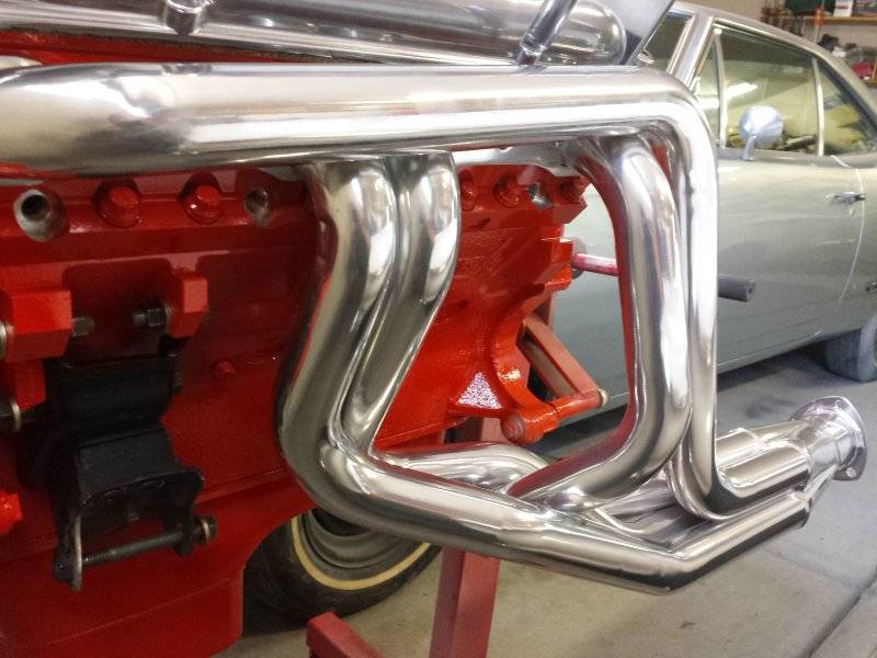

had a set of hooker headers on firing stand on my 440 six pack burnt many wires way to close to header tubes hate to see motor installed in cavity and keep wires from burning went back to hp 440 exhaust

Never had good luck with hooker always had to ding them
Yes. Also, the collectors aim straight back, requiring 2 pends in each pipe to fit under the humps in the trans crossmember.
Slight S bend in the drivers side
383 sits lower and tighter.
I modified the cross member for clearance. Wasn't all that hard either way.
