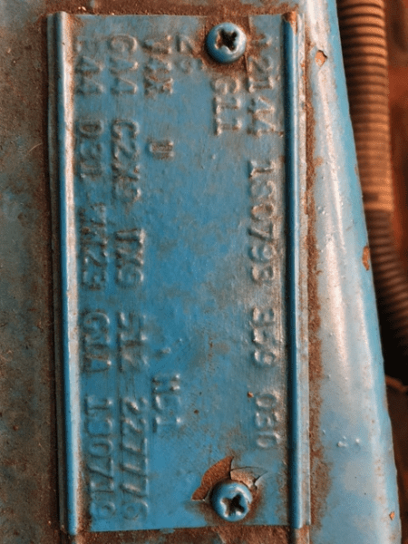

For a friend, top right of Lynch Road car tag. My R/T has 444 042 which is 440 4 bbl, and 323 rear.
His is 359 engine 330 axle. Any help on these codes is grateful. He has no build sheet.
These are to only ones I have seen for 71

Thanks guys. Just the axel code to figure out. Maybe a 2.76 which was standard.
My first car was a 318 in the mid 70's no one looked at fender tags then.
To expand on this a bit - 359 is for a 318 2bbl engine that is going to be mated to the Auto trans, and outfitted with A/C. Double check that Axle code - possible 033? I have 029, 030, and 031 as 8-1/4" axles.
Edit - if it is 330, maybe that is the axle code for a 030 axle with a sure grip unit.
