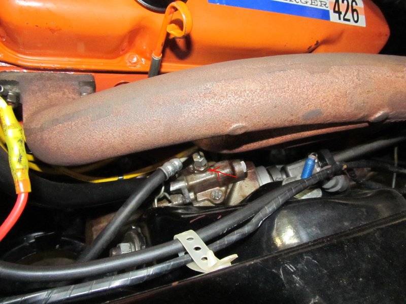

Not sure if it can be purchasd separately or even what it would be called, but in the attached photo I need the fitting for the top of the pump that the black and silver line connects to. Taking the manifolds on and off a couple times banged up the end that the flared fitting seals to and it leaks. I tried one of those copper washers but it still will not seal. If anyone can steer me in the right direction I would appreciate it!
There are two sizes used on the flare where the line attaches. I believe 68 and older is 5AN and 69 and newer is 6AN. The threaded end into the gear box is the same. They can be swapped but the hose needs to be changed. Just google them they are allover or cal a gear shop like firm feel or steer and gear.
