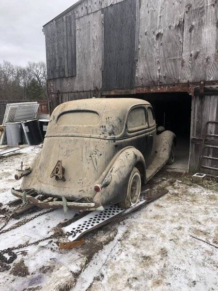

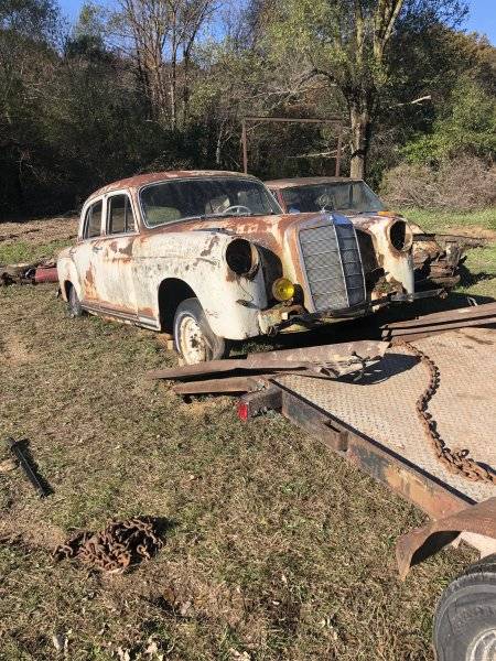

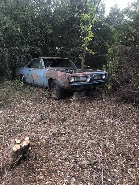

For the past almost 2 years I’ve been doing exactly what you plan to do. Just me, my old truck, a hand winch, floor Jack, blocks for cribbing, and my 2 metal sliding “bulldozer” ramps. I jack the front of the cars up as high as I can, back my car hauler under it as far as I can, then use the bulldozer ramps and slide it under the car as far as possible. Lower the car down so the front wheels are on the sliding ramps and start winching. The metal to metal of the 2 ramps sliding makes winching the car in pretty easy. I’ve done about 10 cars like this, with all manner of different obstacles along the way. To me, it’s a challenge, you need a few different lengths of chain, you just never know where you’re gonna have to hook something. I also highly advocate putting a piece of steel under each car ramp and backing the trailer up to push the ramps under the front wheels of the car
A winch on a pick up may help, with some floor, roller jacks, and some Good, wide boards to get under the tires, and out of the ruts. Good luck, looks like a Nice Find !
