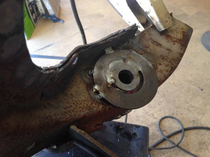

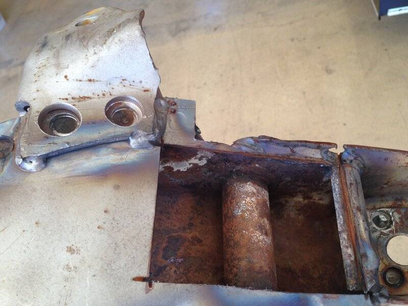

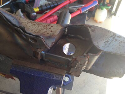

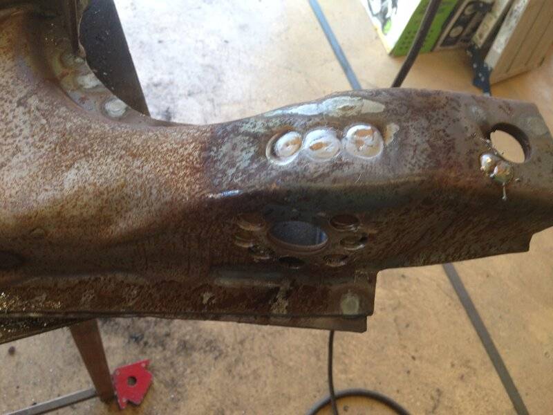

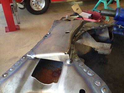

I'm staying with OE based stuff. I bought all Firm Feel. On the K frame, I'm doing my own mods. The main thing I did was go around with a Blair Rota-Broach set and add in 130+ welds to the unit. From there I added big washers on both ends of the control arm shaft tube, cut an area out of the K to access the back sides of the tubes and toss some weld on both ends, add in material where the strut rods mount so they have more attachment to surrounding areas, add skid plate. I still need to do the topside of it around the steering box, engine mounts and some other areas. There are lots of ways for you to go on upgrades. OE may not be the trick of the month but it does have a track record for longevity with road conditions, putting up with kids version Dukes of Hazard and living, ease of sourcing replacement parts etc. Put up with old NASCAR and Trans Am too. For me, the trick of the month stuff needs to see 100-200k + miles of road conditions that vary from smooth to booney bouncing before I think its ok to use for upgrades.
IMG_0889.jpg IMG_0892.JPG IMG_0894.JPG IMG_0904.JPG IMG_0907.JPG IMG_0909.JPG IMG_0915.JPG

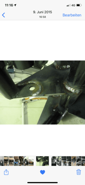

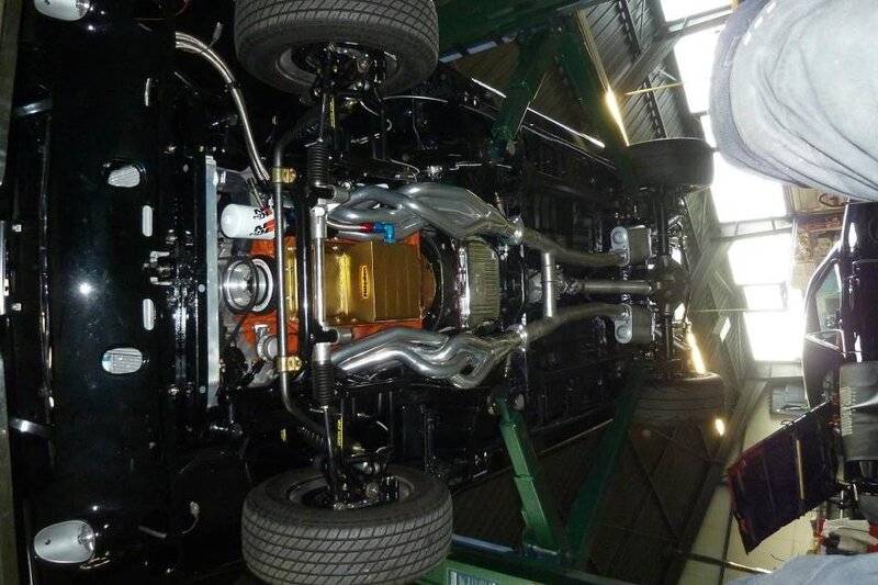

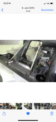

Can you show some pictures of you’re first generation control freak front suspension , I very interested in it how yours look .
When you installed it ( year ?)
And you Have the retro fit kit in it too?
Or was it just for the B-Body‘s ..,

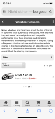

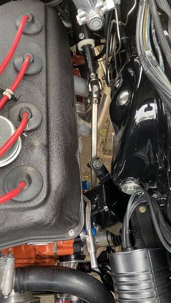

I still have a vibration in my steering between 65-85 miles , since the beginning .
I try many things already , but never get out the vibrations completely .
but now I see Borgesen sell some nice coupler joint‘s with a vibration reducer in it . This will be my next step to take the „ Standard“ flaming river coupler on the steering column side out and exchange it to the Borgeson joint with vibration reducer.
I’m curious about it if it’s help‘s or not to eleminate the vibration in my steering wheel . D0D7890D-3FAD-4B49-BC64-DAA70B996D02.jpeg
Use anyone this vibration reducers From borgesen for rack and pinion steering already and have good experience with it ? 1D67AD27-D348-47EF-A060-07844EBAB89D.png
I was considering control freak's suspension for my '70 Superbee build. Why are you getting away from this? What do you not like about it?
Now my first generation Control freak suspension are much upgraded , with a retro fit kit , chassis tubular frame is re-welded and add some square profile steel and some fins to the tubular frame for make it „ stronger „ also the B-Body is reinforced with inner fender bracing , Heavy lower radiator support steel , torque boxes front and back , sub frame connector s and muck more . Upper control arms was changed to adjustable ones from RMS , because the first generation CFS upper arms was non adjustable and give not enough caster . Now few month ago I inspect a hair crack in one welding of the lower control arms from CFS first generation , I take them out , re weld with add some fins to make it stiffer , and re installed . Now I back on the road , all looks ok, but still the vibration in my steering since first drive with this suspension from 65-85 miles .
