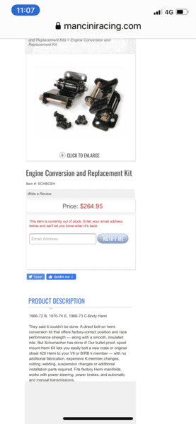

What you guys more recommended if I use a 1970 K-Member for my 68 Charger with the Hemi .
just use the conversion motor mount kit Like the picture ? Or transform the K-Member Motor mount brackets to a Hemi K -Member ? and if , how to do it ?

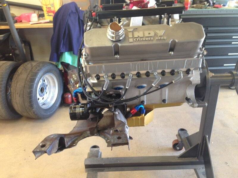

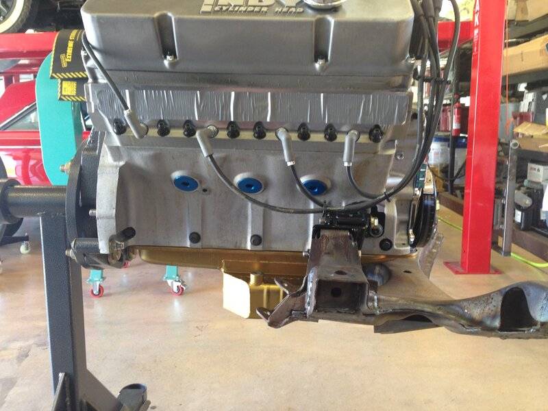

Those are the same mounts I used for the Indy motor for my car with the 70 k. Had to do a little whittling on them to fit some of the main fasteners on the block but you may not have that issue running iron.
