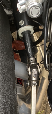

See if any of your tire shops have what I believe is called a dynamic wheel/tire balancer. What this is is a machine that has a separate roller that puts force against the tire/wheel combo as its being spun for balance. This duplicates the road load on the combo and will tell you if you have an issue there. I have seen, from working at dealers, where a unit can be spun balanced and read good but still vibrates at road speed when using the normal balance machine. Also, Roadrace65 who has not been on here in awhile has the Control Freak package on his 65 Belvedere and I think he has done some laps at Willow Springs with it. Last I saw him, he was working for Champion Radiator. Name is Mike Harding.
very interesting , I will look for it , but can’t believe Germany tire shops have a dynamic wheel/tire balancer. i still looking for some tire shop who can fine balanced my wheel directly Mounted on the car , because also this will give more and better balancing .
but anywhere I still think the damn vibration in my steering wheel just cone from this solid steering shaft s and joint ‘s without any dampener in it like it was original ....
This is pretty hard to diagnose via the internet. IMO there are 4 possibilities here;
1. there is slop in the steering system somewhere; steering box, linkage, etc.
2. your alignment is not accurate or something is loose
3. you have a bent wheel
4. you have tire balance issues
thanks for your suggestion’s!
4. Many time balanced again , buy brand new wheels again balanced more than five times, no change . Also use other Aluminium wheels where run very good on my other mopar, but on the charger also not without vibrating in the steering . Means point 4 I think is not the problem
3.i don’t think so , because also different wheel changes make it not Really better
2. nothing lose, ten times checked already , alignment I check it in tire shop , because my shop who build the car alignment the car just in his garage with “normal “ messure and level tools” and the real tire shop with computer diagnostic shows me , different ‘s between left and right in caster , chamber . Caster + 4 degree right and 5 degree left . Chamber also about 1/2 degree different between left and right .
you think that’s can be a vibration problem in my steering wheel ?
1. Steering shaft and joint s all be good , just the missing O-Ring between the column bracket and retainer on the firewall , ( the 4 clips around the outer column Shaft I already order it and get from” Member moparmaniac “ but get only 3 until now inside because my inside shaft In the column are not 100% center / or the outer little bend . I will fix this too .
Also I will bring in a completely new rack and pinion flaming river FR502 , because the “ old one “ just 4000 miles on it but have a little play in the housing to the inner tie rod on passenger side .
after I get the clip number 4 / the missing O -Ring and the whole New rack and pinion in it I will see something change to good or still no change on the vibrating .
Next Idee is to install This Borgeson vibrating reducer joint , and take the normal universal joint without vibrating reducer out .
But for this Exchange I looking for a way to modified my original column steering shaft , because Borgeson sell this “ vibrating reducer joint’s” only with shaft end ‘s like double D ( D-D shaft’s and / or many different sizes but With splines / or pyramid style etc ., but they not seel it for smooth round shaft ‘s without splines , because they fear the people weld it on and meld the vibrating compound in the joint .
But my 68 charger column Are smooth round without splines and already cut it and pinned for the normal flaming river joint coupler .
I must have missed it, but are you running a rack and pinion front end?
I would not claim to be an expert but IMO you want pretty much the exact same specs on each side, or very close.
When you say "vibration" does this mean like a side to side vibration or is it just a vibration like going over small bumps or something on the road. If it is side to side, then its more than likely to be an alignment or tire issue, if it is just a "vibration" coming through the steering wheel then I would say it is an issue of transmission of the road up through the steering system. This would speak to a lack of dampening or too stiff of bushings.
You say you do not have this in your charger, so what is the difference between the 2 as it relates to front end suspension and steering?
Yes, it’s a rack and pinion front end without any “ vibration dampers „ in the whole steering .
the vibrating what I have and mean starts at 60-65 miles and ends about by 85-90 miles . Or after 90 miles I never feel it again . If I take my food from pedal and coming back to this speed it will vibrate again , and under 60 miles it disappears completely .
It’s also on a good nice straight street , but sometimes I think if I get in to a „ curve „ left or right it’s disappears also ,or if I not try to cruise with Something like 60 to 85 miles , and accelerate the Hemi Quick up from 60 to 120 mph I also not feel the vibration in the steering wheel , because I think maybe it’s why everything is under „ tension „ ?
I think your first statement is at least part of your problem. If you do not have any isolation in your steering system you are going to get vibration. Most RP systems I have dealt with have rubber or urethane bushings in them, you might take a look at that.
As far as feeling the vibrations at specific speeds, I think this is a function of "attenuation" wherein the various vibrations merge in speed, duration and strength to transmit the vibration to where you can feel it.
I could be way off of course but I am trying to diagnose it from a long way away. I would look at the steering system and see if I could figure out some type of bushing or even a small piece of rubber between the rack and frame to provide some type of isolation.
I don't know if your rack has "Ford v" or splined ends but couldn't you use the new Borgeson u joint at the rack end and not onto the stock round steering shaft?. They sell a double D to Ford v u joint.
I understand , and think also about it . But I see two problems to put the Borgeson vibration reducer joint on the rack and pinion side .
First : i think I have not enough space for this „ bigger and longer „ Borgeson joint to exchange it with the small joint from flaming river , because my external oil system Hose are already very very near on the small FR joint .
Second . Borgeson recommend to put the vibration reducer joint after the „ steering support heim joint , means on column side .
Ok, I have just 2 joints in the steering , but anywhere I have also a support heim joint in the middle of my double D shaft , ( I know normally only recommended from using 3 joint s or more .
But it was already include with my tubular CFS system .

Looks like that joint is hitting that fitting. Not good. May need to go with a 120* unit and or replace what you have plus re-route to get away from the joint.
But it was already include with my tubular CFS system . View attachment 985251
I see what your'e saying. I have wondered how much vibration comes into the steering shaft from the rest of the car via the steering shaft support heim joint .I've always felt that the support heim joint should have a dampner built into it. What's the point of mounting the rack in rubber bushing if the car it's self is going to introduce a vibration farther up the shaft. Iv'e never looked it up but I wonder if there is anyone who makes a support heim like that?.
Good idea, I also think about the support heim ! Normally I not need it , I have just two coupler joints ! i will lose them up , so it’s free , and want make a test , if this support heim brings me the vibration I will give you a big box of German beer
