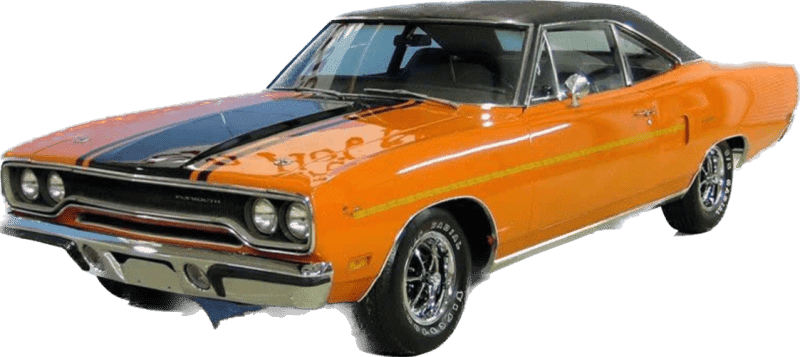

I agree colors are affected by lighting and angles. However I keep being attracted to the same tint hue of Orange see my last picture above. I just need help getting there. I wish I could get real paint chips and a decent recommendation of base coat mfg.

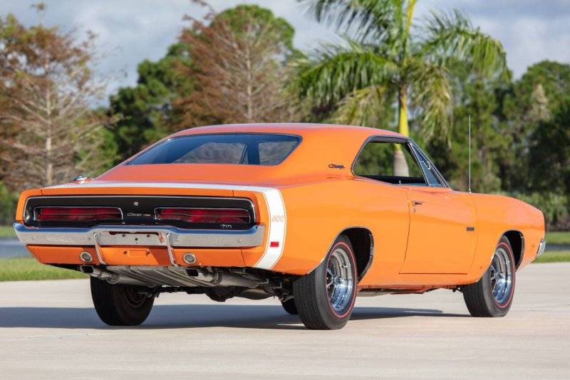

Charger 500 is Omaha Orange per
1969 Dodge Hemi Charger 500
Outdoors in Florida
Porsche is Signal Orange (outdoors in California)
RR is from OP
(Indoor lighting I believe). Sure is glossy. Nice color.
Lighting sure does make a difference!
