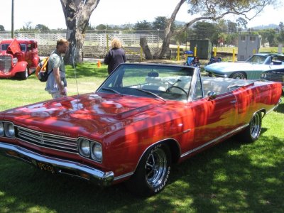

Joseph, you have a beautiful Satellite. Took a quick look through your garage and I'm particularly envious of the condition of that interior and exterior.
