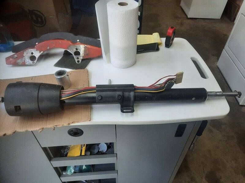

I have a 1969 dodge coronet rt steering column with a floor shift that needs a lower bearing. I have seen nylon repop bearings for around $90.00. I have herd that you can use a steel bearing (ER-16) in its place. has anyone on this site have any experience with this bearing?

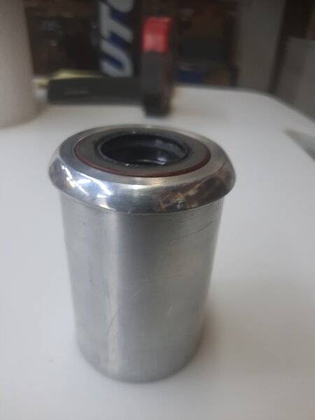

https://www.opgi.com/chassis-suspen...y88osPckl6lLMCeuDseJd2VYplY0OMARoCSooQAvD_BwE[/QUOTE I have seen these Before I made mine I did not like the fact that they would rush over time Also mine closes up the air holes They still exist at the bottom of the column Although I will say these would probably work Just not as nice

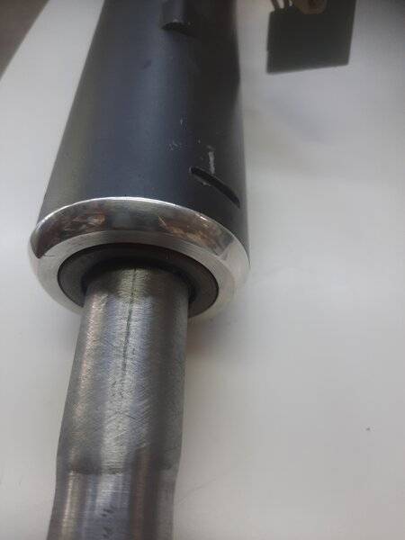

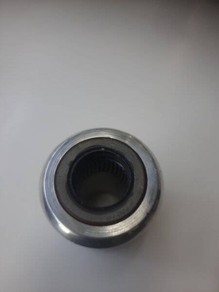

I went with the ER reducer bearing and will use the spring clip to retain the bearing
in the tube. Jim's wants $30.00 for just the spring clip! Holy Moly! The G.M. boys sell
the same clip for $7.95.
