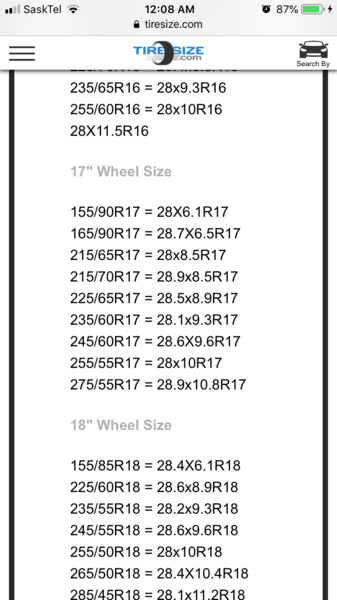

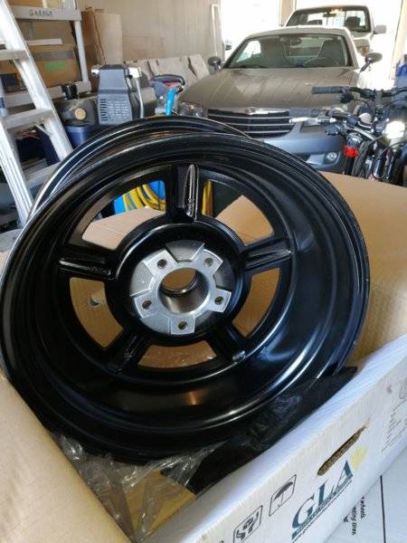

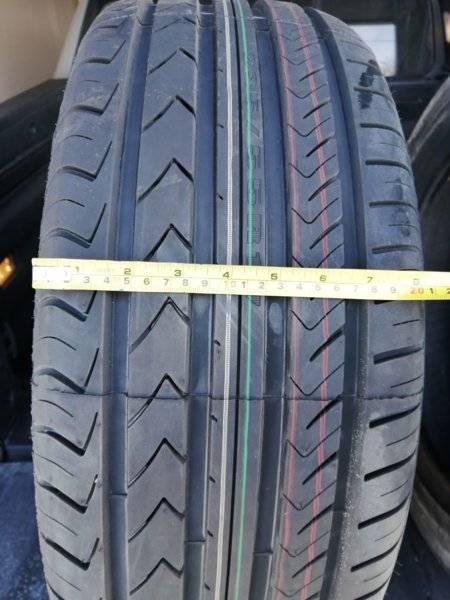

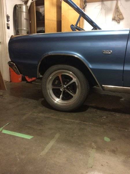

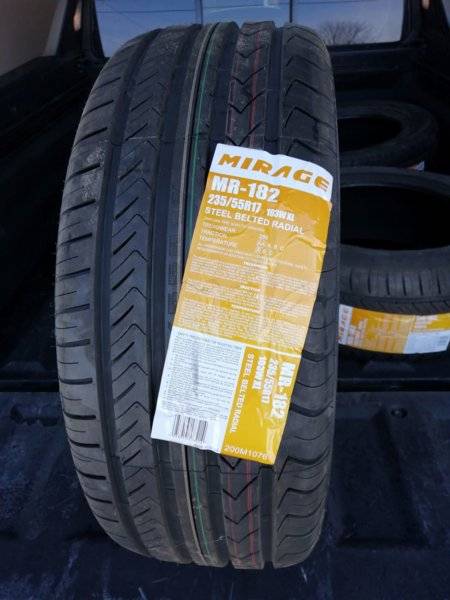

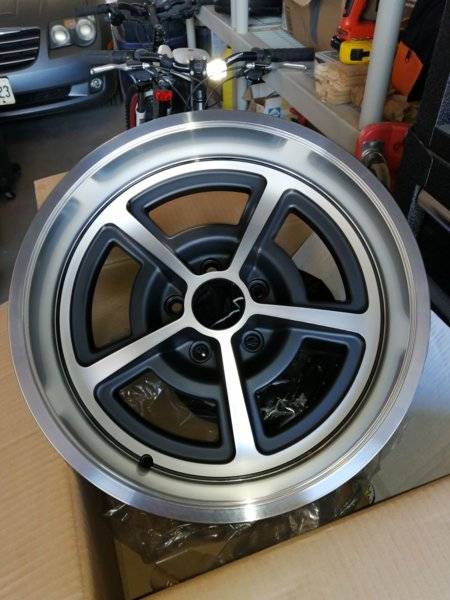

I suggest you do an in-depth search of available tire sizes before you purchase the rims.

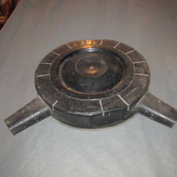

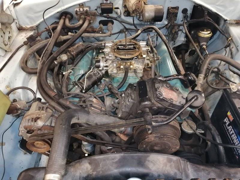

I wouldn't be too quick to toss that Carter. I think it's the perfect carb for that engine.The 4 barrel conversion is kind of wonky, but I have a new carb, manifold, and air cleaner to put on it.

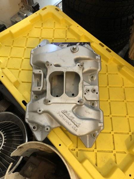

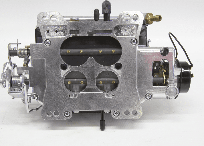

I already had a brand new 625 Street Demon carb, and I have since picked up a Performer 383 manifold. I will hold on to the Carter for now just in case. The wonky part is that it was installed on a 76 thermoquad manifold with an upside down adapter to fit the Carter. The extra inch of the adapter also messed up the hood clearance, so it was running a chopped up drop base air cleaner under the stock lid. The performer should be similar in height to the stock manifold, so the A/C brackets and a stock type air cleaner should fit.

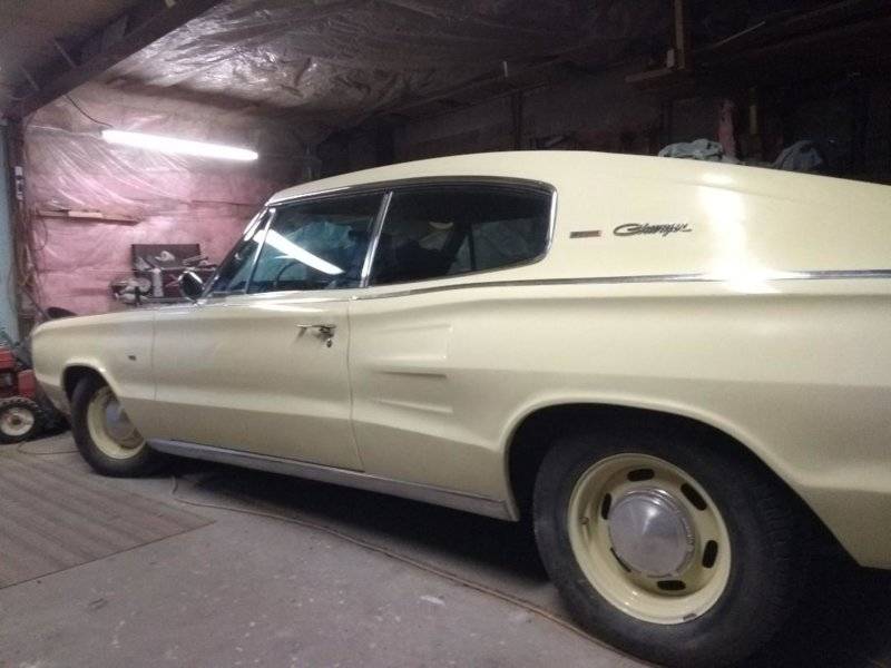

The master will be changed as I plan to convert to front discs at some point soon. I also plan to change all the belts and hoses, because the car was apparently restored about 20 years ago, and then sat for a long time. Currently debating whether to install the new tires and then try and drive it 5 1/2 hours home, or try and find a trailer.
