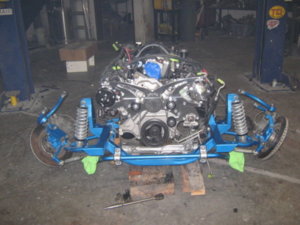

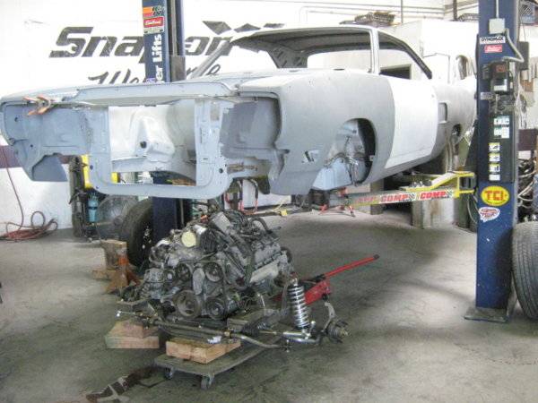

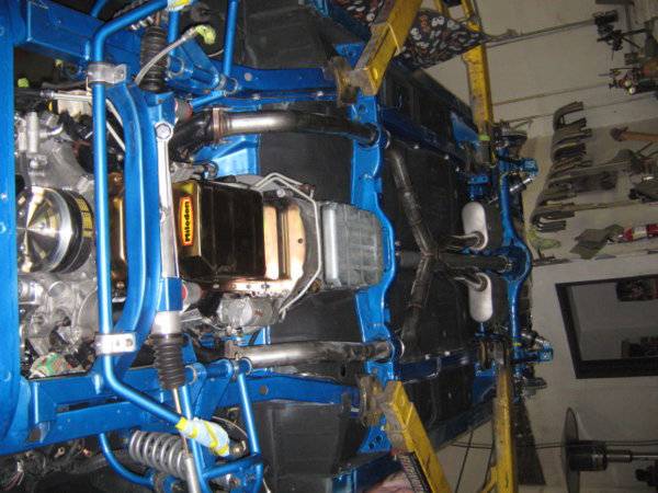

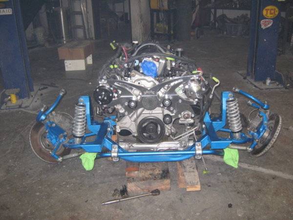

RC, I used an AlterKtion in my GTX with a 5.7. Ordered it with 5.7 motor mount placement. I bolted the engine to the AlterKtion, lowered the car on to it and bolted the unit into the stock k frame holes. Everything lined right up with ZERO modifications or adjustments. I have tortured that unit on many winding twisting roads as well as a 2 1/2 mile road course at Willow Springs in So Cal with absolutely ZERO issues. 12000 miles on it now. awesome product and I loved how easy it is to dial in to what was finally to my liking in terms of ride ht , ride comfort, and handling based on my preference.
Looks good! What transmission are you running & what needed to be done to the tunnel?
No experience with Magnum Force. In my neighborhood though. Guy with long hair has rock star status in Vegas etc. Contacted them by phone and tried to get on their calendar. Once determined that I am the lesser among us, it was about a year before they could even talk with me. Daily driver not their wheelhouse.

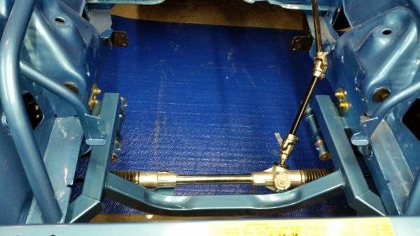

I have the NAG1 from an 07 Charger in there. I raised the tunnel appx5/8". If I had it to do over I would have cut both ends and the driver side and hinged it up so to speak then weld in a filler strip. I did that all the way around and while nice, didn't really need to do that much work to have it all fit well. You can see how we treated the cross member. there w2as some fab work req. for the transmission mount. Awesome set up in that car. has an 8 3/4 rear with 2:76 gear. 2000RPM@70MPH. It just wants to be at 80 on the hi way and that gets me 20mpg. Probably would get 22-24 if I could hold 65! The 4 link from RMS completes the suspension. Awesome cruiser, my idea of what "Pro Touring" is.

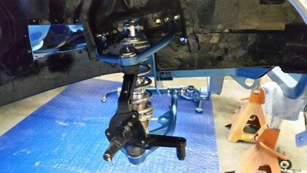

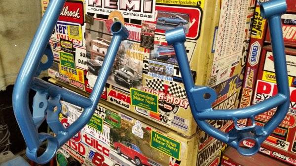

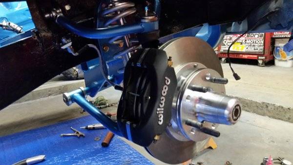

I went with the RMS under the front of my car after reading about all of the horror stories & seeing all of the defective pictures about the Magnum Force. Everything was all bolt in & fit perfectly. No complaints about the RMS from me. Mine is for a 2ND Gen Hemi though & not a 3RD Gen.

See I don't even like that bottom A Arm mount lol... dang thing should have an ear on both sides of the lower control arm bushings? Only having an attachment on one side of the bushing means the A Arm itself and the bolt have to resist deflection meaning way more stress on those parts? I'm all for modernizing but simple things like that bother me.
