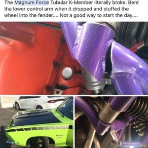

I could explain it but a picture is worth a thousand words ...
This is on a 71 Cuda, supposedly on the maiden voyage.
This is just one of several pictures of the magnums force stuff failing across the web. I've yet to find any such pictures of an RMS or HDK or Gerst failing...
