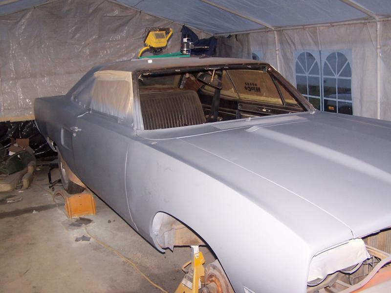

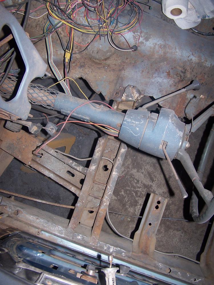

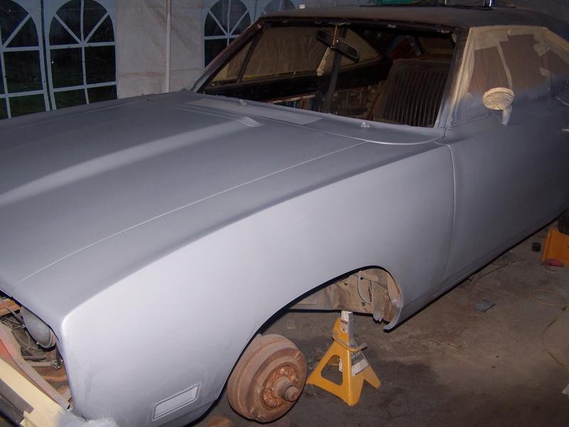

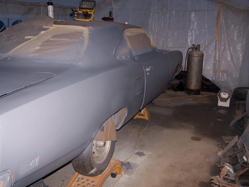

I still have plenty of work left before painting but the propane heat was causing oxidation on the bare metal at an exponential rate... I had to da the whole car with 80 to get the surface rust off before priming it. Thats 2 coats, it needs 1 or 2 more. At the same time I am ripping out the drivers floor and will do the same to the passenger side as well. Starting to think about exhaust now as well.. headers or not
I just had a birthday and realized I'm getting to old for this, I think the car is starting to sap my life's energy..... I think it looks better than when I started but its been such a tough battle I don't know what it looks like anymore.
I'll sit back and take a toll of things one day... and in the end I'm still not going to be 100% happy until those quarters are properly replaced

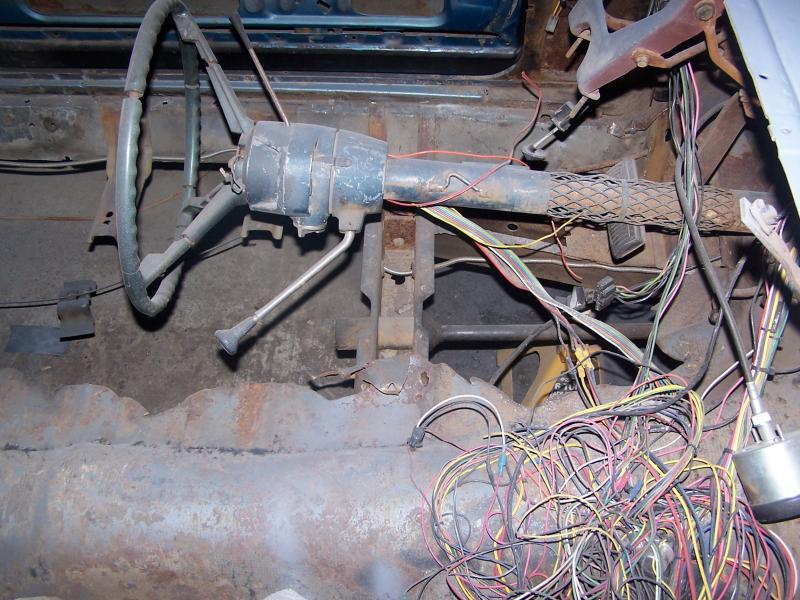

rusted frozen ebrake system removed as well... the cock pit has been completely gutted and started over..LOL

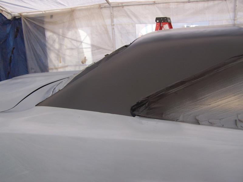

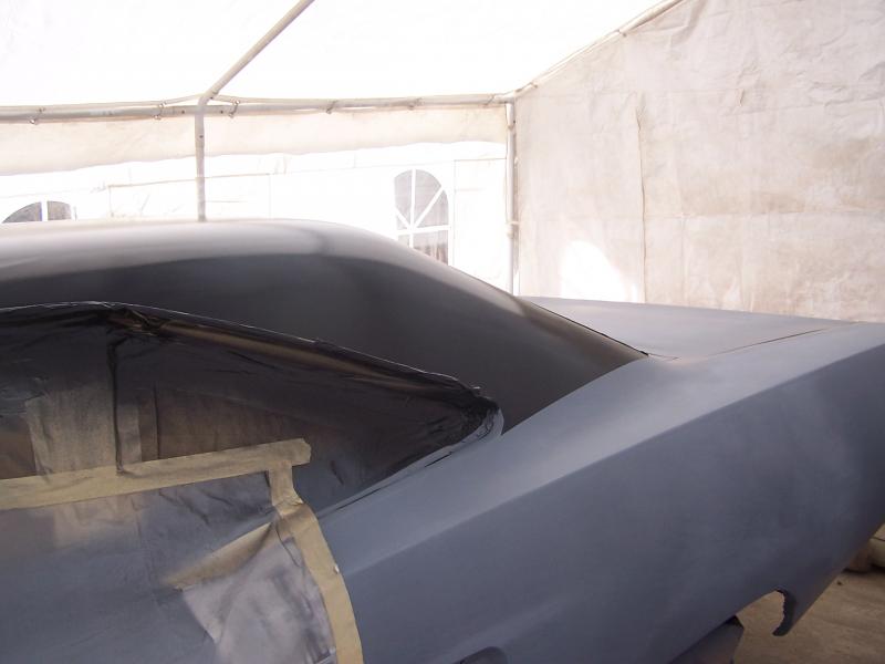

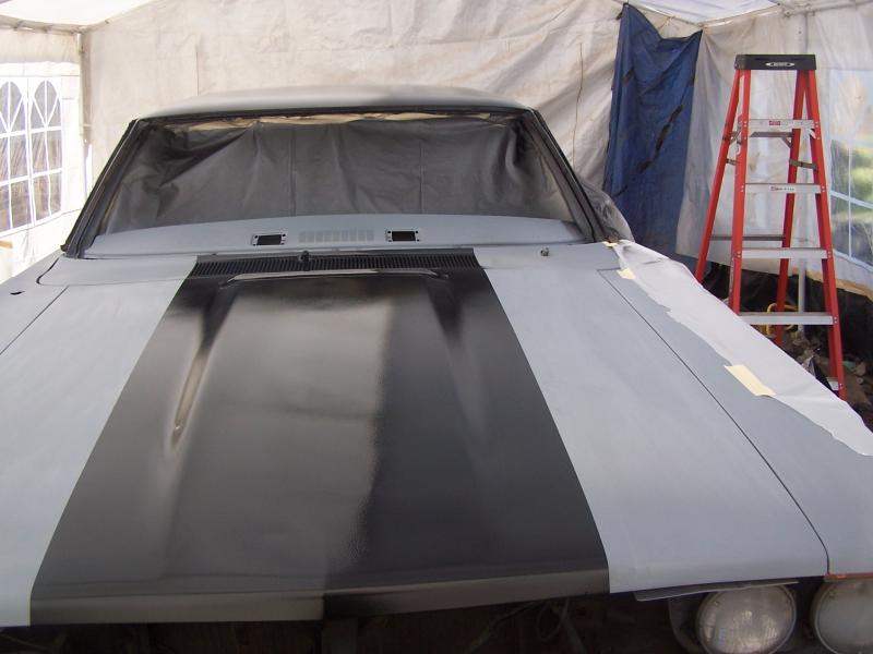

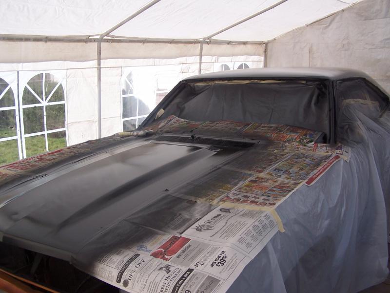

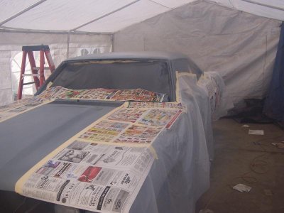

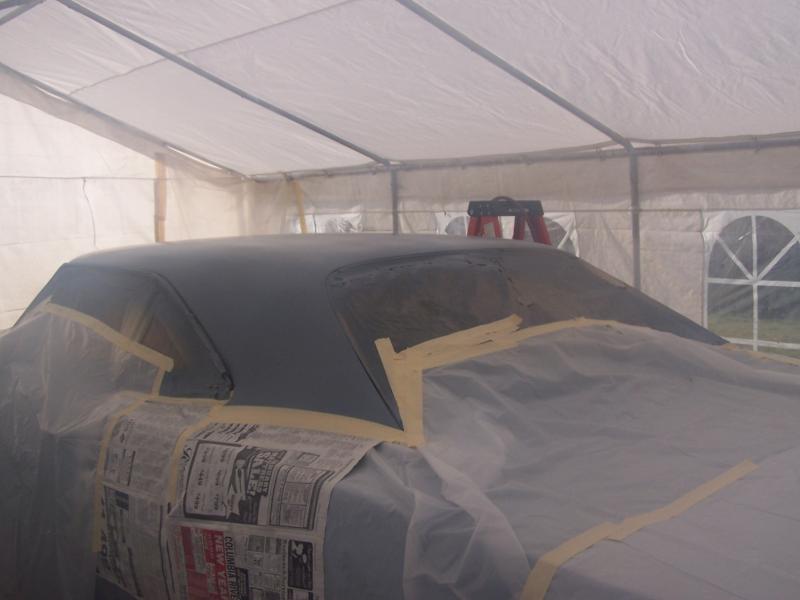

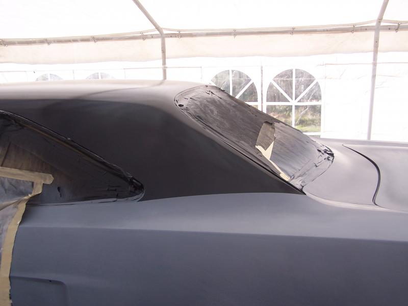

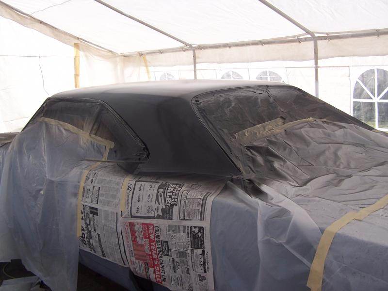

Shooting paint today.. going to do the roof and hood stripes first, then do the blue tomorrow..... its good enough for now, I think it might look better than I give it credit for but we'll see... anything is an improvement over what it was. I'll fiinish the interior as I go. Protect the rockers when I do the floors... LOL hoping to drive it Sunday..hahahahaha 1000 to 1 I make it...
scared I'm gonna suck painting it..LOL but that hasn't stopped me so far..hahahaha
LOL! Well, if you don't have a whole lot of experience painting, I can see why that would make a guy nervous..Get yourself some practice panels, even if you can only find some large chunks of carboard or wood. Get your spray pattern, correct needle and flow dialed in on that before you go laying it on the car...Definitely doesn't cover all the variables of painting, but at least you can get some confidence going starting there.
Take your time and figure out a flow in where you're gonna start and where you're going to end on painting it.
Best of luck to you....
P.S. make sure you have regulated, clean, oil free, dry air......Even a air/oil filter, small dessicant filter and a toss out Whirlwind filter at the gun will make a huge difference vs. just a run of the mill air/oil/reg filter.... Clean the surface well with a decent paint prep/cleaner and don't forget the tac cloths...
A man much smarter than me once said .... " It is what it is"

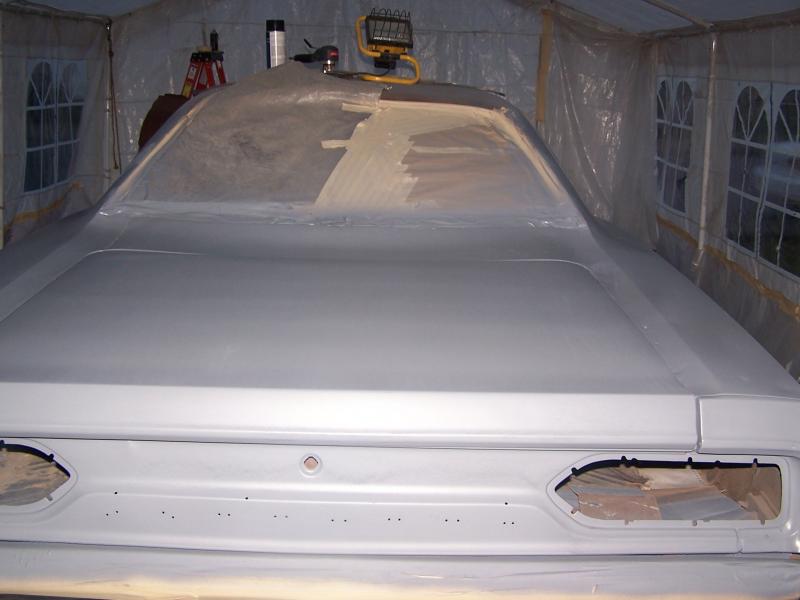

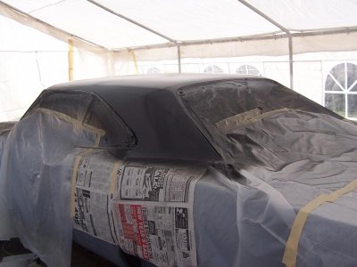

Knowing a vinyl roof is going on I wasnt so worried about matching the lines up and I guessed where the trim would be... LOL I'm sure that will haunt me later...
Blue goes on tomorrow after the black hardens a bit so I can tape over it without effing it up

actualy didnt come out that bad, I'm giddy about squirting the blue tomorrow..LOL
Cant wait, I think it will be decent enough. I hit the car with 400 grit paper one more time to make sure we got some smoothness to work with..
