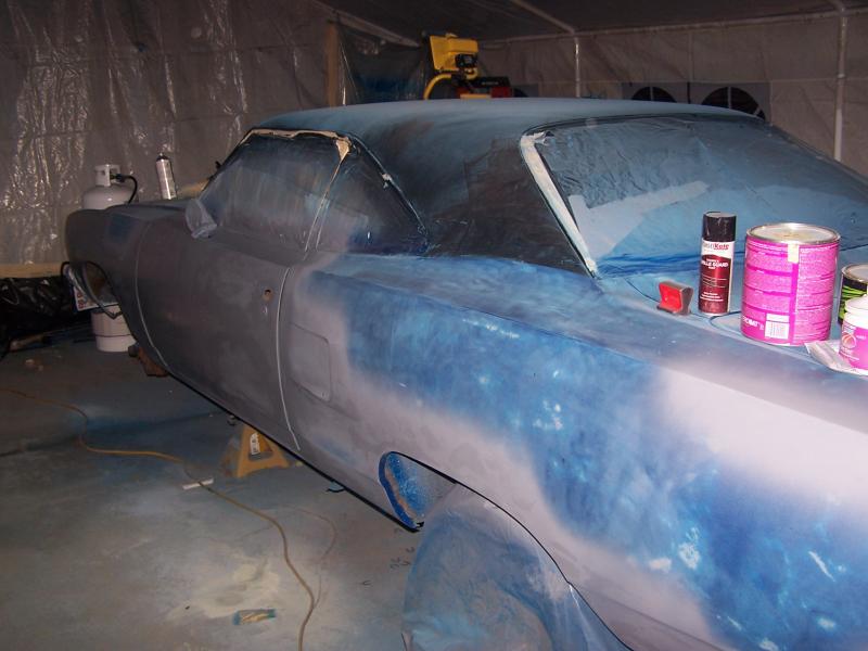

OK just got off the phone with them....
Two things but probably mostly more of one thing...
the HVLP gun I am using and my misunderstanding of pressure...
the 1.5 tip should have been used but in order to have 10 psi at re cap I should have had 30 at the inlet.... I was using 10 at the inlet... I never got enough paint out to give it a chance to lay flat in the first place and then the cold drying temp didnt help matters... SO...
going to sand it with 240 then 400... then respray with the correct tip and pressure. I need to let the paint cure as well before respraying so I've got a few days to work on other things as well taking my time sanding it... sucks.. had the primer on this thing nice and smooth.. I spent a lot of hours sanding it.... now I need to spend a lot more.....
needless to say I'm not happy about it... my fault as well, I knew something wasnt right and kept spraying because I had the paint mixed and in the gun and felt like I was past the point of no return and had to damn the torpedos and full speed ahead....
should have pulled the emergency abort cord and dumped the paint instead...
Thats a big lesson learned right there....
maybe odsvet is right, I'm a fckn idiot..:confused1:

If your gun is rated at 30 psi inlet, you don't want any less than that. Better to error a little on the high side. At worse you may get a little more overspray and you can turn the air valve down a little to compensate. Assuming your using urethane paint - urethane stops curing somewhere just below 60 deg F. Not only do you not want to spray below 60 deg - you need to maintain 60 deg for at least a day or more to be sure the paint chemically cures out. I recently painted a Cobra replica and spraying and curing around 65 deg - I had to wait a minimum of two days to start color sanding. The parts couldn't even be handled the following day w/o leaving fingerprints or tape marks in the surface. In warmer weather I could have started the day after.

Orange peel with all single stages? No....It's all in prep, enviroment, quality of the materials, equipment, air, gun settings and the person spraying it.
You have a lot of variables working against you. 1st off, not really much experience spraying and you're spraying a single stage with heavy metallic's (which cannot be heavily color sanded unless you want blotches-metallics settle). If you would have gone with a solid color and enough coats were applied, odds are you could have sanded/polished out some of the orange peel. Second, a enviroment that isn't controlled very well. As other folks mentioned, enviroment plays a huge part in the process. One of biggest issue's was 10 at the inlet and not the tip....

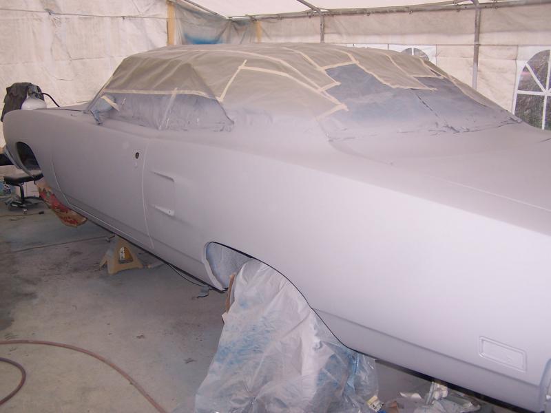

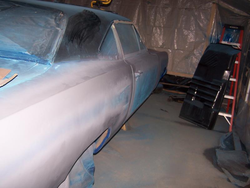

Ok got half the car buzzed down. Bought a new gun as well. Almost considering a better paint but its all coming back off so I dont think I should waste the money right now. But I like kandy and flake..LOL

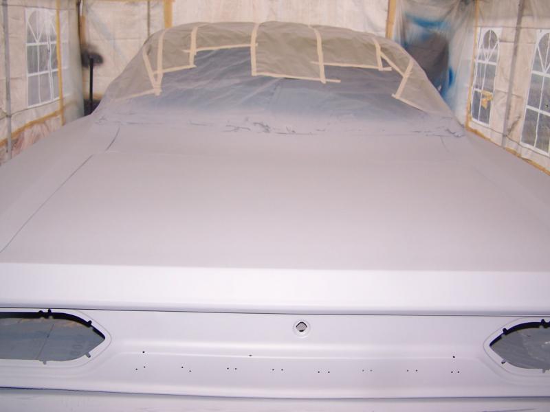

Quick uodate
most of the sanding is done, re-primed in a few spots did more body work...
bought a new gun and some new paint to use... Deltron .. custom mix steel blue metallic... have some sealer on the way as well.... have the passenger floor now as well to put it so really all the sheet metal will be done except for the quarters and we'll buy them one at a time when we can..
paint was a good deal from ebay but I called the guy and talked to him for a while as well... its legit DBU.. the DBC would cost about 320. but at least I know the paint will be good now and it was real cheap...LOL just one of those things you find .. he only had 2 gallons of it left.. Hope to paint it next week sometime .... :star_wars2:

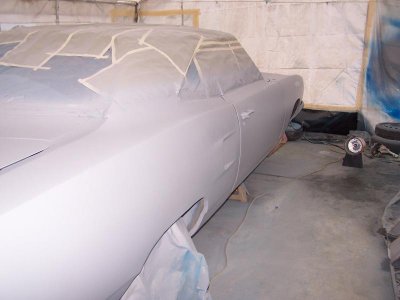

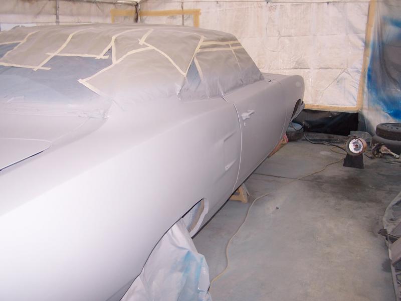

Just waiting for the new paint to arrive... round 2 coming up
