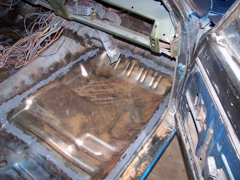

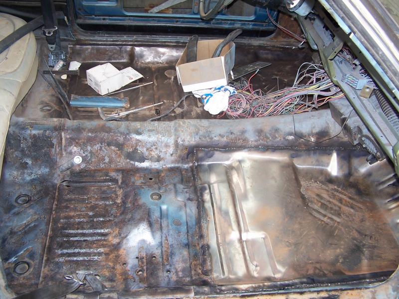

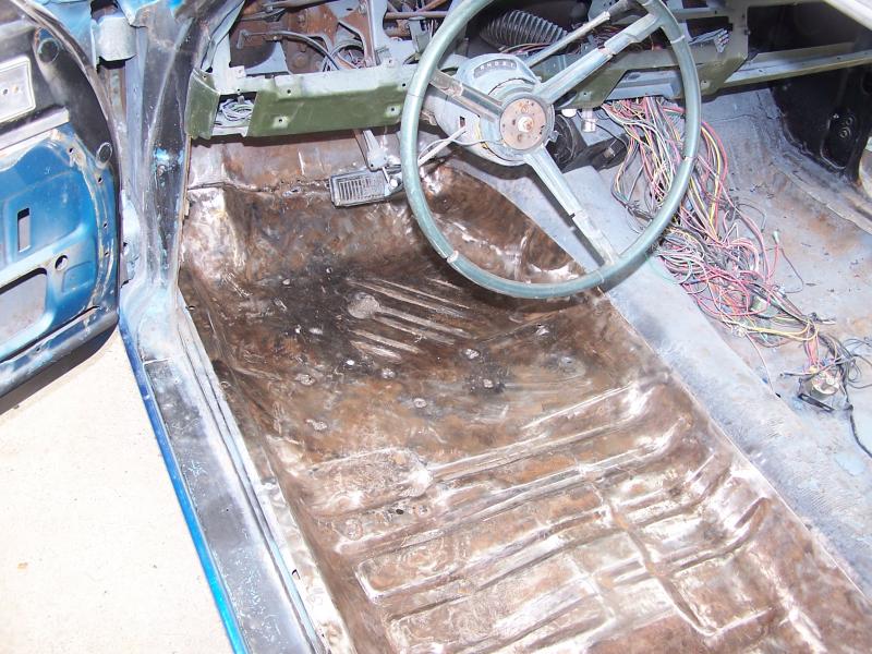

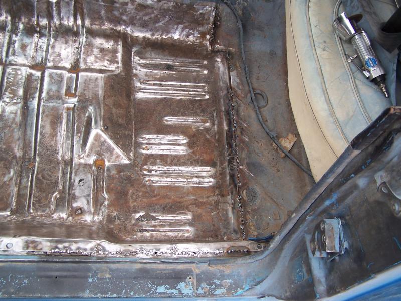

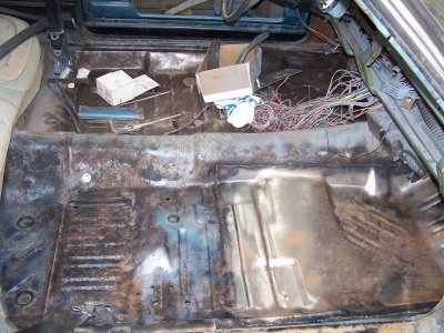

its not pretty but it is solid.. had to figure it out..LOL
I was using to much heat and not enough feed speed and buring some holes. Finally got it figured out and actually laid down a real bead once or twice. The automatic helmet works great but I cant see to good... I think I need a lighter glass shade, my eyes arent great to begin with.. But the drivers floor is in and solid. Still need to finish it up and use some seam sealer.. its ugly but effective. I'll get better at it. The 120v Eastwood mig 135 welder didnt have any issues at all. Just the person using it...LOL

99SS:
I've been following along with your process. I have to say that I'm impressed with your attitude, determination and success. The car is looking good!
To be 100% honest I just dont know what else to do... I just cant quit on it.. I would love to give up and admit defeat... I'm just to freaking stubborn ....old new englander thing.. the last thing you ever wanted to tell one of my uncles from Maine was you couldnt do it. Where there is a will there is a way ! ( just wish it wasnt me sometimes)

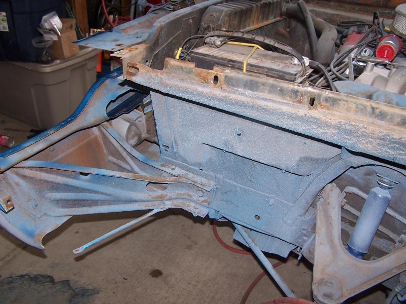

Ok cut the pass front floor out where it was bad and am going to weld in the panel in a few minutes. I also put the car up for sale on CL to see what interest it would bring, I could really use the money.. lost work and so I'm hurting for coin.. but I'm not giving it away either and dont know if it will sell anyway.. most people want a real RR OR GTX or Charger and a 4 speed to boot ...LOL

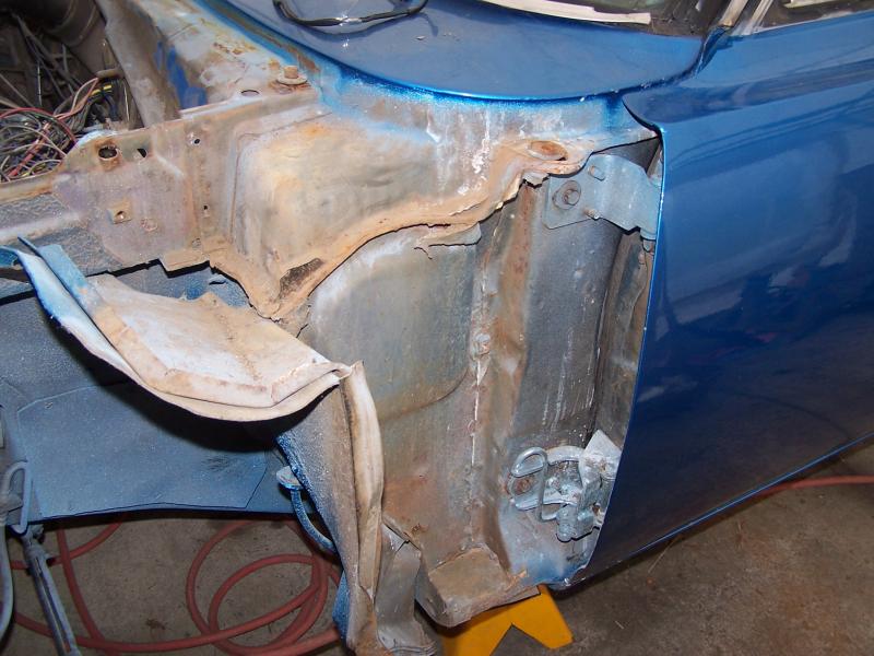

I need to take the fender off to align the drivers door ... does the bumper have to come off ?

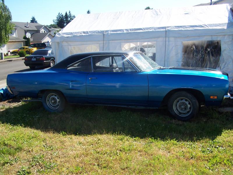

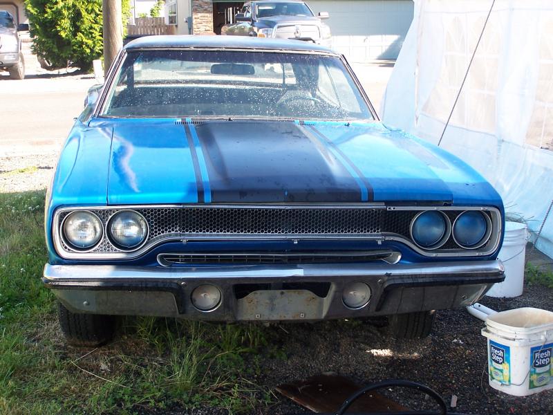

It needs a set of wheels !
i like the salt flat specials or the other wheels that came out that year but finding a set of them for decent money isnt easy and they dont take a bigger tire very well do they?
needs headlights to... LOL and the screws for the side view mirror, I have the chrome strip for the headlight.. needs one piece of the SS for the windshield and the grill isnt screwed in as I am re-paiting it .. it was faded and sand blasted from the miles of driving ..LOL

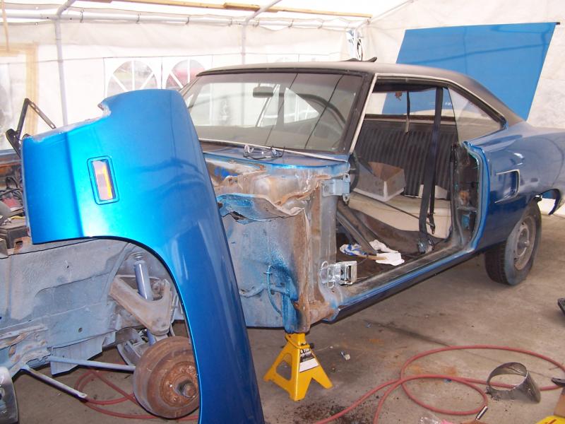

New Rookie Record !!

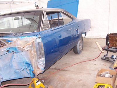

I think I just set a new rookie record for hanging a door/latch and striker :headbang:
Pics to follow .. took the fender off re-hung the door and mated op the latching mechanism.. maybe 4 hrs.. all solo of course..
damaged the paint a tiny bit in a couple spots but that gives me a chance top practice my touch up skills.
seam sealed the new floor patch and am going to paint the floor today as well.

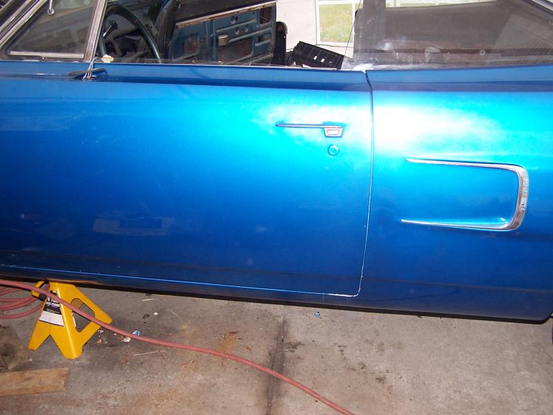

I see you went with the SS side scoop trim. Looks great, just the right amount of sparkle and shine against your blue paint.
I've managed to adjust my doors without having to remove the fender though. Was something in the way?
Couldnt reach the bolt thats on the outside of the car
So to hang the dooir... I loosened all the bolts and pushed the door into place where I wanted it. Used a piece of plywood under the door handle to wedge it into place while I held the door with one had and the air ratched with the other.. Wasnt easy....
Tightend all the bolts and it worked..LOL
The striker was a bit of a task as well. Just went slow and left the screws loose and close the door slowly and used a flashlight to see what was going on .. figured out the angle it needed and how much shimming and it closed sweet now.. I'm actually impressed with myself on how nice is opens and closes now. You can just push it close with minimal effort.. no slamming needed to get it to latch all the way... its awesome.. maybe like it came out of the factory almost...hahahaha
