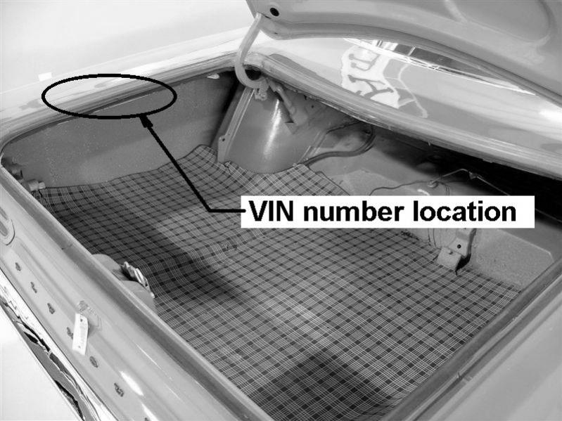

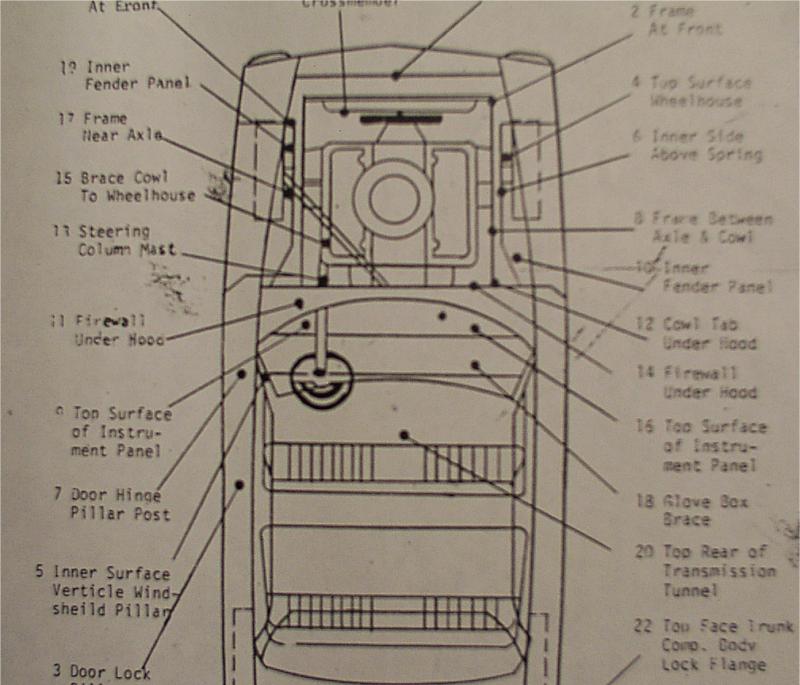

Here's a vin location chart, but somehow the trunk was cut off. 1969 and newer B bodies: Have it stamped on the driver's side trunk opening lip under the weather strip.
Thanks. Great diagram. The numbers match on tag, VIN and core support.

Rear deck where speakers could go.
While that is a valid location for some years and some models, on a 70 B body, the VIN is on the trunk rail like in the picture above.
