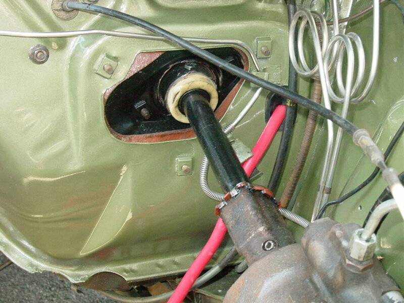

The gaskets don't leak if the header is flat. How many run a flat file over the gasket surface before install? Never had a pair that were perfect. Actually a flat file manifolds as well. Guess what? No gasket failures. To the oringinal poster. Trim the steering column tube close to the fire wall for extra clearance.

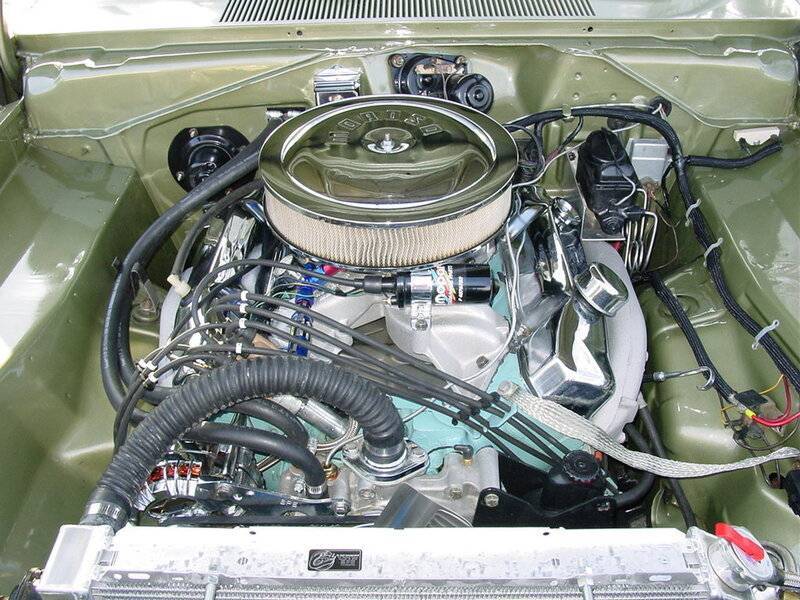

B Body HP manifolds work great. Just trim the outer column back and cut an access hole for #6 plug. This is a 440 using Schumacher mounts.
