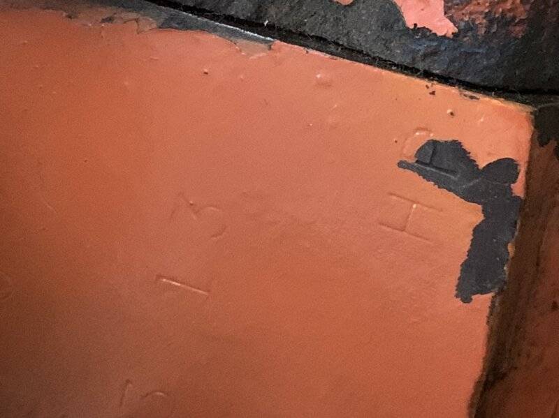

I own a 1969 383 Roadrunner. It was built at the Lynch Road assembly plant. I was told it was #s matching when I bought it several years ago.The block was cast on 2/24/69. The engine was assembled on 3/13. The car went into production on 3/15 (According to fender tag) All these dates seem to indicate the engine is matching #s to the car. My question is why would somebody re-stamp the vin on the engine block? (And not even do a good job) Any help with this would be greatly appreciated!

The numbers definitely match but I’m concerned about how the fonts are different (especially the “rounded 3”) and how it appears something was “erased” above the vin stamp. I just seems really odd.

Can you post a close up picture? Can see a whole lot in the one posted.

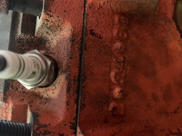

Look at the ID pad ( behind alternator), if it is anything other than E 383 HP, it's not the original. All the date castings, and assembly dates seem to point to a "born with" 383.

Edit, see you posted the ID pad, can't read it though. Scrape it down & repost if possible
The ID pad is stamped E 383 HP (the correct font, spacing, size etc) Notice the “3” has a flat top -as it should.
It’s definitely a true 383 HP motor
I just can’t get past that the last 6 digits of the vin that are stamped on the block are legitimate. The spacing, font, size, double stamping, etc don’t appear correct. Notice the “3” has a rounded top .It also appears that whatever used to be above the last 6 digits of the vin has been “Erased”.

Your pictures still aren’t good. You need straight on photo with way better light.

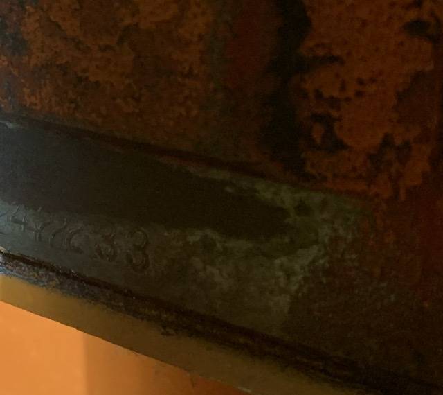

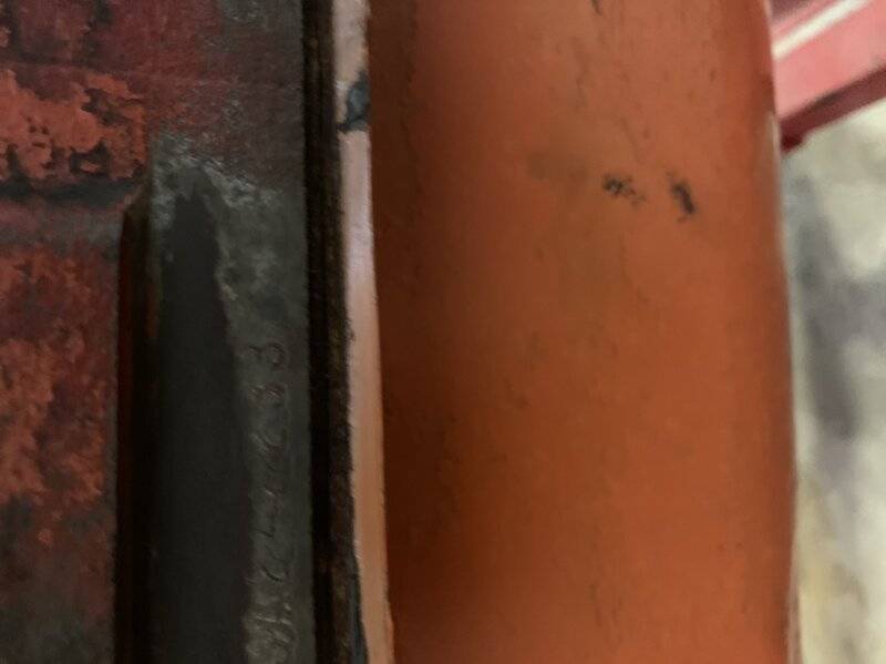

Only other number you can check is a 10k day date stamp down on the oil pan rail at the rear of the engine. If that date lines up and the stamps look good then your only concern should be the VIN stamp.
Can't "erase" a stamped number. Can only grind the metal off. This will leave an obvious dip on the block surface.

There are ways to "raise" a number that has been ground off. Heat and/or acid are the most common methods.The block would need to be removed to do it.
If there are number stamped on the transmission, compare the font.
If you cant get a quality photo, maybe a pencil rubbing, will help.

I probably should have used a different word instead of “erased”! It doesn’t really look(or feel)like it was ground off. It appears more like some sort of chemical was used. Sorry for the poor quality of the pics!
