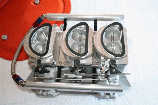

One of the ModMan intakes has injector bosses, so that intake, along with the Promax modded Holley carbs I've already invested in, would be my starting point if I changed from the intake I have and I wouldn't have to buy yet another intake if I switched to a 3x2 F&B TBI/Direct Port Injection system.
At appx $600 for the ModMan intake and $150 for the 3x2bbl top. (That's in the ballpark, I'd have to call Indy to get the correct total). Change the top to accommodate the TBI/DPI F&B system and those go anywhere from 1,500 to over 2,000 CFM. I couldn't bring myself to just toss (sell) the Promax modded Holley carbs without running them first, but the TBI/DPI F&B sure is fine!
$2,650 for the F&B complete setup, I think that is 2,300 CFM, but then I have to add a controller, so that is around another $2k?
