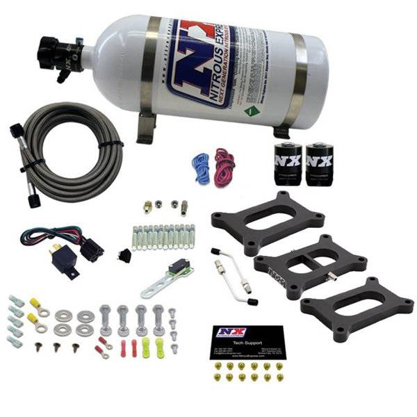

Nitrous Express makes a Holley 3x2bbl 2 spacer/1 spray plate nitrous oxide system. NOS used to make one, but it was reversed, with the outboard carbs having the spray plates, and the center carb being a spacer, and some have made their own triple spray plate setup for the 6bbl.
So it's been done, and still is in the case of Nitrous Express.
https://www.nitrousexpress.com/holley-2-bbl-tri-power-3-plates-gasoline-50-300hp-30026.asp
I've already got the spray plate, and it's a perfect fit.
My question is how much better is a system like that with a single plane 6bbl intake vs the dual plane Edelbrock/Chrysler 6bbl intake? That could have an impact on whether I choose TrickFlow 240s or 270s.
Thanks!

The system I show is rated for 50-300, so 150-200 if applied with appropriate safeguards and used occasionally may not be such a bad thing??

Based on our chat when I ordered the one 2bbl spray plate, they would probably prefer the one "150" HP center carb plate only, for velocity of the nitrous and fuel to be delivered reliably. My understanding from that conversation was if you go too low in desired output vs the inherent range of the hardware, the delivery can get sketchy by not atomizing as well as it should.

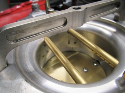

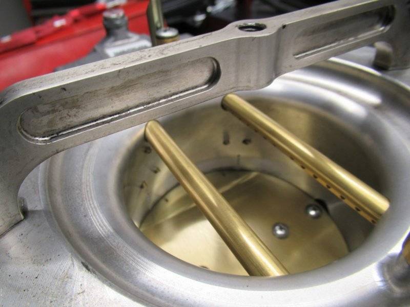

I will be adding nitrous as well but just for it's intercooling ability. I will lower my IAT by over 100*. Also thinkin 1 or 2 fogger nozzles into my 1 inch spacer under the cars. I bought a pair of spray bar plates but the throttle blade hits them. So it's parimeter plates or fogger nozles into the spacers..............:BangHead:

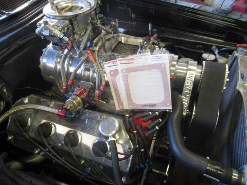

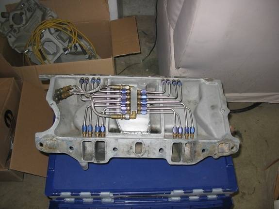

Actually I have a picture of what I believe is the factory aluminum 6bbl intake plumbed in a similar manner.
I was told at Carlisle, albeit a few years ago, that the guy who had a booth there could hook me up with the guy who founded NOS, and he would make a custom wet nitrous injection system for me using my intake.
Sweet looking setup but unless you are able to hide the rest of the system why worry if everyone can see it. Would not want to pull intake off all the time. Just my two cents. Have a great Thanksgiving
Van you change jets without removing the inatke!! Big difference!
