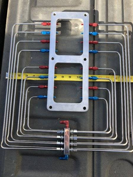

I either have to buy 2 parimeter plates @$350 each or put fogger nozzles in the carb spacer plate.The inner cooler will be placed right under the blower correct. If this is the case consider running your fuel line also in the inner cooler to drop that temp down. Next question do they make a ceramic piston yet.
Yes, I didn't think a dual plane intake would play well with nitrous.If I was spraying on a factory 6 pac manifold my tool kit would include floor dry, broom, and a dustpan.
So the nitrous and fuel spray plate is below the rotors of the supercharger.@HEMI-ITIS
Al, I just bought the blower nitrous system.FYI, the it comes with 175HP jets and a PSI gauge on the tank.

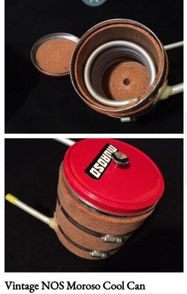

I remember them. Especially being in the hot, humid, swampy south! At least the elevation is at sea level...Back in the day we had the fuel line spiraled in a can then put ice in it to try and cool the gas down it's the same process
