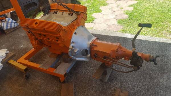

This color is what I was told by Bob Mazzolini
20170430_092802.jpg 20170430_092652.jpg 20170430_092725 (1).jpg 20170506_135419.jpg 20170513_100057.jpg

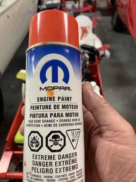

I use the Mopar Performance paint, and don't have any problems with it. It covers well, and dries fast. I use 4 or 5 light coats so it won't run.
I was told its the closest to the real thing as u could get

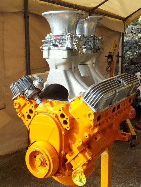

Got our paint from TOTALY AUTO in PA. for my dads 62 max wedge. Looks right to me. There is the race & street color. We got the street orange
I think mopar performance paint gets the job done or not seems to depend on the color. I have used both turquoise and street hemi orange and had no problems. The race hemi orange (very yellowish ) doesn't cover or last, at least thats been my experience.

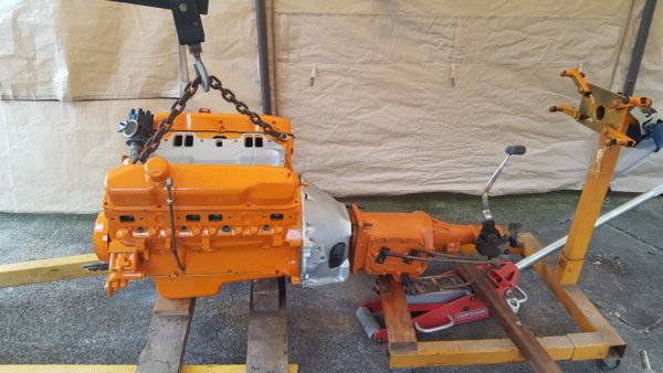

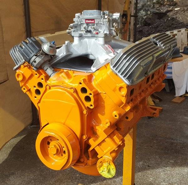

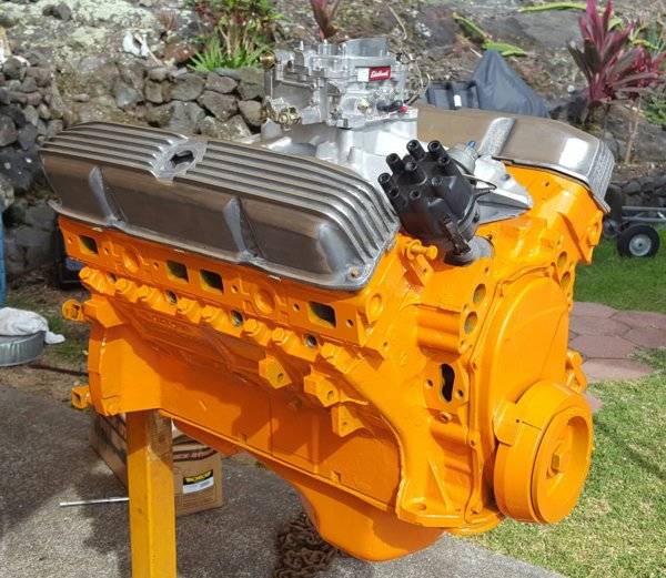

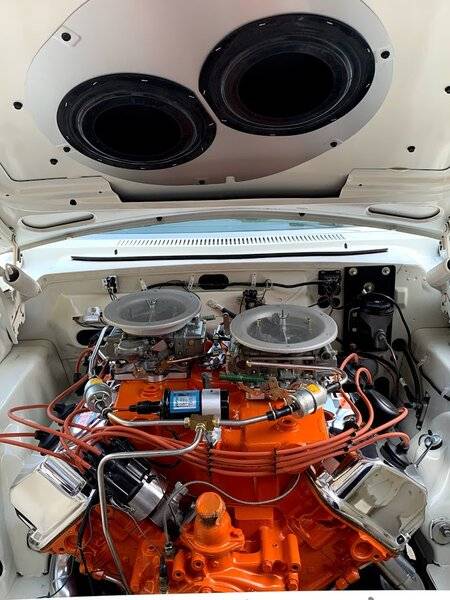

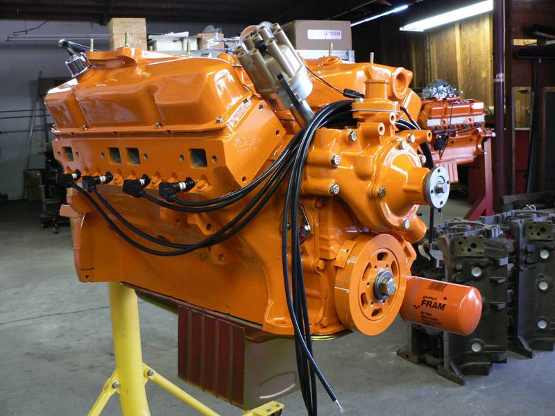

Anybody know what color this might be? I love the color just have not been able to match it up to this point. Omaha Orange is closest so far but it is not "yellow" enough. Race Hemi is too orange as well. Pictures are of my two Race Hemi's and my max wedge. Trying to match the Wedge paint. This is the Wedge.
Side by side. From what I can remember and from what my father remembers (he had an original Max Wedge in 62) the Wedge was definitely a different and more yellow orange brown color than even the Race Hemi.
The yellow-orange on your max is the same as mine, which was painted with mopar performance race hemi spray can. Your race hemis look like what i think of as street hemi orange.

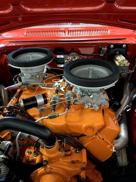

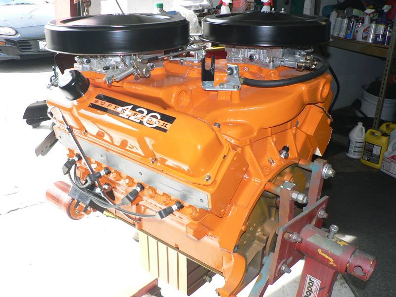

LOL! I know this is crazy, right?! Here is what I painted both Hemi's with. Mopar Race Hemi Orange which is much different than Street Hemi Orange, but yet not the same as both my Max Wedges. 63spf looks almost the same as my Max Wedges, I wonder what color he used? The Mystery continues.
