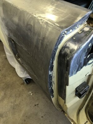

Hey guys what is your tip tricks tools etc. on removing paint from area’s that aren’t flat or that have a lot of mechanical details? For example see my shot below. Sandblasting not an option. I used Aircraft stripper in the 70’s and that stuff was good. Tried a few years ago and it looks like it had been neutered….
Also I have to do the floor which is very 3D.

Blasting is my last resort. I have a hydro last set up that would work great but I can’t push my car out to work on it as I have a sloped drive way. Also the engine is in. I am not sure I would ever get all the sand out of it as well it would be a fn mess. Een using flap discs and polycarbonate discs but the intricate area where yes sb would be great are the areas I need to have some efficiency with.

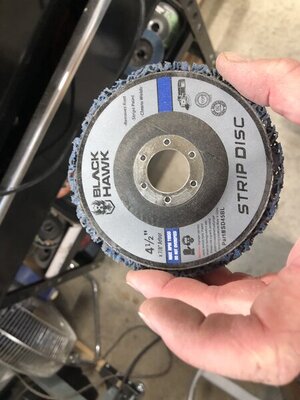

You want a crud wheel.
They're a real porus abrasive wheel. Hard to describe. But they get the paint+**** off without destroying the metal
Can you provide a link? I googled it and crud wheel is very generic.
this?
you could mask the car with heavy plastic and some quality tape, open up areas to blast and fire away
Yup been there done that. These are polycarbonates some with silicon carbide. The problem is these are dang stiff and will not bend into the area that I need. I need one that’s flexible.
