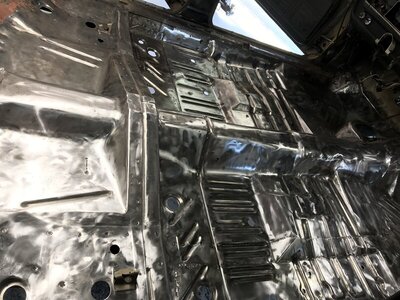

Wire wheeled this whole thing. I used a DeWalt 4" cutoff grinder with HF wire wheels both Cup wheels and Radial wheels plus some of the 3M nylon wheels. I did the detail work with small wire brush wheels and cup wheels in a drill. The trick with the drill is to find one that does 3000 RPM....not 1800 RPM. I found a cheap HF drill that did the trick. And as someone mentioned above....you can reverse the drill and the wire wheel acts like a new one again. Definitely wear a face shield and safety glasses if using the 4" cutoff grinder....and I wore welding gloves and a heavy shirt/coat. When those wires come off at the RPM's the cutoff wheels run at...they tend to want to stick into things.
Well done! I know how much work that was to do! Is the surface have enough tooth structure from a wire wheel? Normally epoxy needs a 180 grit or so for a good bite….??

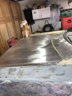

Well this thing is a beast. Doesn’t necessarily solve all my applications especially for this post but wow. 9A 15 mins used the weight of the unit on the trunk and curved surface. Used the crud drum wheel that comes with. For $19 I got the 2 year no questions asked HF warranty. Well worth $129 so far.

Using the new drum tool, a few wire wheels configurations, rowlocks.....I think you got it figured out!
The drum sander is hands down the easiest, most effective way to conquer the stripping task. Glad HF had the tool. Wait til you get to use it on someone's previous bondo escapade... it makes short work of it.
