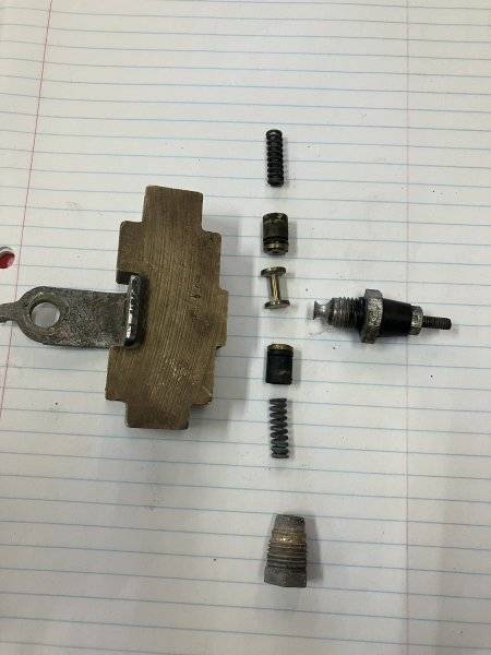

Vinegar is the most under rated acid / solvent in our hobby. I use it on everything. Mild but give it a little time and it works wonders. Go for it.The exploded view of the 68 and later A body 4 wheel drum distribution block:
From the bottom…
End cap
Tension spring
Collar
Shuttle valve. Warning switch to the right.
Collar
Tension spring

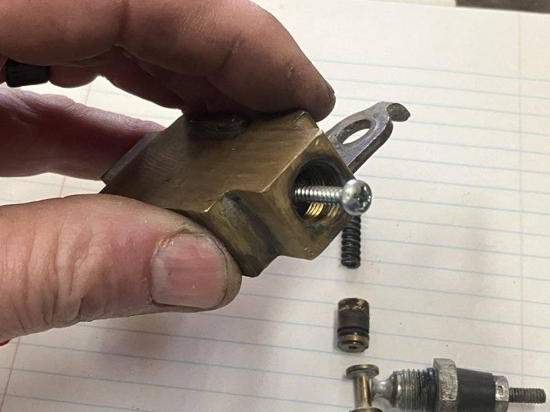

To get it apart, the end cap comes off. Some are 1/2”, some are other sizes.
The warning switch is 5/8”. It comes out. The lower spring should fall right out. The lower collar needs needle nose pliers. The rest had to be pushed from above.

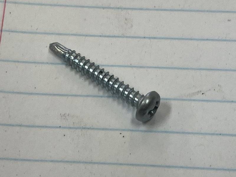

I used a #8 trim screw.
Threaded into the input passage at the top.
It pushed the top collar down enough to get leverage on the shuttle valve through the warning switch hole.

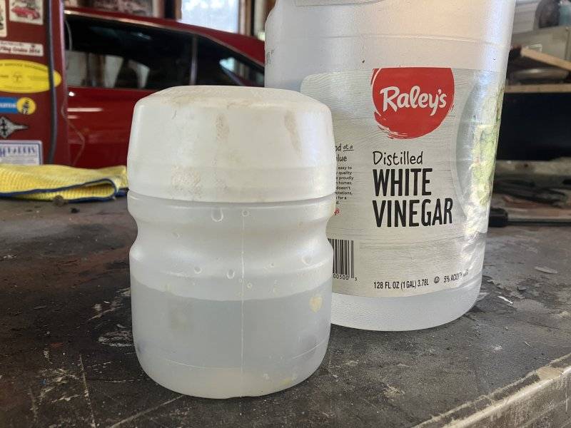

Now I need to soak this block in something.
Any suggestions?
I’m going to try this:
