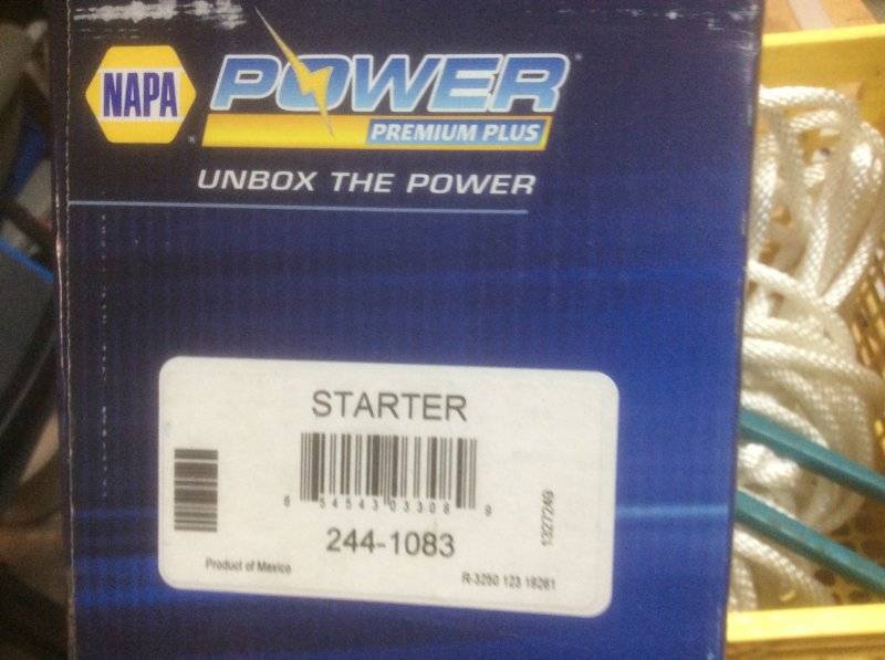

I got one from NAPA had to remove a cover and remove an extension for the wires. No big deal, just check main stud does hit block before connecting battery.
Yep, I got em on all my stuff! I;ve been using the Summit Racing ones, but as others said, the NAPA replacement is good too! Just watch the main stud on the block! ruffcut
