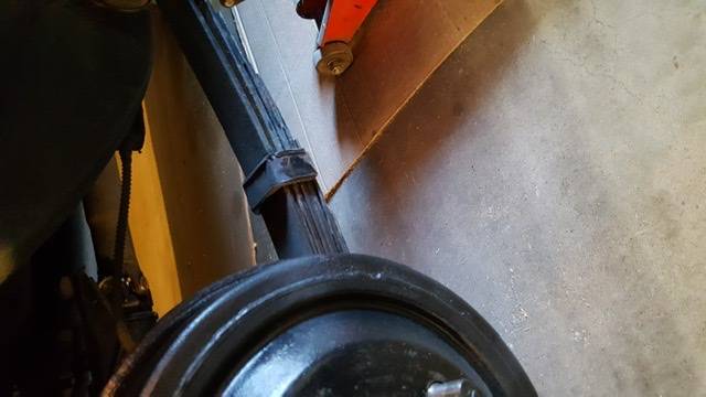

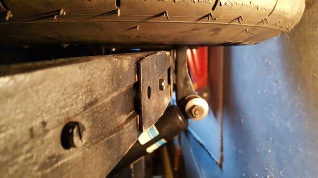

Here’s some shots of my ‘65 Coronet wagon. You can decide for yourself, and the wagon may have a different inner wheelhouse size, but here is how it lines up on the spring...wheel is 15x8.5” wide, 5.25” backspacing, tire is 285/60/15. It was a custom torq thrust wheel from my buddies super stock spring car, so he doesn’t have the same interference problem. I hit the front spring clamp, but the tire clears the spring itself by 1/4”:

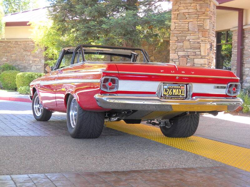

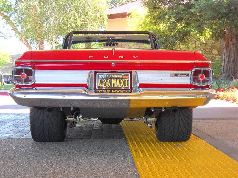

Chad, my 65 is mini tubbed and springs moved in. 315/60-15 on 10" wheels. Don't recall backspace; maybe 4.5". Custom narrowed width dana. 3" exhaust.

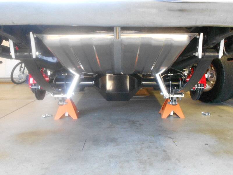

Mini tubbed to frame, springs moved in 3", Narrowed Moser fabbed 8.75" (48" flange to flange), 15"X12" Billet Specialties wheels with 5.5" back spacing. Mickey Thompson 29"X15.0R15LT Sportsman S/R Radial tires.

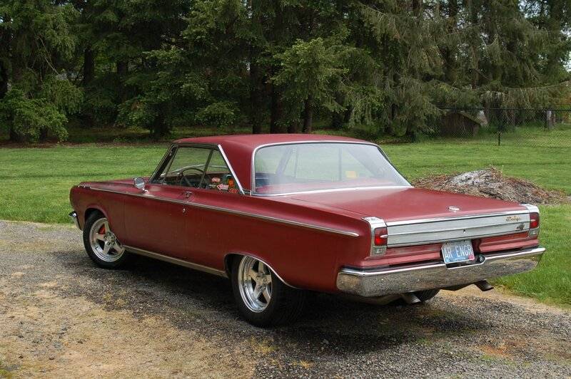

I mini-tubbed my '65 Coronet about 30 years ago and have run 325 or 315 tires every since. Plenty of room under there once you move the springs under the frame.

Are those 15 inch wheels? and what width?.. stock rear end width?
No, they are 17 inch wheels. I think they are 10 inches wide but I really don't remember. I bought them about 25 years ago. I was using a stock width Dana 60 from a '68 B body so the wheels had a fair amount of backspace in order to tuck the tires in. The wheels were custom made to provide the correct backspace.
