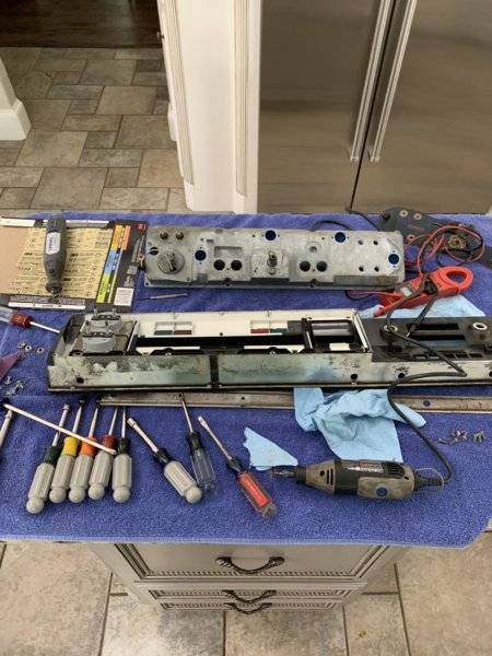

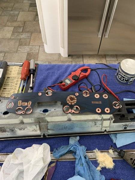

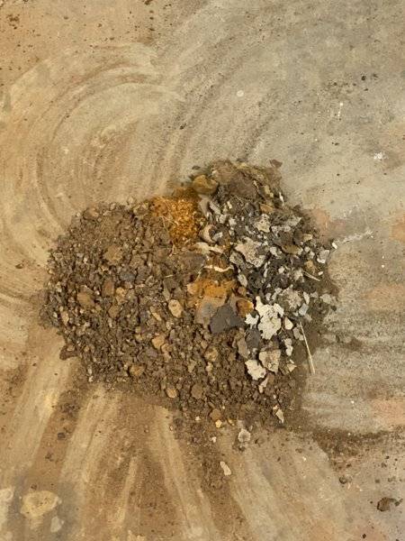

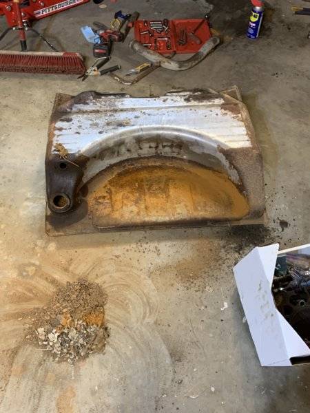

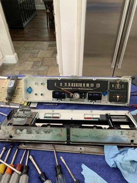

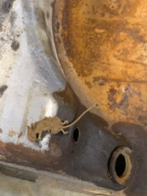

Started the process of dash clean up and gas tank assessment. Instrument cluster is cleaning up nicely, but the fuel system needs replacing. Tank was crusty but mostly whole. Found a mouse in there too....bonus
C2952D1B-FD4E-42D1-A63B-09D00D410694.jpeg 2C238C01-29D1-4916-A022-91CDF489FC50.jpeg CA16C02E-1BB3-481A-8864-9548205590BC.jpeg 7A778040-43E6-449E-AC91-91CD9ADB3986.jpeg E187BDB5-098E-4D03-972E-CAF56917A054.jpeg 1DD4247E-4B63-41DA-883E-80ADA30DEF1C.jpeg
I'll ad that normally I'd try to fix a tank with pretty much decent metal....but.....after wire brushing the rusted area....pinholes everywhere.....suck for sure.....but tanks are pretty inexpensive..and leaks are the opposite.

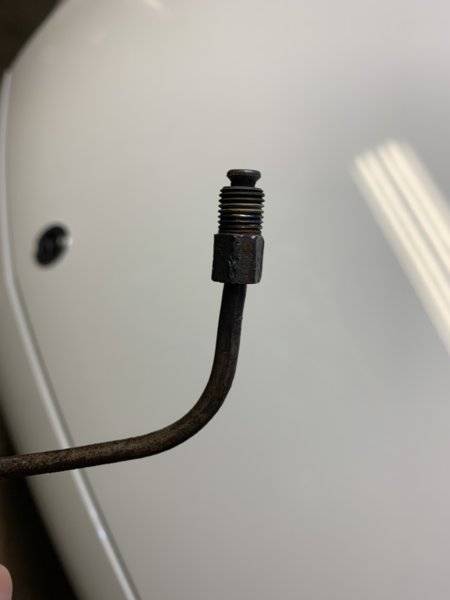

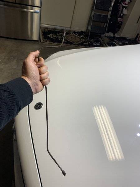

Been working on the brakes this week. Holy crap these lines are toasty. Flair nuts were not moving one micron. Took me hours to get the ear ones off without destroying the lines. Managed to take the Wheel cylinders off....and get the lines out to recondition them. Feels like restoring a ancient chariot. Toughest one I've ever taken on.

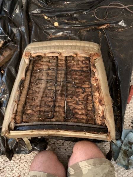

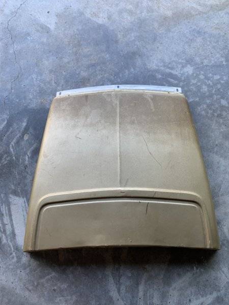

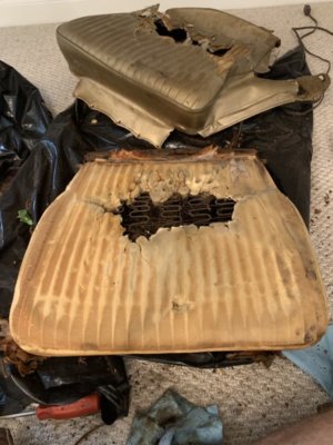

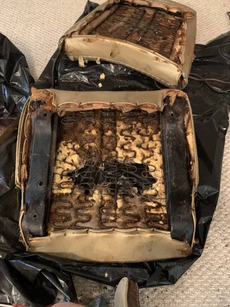

Woo wee, seats were roached out pretty bad....got my work cut out for me.
A5857034-ED7A-4C70-9E8B-E344A8EEFF93.jpeg C5106D4C-7C62-48A3-AE38-FAFF8A78D159.jpeg 2582FF0B-97A5-408D-AF66-0D60D89BBE10.jpeg
Those are not too bad to do.
MUCH easier than 70 and up backs.

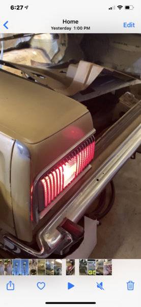

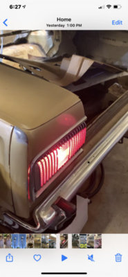

Getting through the harness and bringing power back to all the bits.
been 40 years since juice hit that light

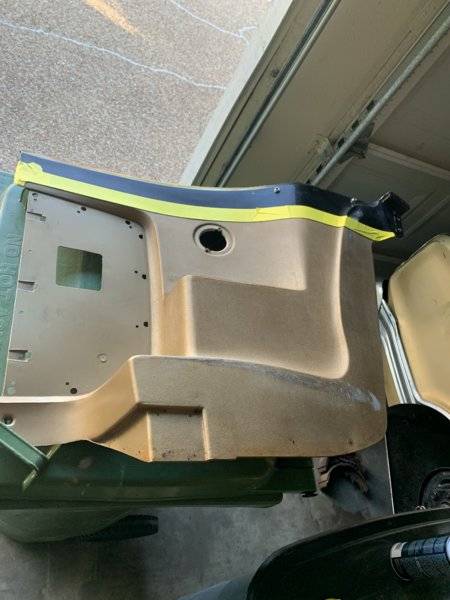

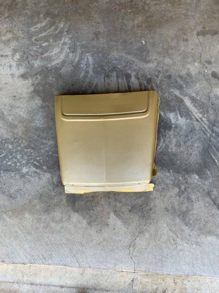

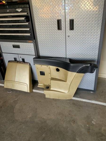

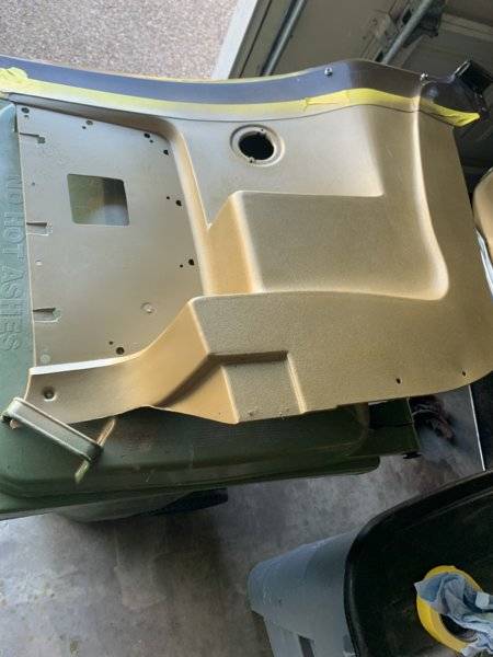

So many folks have asked about Herbs paints and if they look close to the initial paint . The gold is spot on.
18DDA7C1-103C-432C-9AA3-4D80FFE50252.jpeg 296FE06D-ECB1-4426-8362-BA6BE752BABC.jpeg
I’ll add this. When using the rattle can , wash the parts with Dawn and warm water. Adhesion promoter and a test patch
small, random spray pattern ..... do not blast this stuff on....it will pool and run quickly
