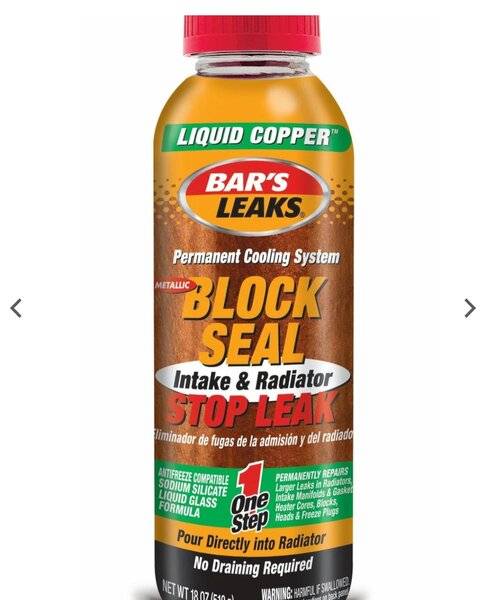

Hey guys so now I'm dealing with a very minor leak at the top of the radiator, upon further inspection I realized the radiator fluid should be chamged so I plan on draining it and refilling it. Has anyone tried this copper radiator stop leak stuff? Any suggestion ? And also how many gallons of radiator fluid would I need to refill jt after? I have a 64 chrysler newport 361 v8 5.9L
Find a radiator shop and get the leak repaired correctly by soldering it.
You couldn’t pay me to use that in my classic car. Potential problems coming your way.

First off the "new radiator" in a bottle.. dont bother. I wouldnt want that in my cooling system. The leak is only going to get worse but if its minor and you want to fix other things first just flush it until you can get it fixed at a radiator shop.
Second dont buy an aluminum radiator fix the stock one if its in good enough shape.

All of those Stop Leak products are just a band aid imo. Get it repaired correctly like stated above.

The best solution for the OP is get the leaking radiator professionally cleaned and repaired and pressure tested and leave the "snake oil products" to those who are searching for the unobtainable......just my opinion of course.
