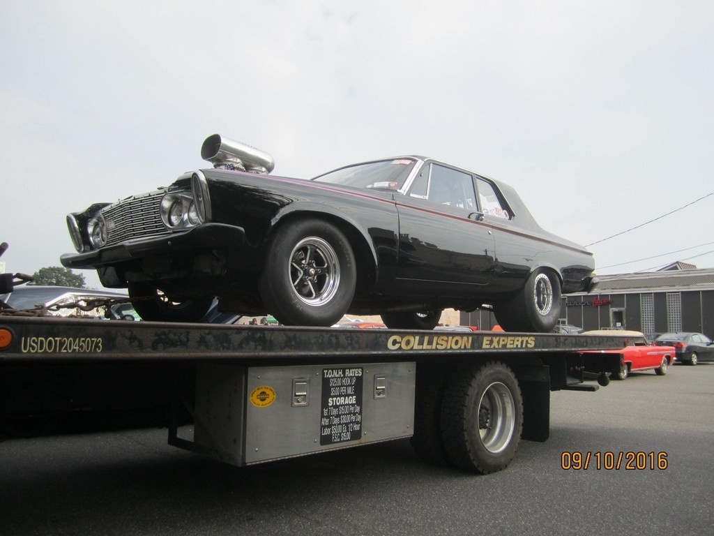

I alway heard that it normally does not work well.I am old skewl to E/t streets all the way around.
