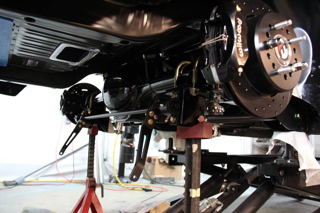

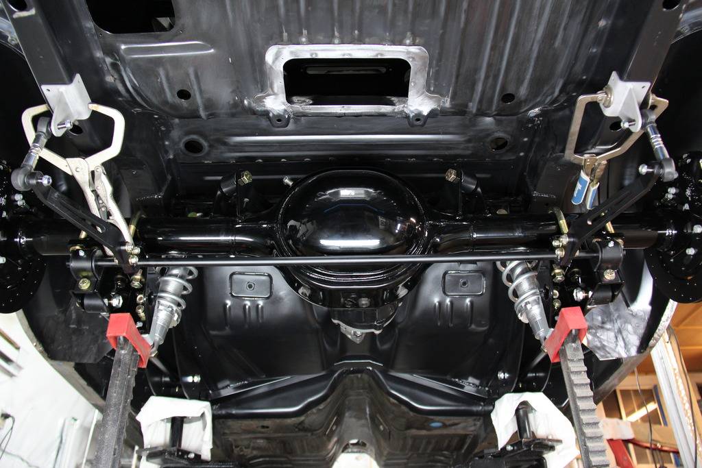

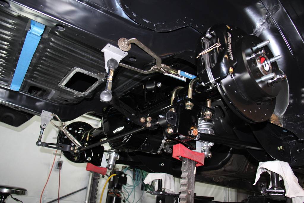

I received the new RMS rear sway bar kit today just in timebefore I bend the fuel lines. I will locate the sway bar mounts first, so I canroute the lines around them. This kit has been in the works for over a year andit was worth the wait! It is a great looking kit and very reasonably priced!
Thanks
Pat

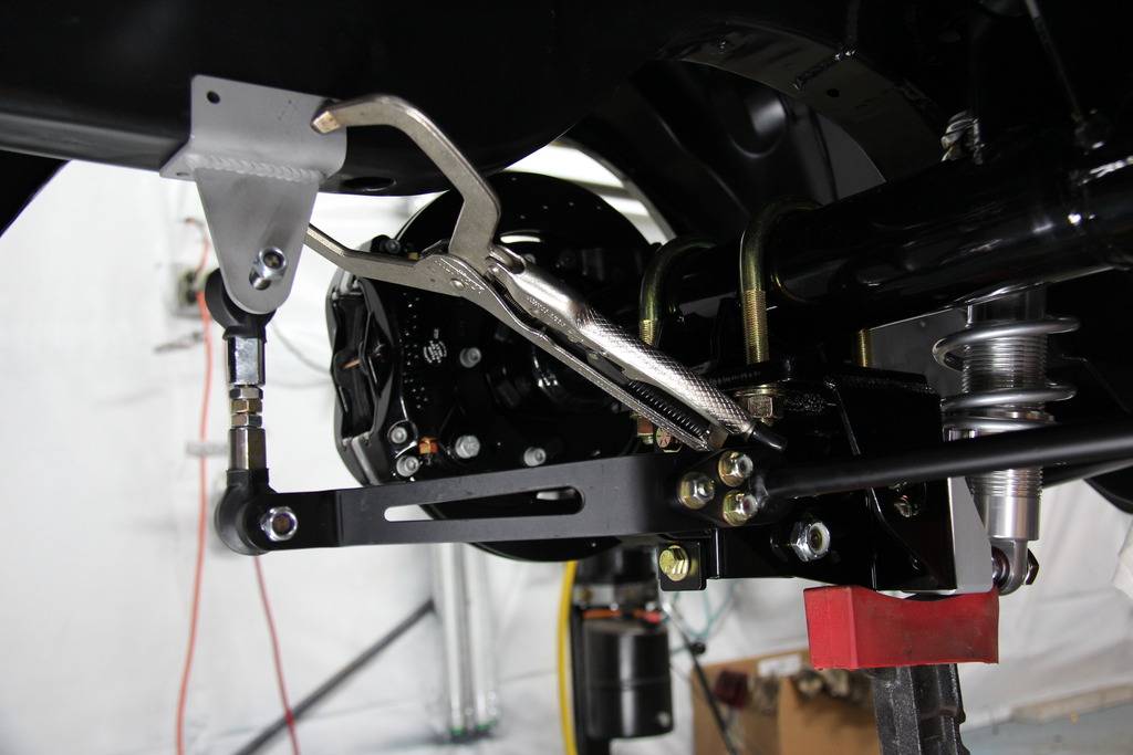

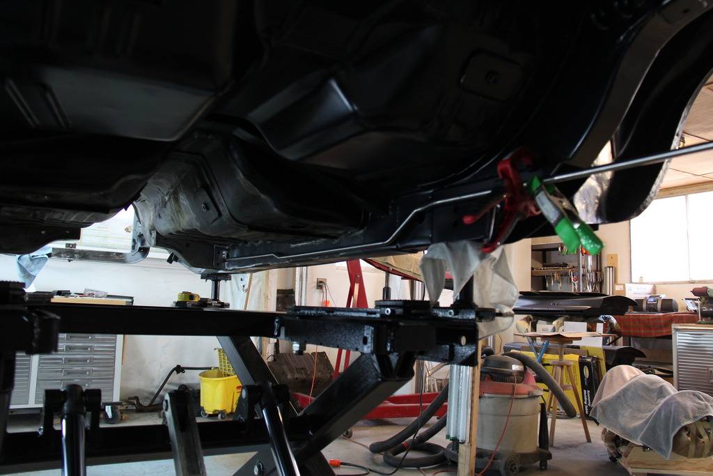

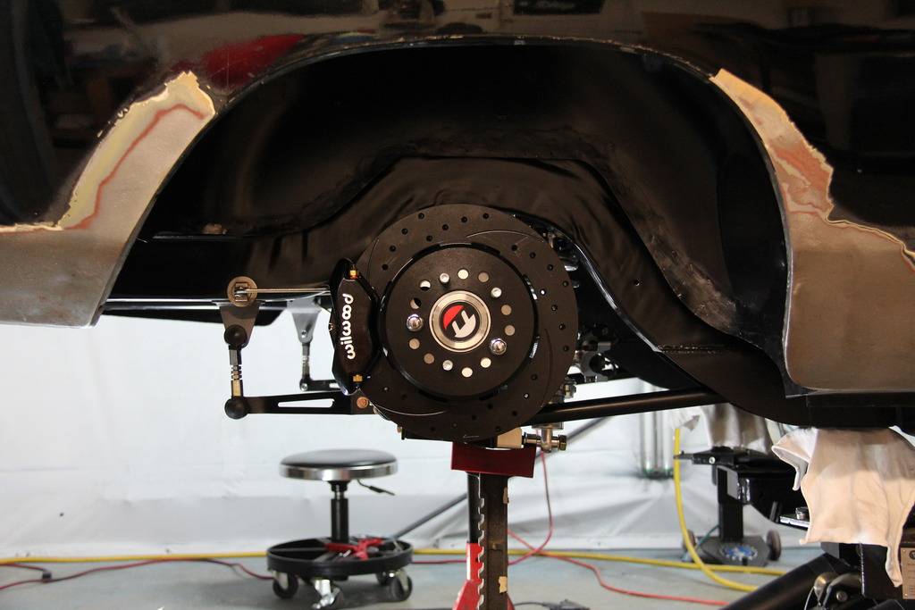

I put the rear back in the car so I could fit the new RMSsway bar. The sway bar kit fit great after I quickly figured out it is a rearmount system. All the RMS sway barprototypes I saw at Carlisle had front mounts. Bill said the kit will work withTTI 3” exhaust and it does look to have more than enough room.
Thanks
Pat

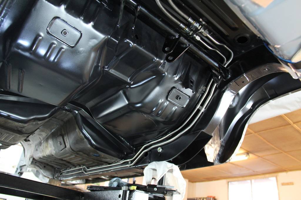

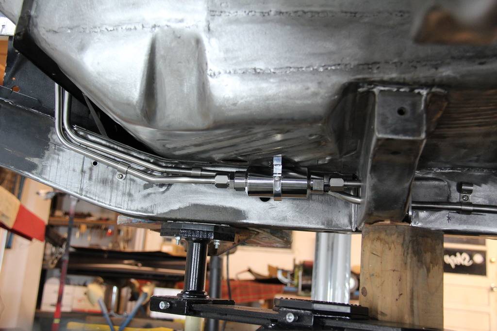

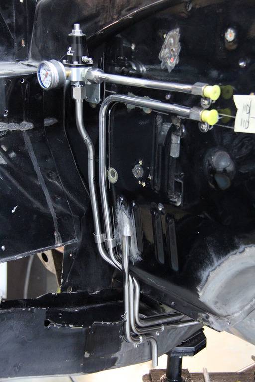

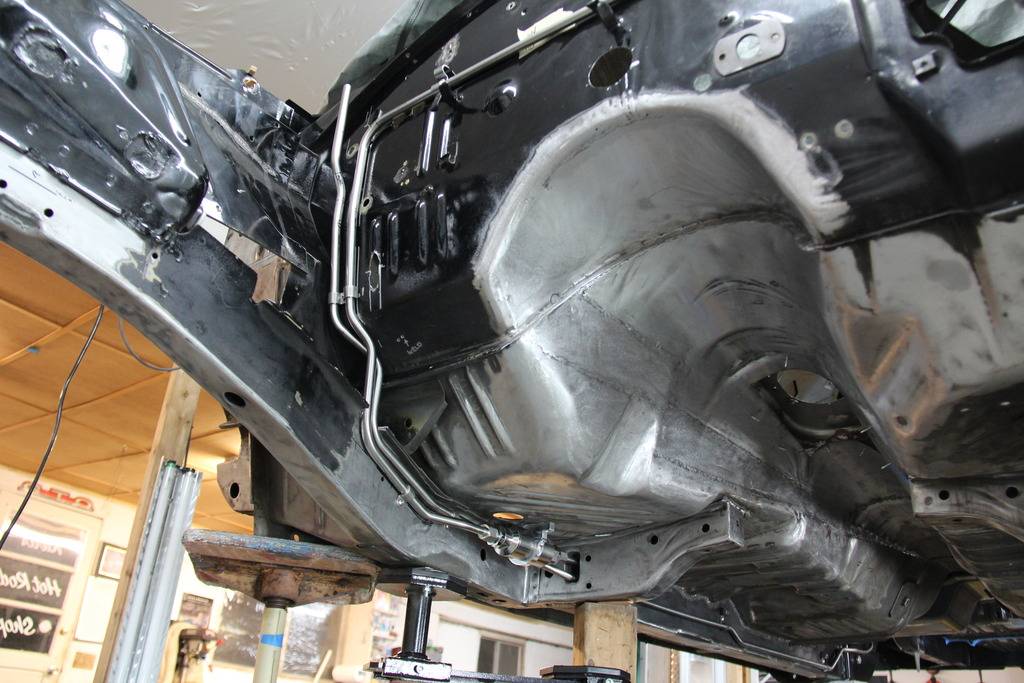

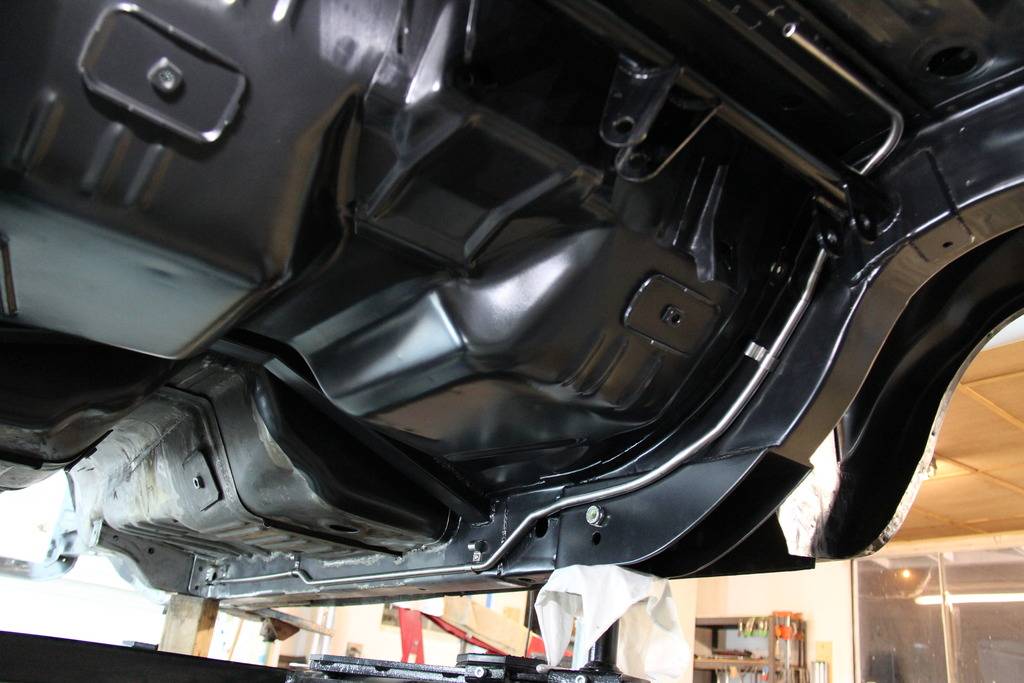

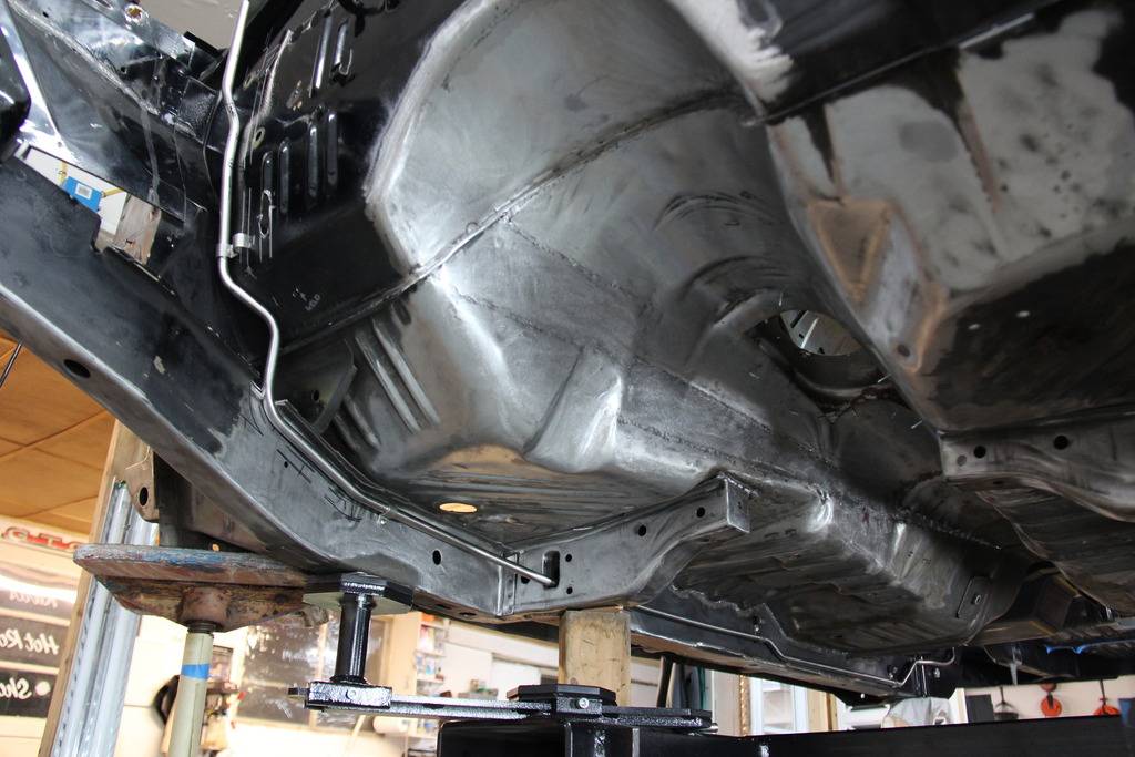

I almost finished the fuel lines this weekend. Just one S/S lineleft to make and a few hose.

Nice work! Is there one bend tool for all sizes of lines or one for each size? I'm gonna take my old fuel line out now, should I bend new lines after the old one or is it better to do it in place on the body?
The Parker benders I use, there is one tool for each size tubing. If you are going to make your new line in the same run as the original then order a new line from one of the suppliers. If you need two lines (2nd for the return) then I would not follow the original run.

Thanks, I'll check out that tool. Yes, I'm gonna run a return line also, would you run it much different from stock?

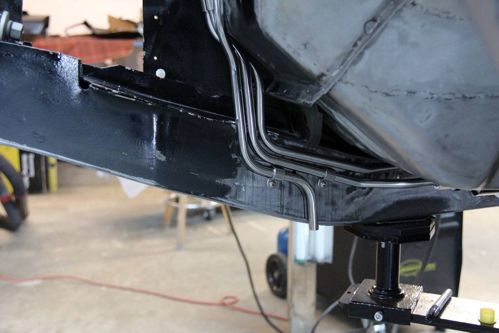

If you have frame connectors installed I would run both lines on the inside of the frame connectors
Yes, I do, good thinking, a much easier run than stock, I see how you did yours, I will do that, thanks!

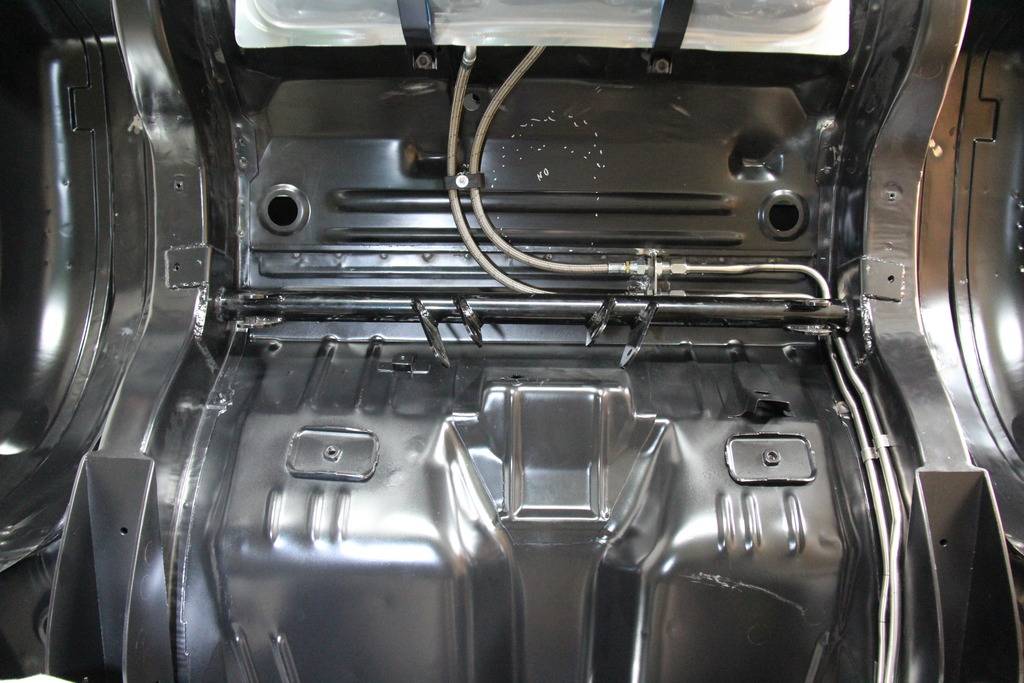

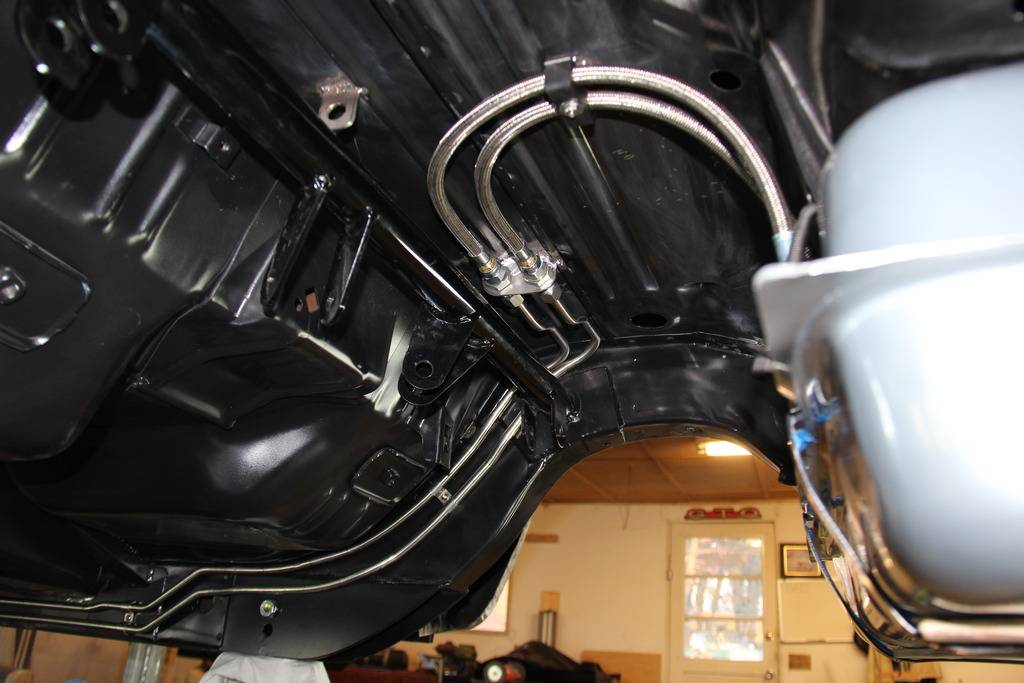

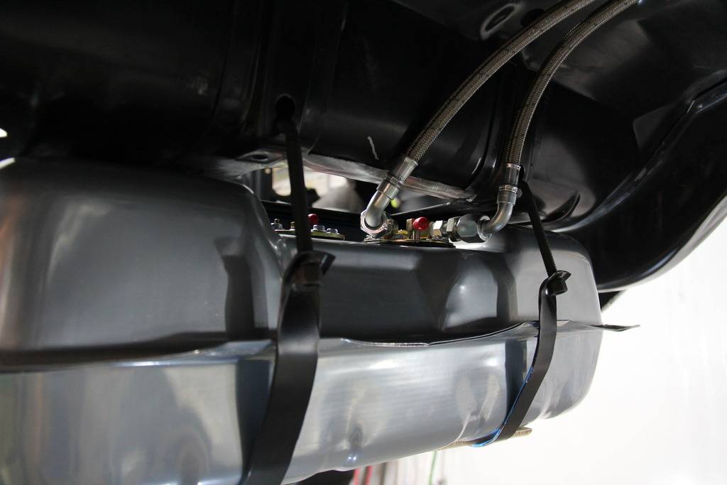

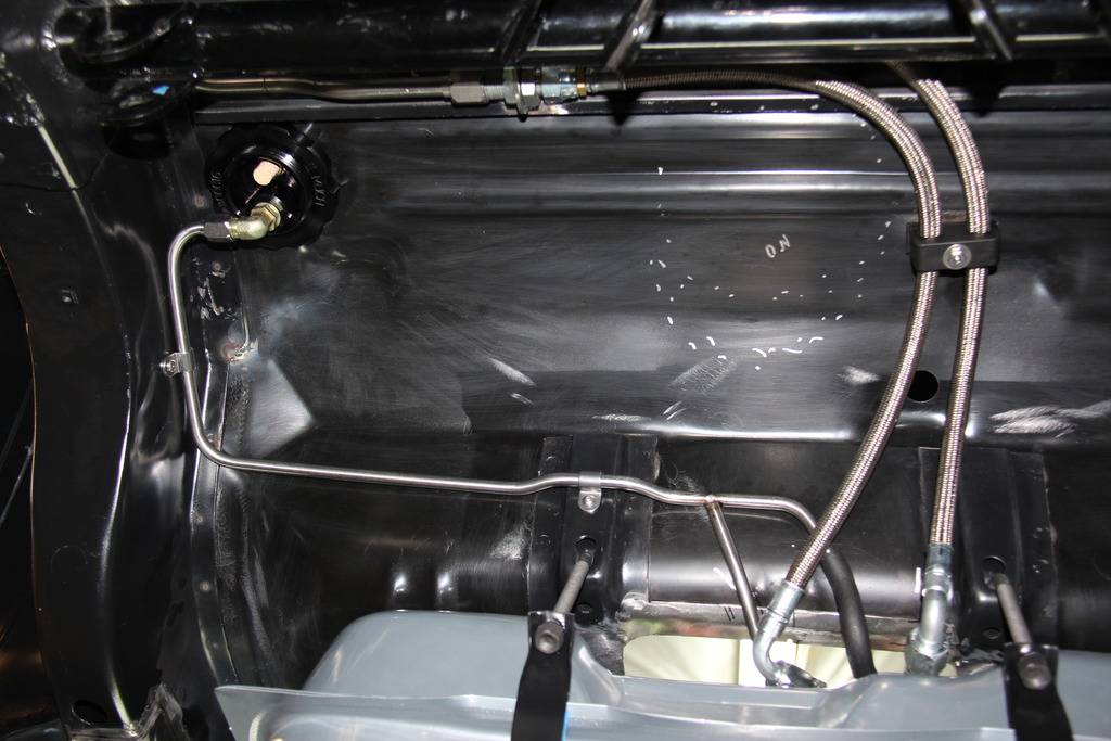

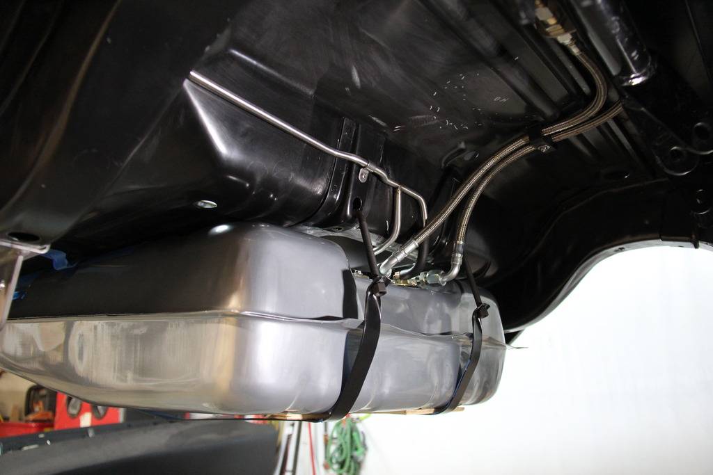

I finished the rear fuel lines and all that is left is the MuchII tank vent system.
Thanks
Pat

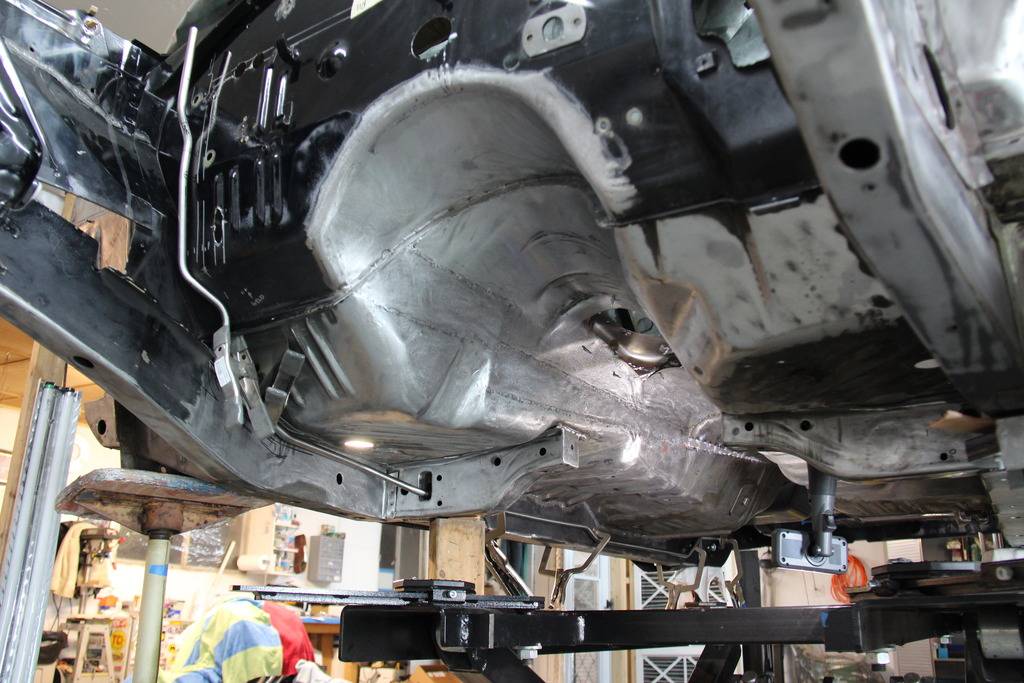

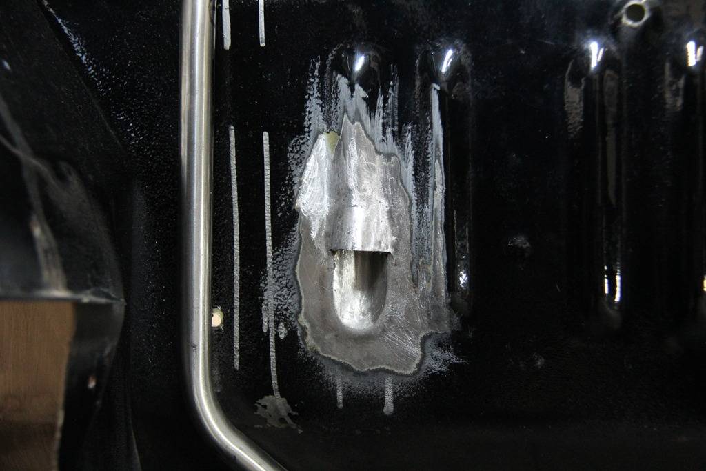

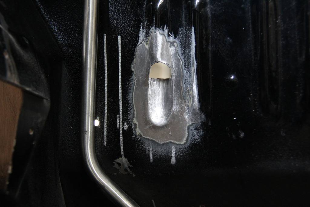

Before removing the fuel line I made an AC condensationdrain and fire wall pass-through.
Thanks
Pat

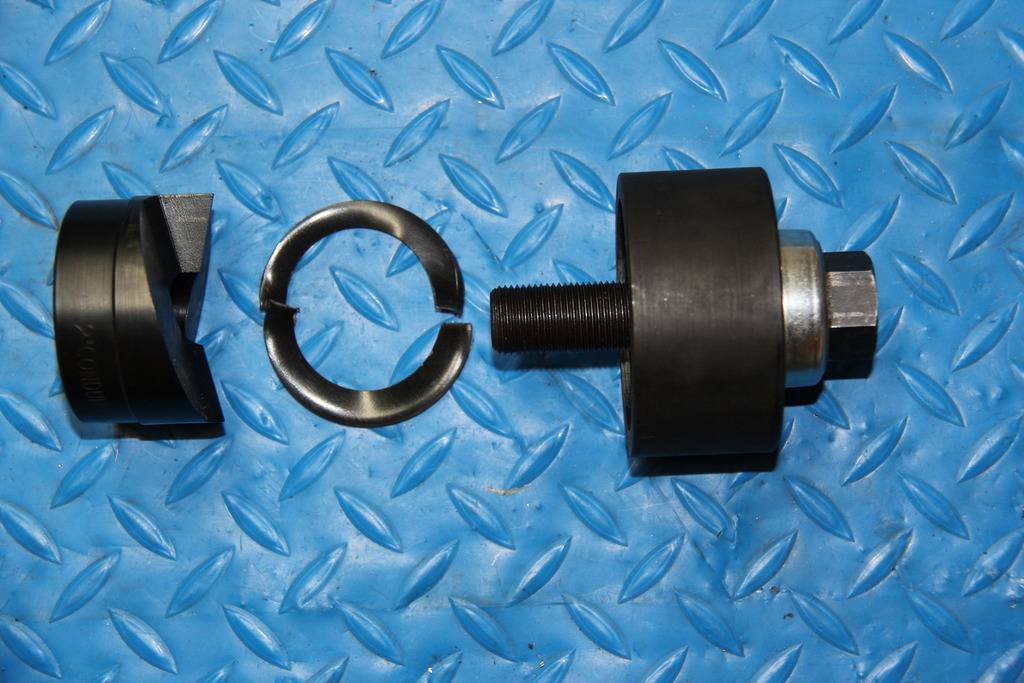

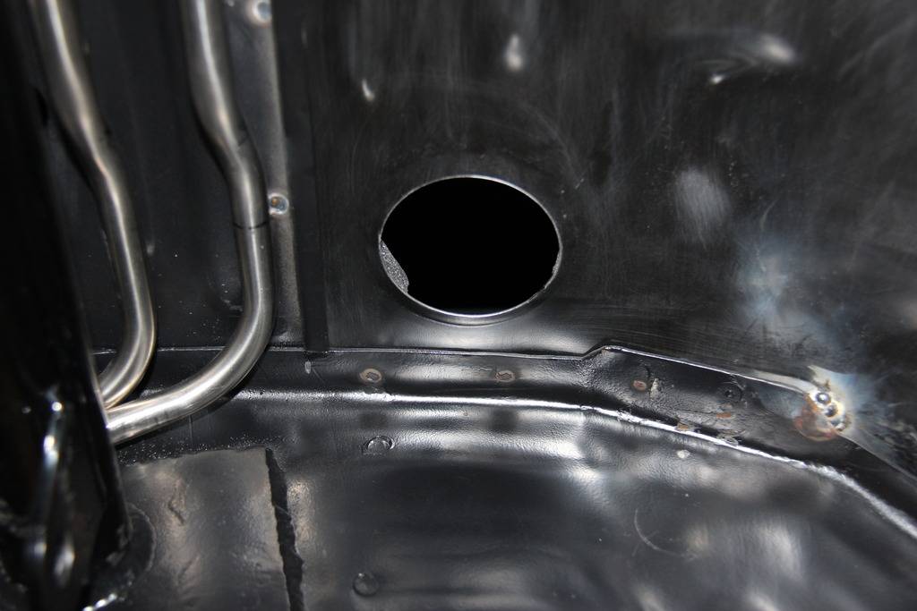

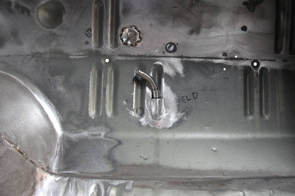

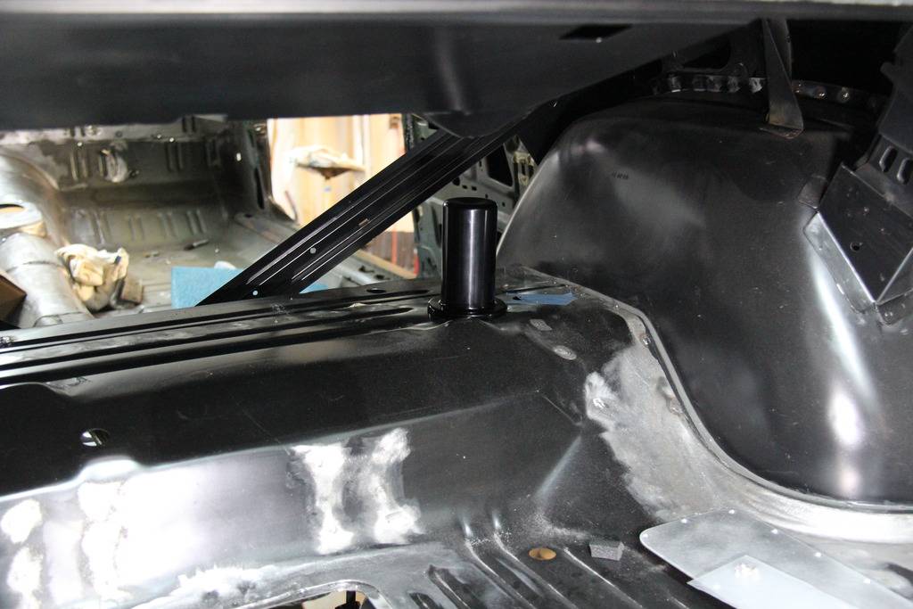

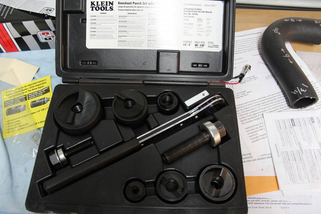

Installed the II Much vent canister, starting with punchingout a 2 ½” hole where there was a 1 ¾” body plug using a knockout punch tool. Thisis a clean way to put holes into steel panels. Then I bent a 3/8” S/S vent linerunning downhill to the two tank vent fittings. I step closer to starting thebodywork.
Thanks
Pat

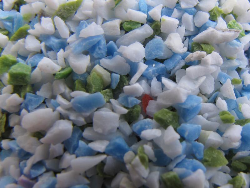

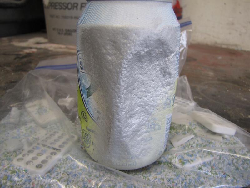

True on the Alterkation having been around for a few years time, still curious about my questions, but, Im sure the engineering is solid, just wondering. For media blasting, well, depends who is available in your neck of the woods! Look at this soda can, and study it, I can tell you're a clever fellow, the pattern of blast on the can is indicitive of the process you should want for your car. You can tell there is larger and heavier media particles impacting the thin aluminum, and the paint coming off the can. I did this, and took this picture too. This is from Plastic, with a varied size mixture of medias -- which I've found works the best. IMG_1678.jpgIMG_4565.jpg
The plastic bits look like a really cool (pun intended) form of media for stripping paint. I suppose you would need to capture the media as it would not be very good environmentally?

Plastic media I recapture and reuse about 10 times before it goes to dust. True on the Air Plenum/box, that's true it is a large chamber and those usually are pretty strong! Yes, I am familiar with the Mustangs, IMHO a slightly better design; more galvanized sheet metal, seat platforms, and the Mustang frame rails are like 3-4 times the size of Mopar units. And, Mustangs are WAY cheaper to build than our Mopars are!
