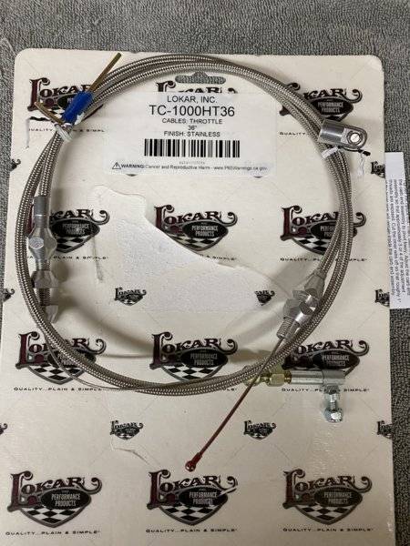

With the height of the intake on this Gen 3 hemi I will have to use an aftermarket linkage as well. I have yet to install it but I found that lokar has a very similar cable end to the Chrysler so the connection at the pedal will be the same. I will post pictures after I do the install which should be in the next few weeks.

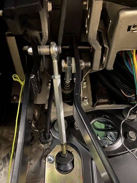

Thanks Pat, I guess I wasnt clear with my request, I need a pic of your brake pedal and how its connected to the hydroboost push rod. I have mine mounted but looks like Im going to have to modify the linkage.

I’ll get some better pictures tomorrow but this is what I have on my phone.

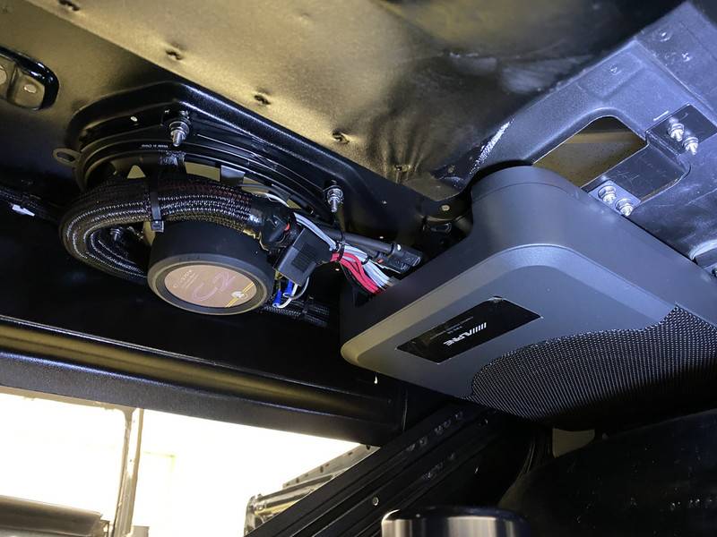

Finished up the tail light wiring, subwoofer & speakers, and started on the power window wiring.
Found a nice set of JL 5 x 7 speakers. They fit the factory speaker holes in the package tray without cutting.

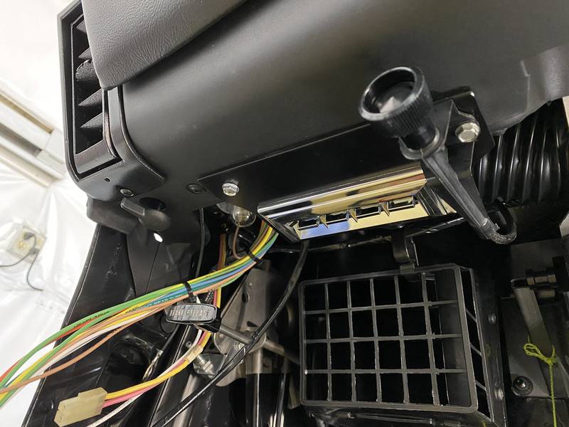

With all four windows using a special switch that utilizes the original crank handle I decided to put the separate 4 window controller switch assembly under the dash so the car will look as though it has manual windows (like the movie car;-)

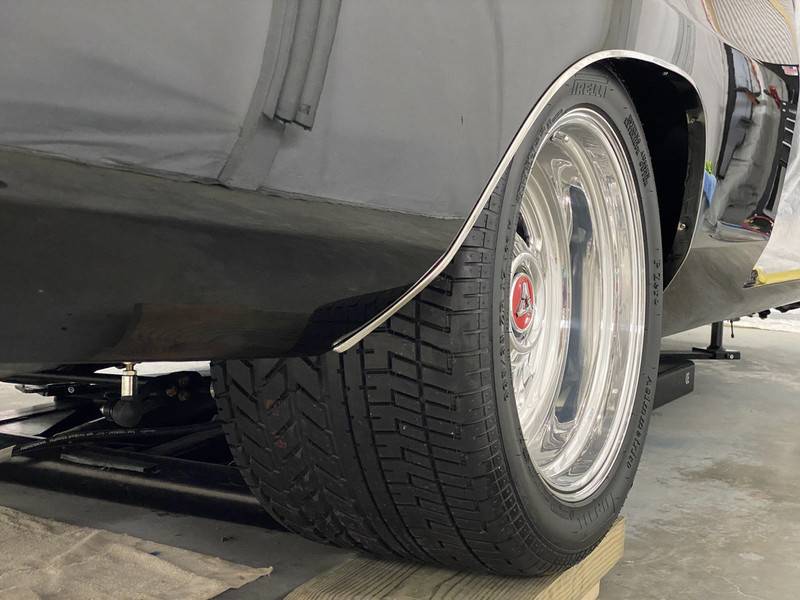

Started installing rear wheel well trim rings, And mounted one rear wheel as it’s been a few years since I’ve seen it on the car.

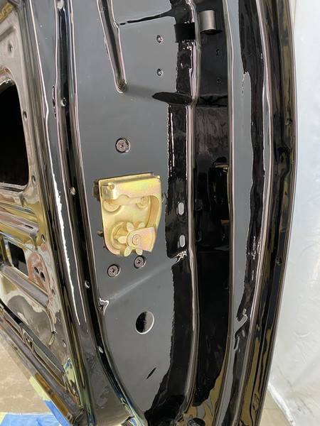

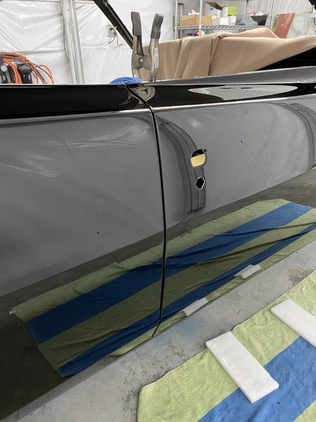

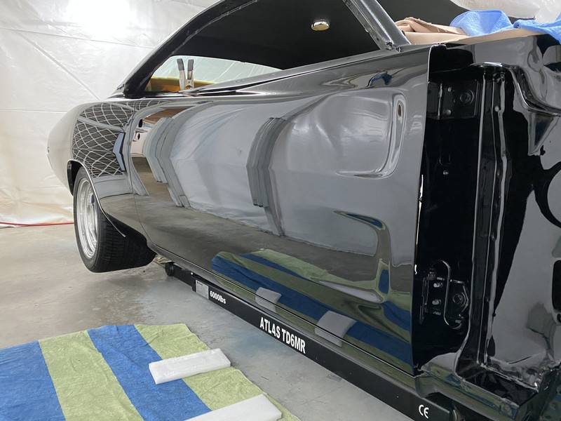

I hung the right side door over the weekend. Drilling all the hinges both in the door and on the car with an 1/8” drill bit, (when the car was in primer before disassembling) then used them as an alignment tool made the installation very easy. I also used an 8 pound weight wrapped in a towel inside the door to simulate the weight of the glass and vent.

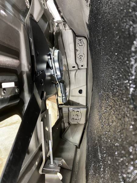

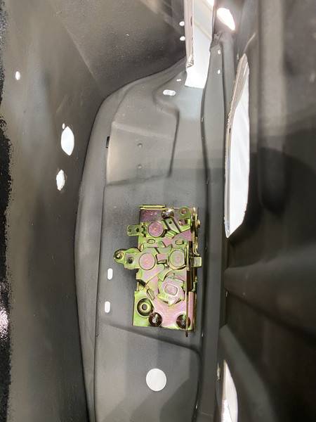

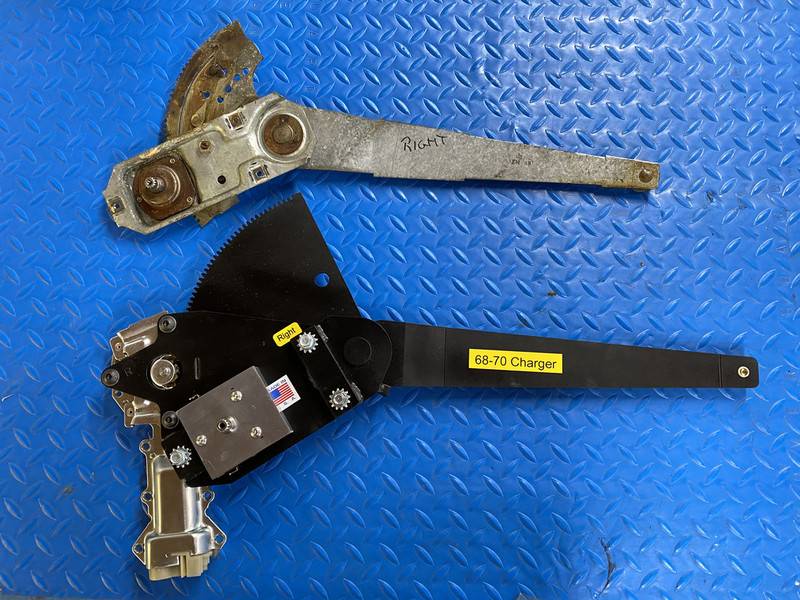

Installing some of the door hardware is a tedious process with new paint, but so far is going well! The new power window regulators are nice but I spend a lot of time laying out the electric crank switches. The power crank switches do not come with a Mopar adapter so I needed to cannibalize a crank handle shaft from an old rusted regulator and welded it to part of the new crank shaft. The crank switches work the power windows by moving the handle up or down about 15° to contact microswitches. A cool set up if you want power windows but the look of manual window cranks. All of my original window regulators are in excellent condition so I’ll need to find some rusted regulators to salvage the small crankshaft for the other three windows. PM me if you have some broken, rusted or bad window regulator’s
