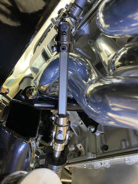

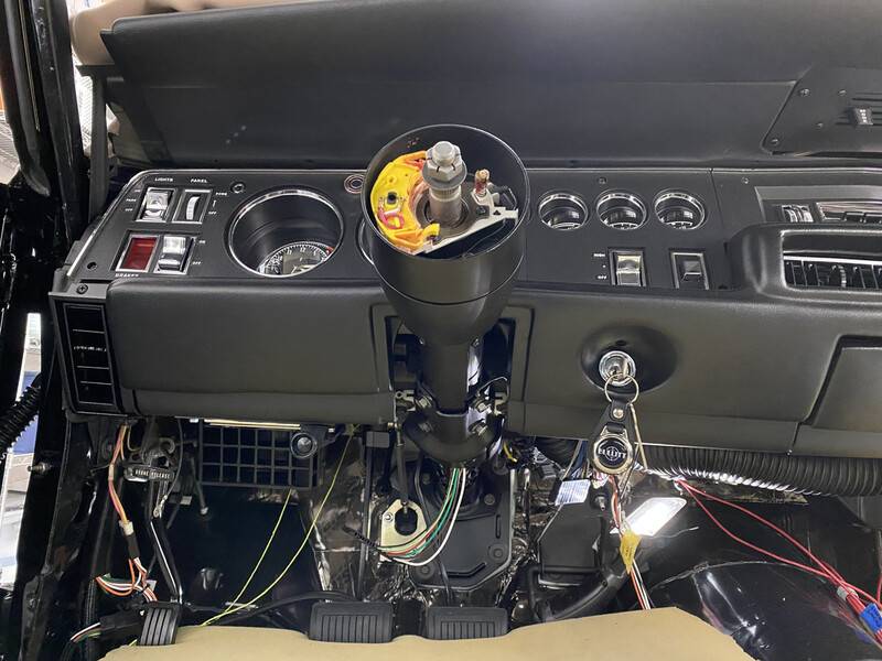

Pat, as always, nice job! Question, with that double d shaft, I don’t see a stand off bearing support and without it, that shaft will flop all over. Do you have that setup and I’m just not seeing it?

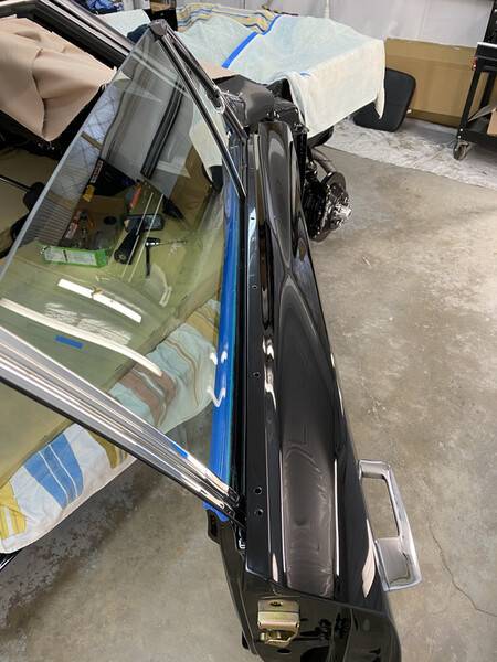

Pat, did you use the Nu-relics power Windows kit?
I really like them. My only complaint (More of a note than a complaint) was the lack of any type of a mounting solution provided for door switches other than the crank handle style. I had to space the regulators away from the door panel to give clearance for the switch connector and then trim the long pin off each switch. I then trimmed the sheetmetal to allow the Switch to fit in the area occupied by the original crank. It was that or order new door panels which I didn’t really need. A molded plastic box of some sort would be nice. I found the provided LED light was very handy for the install! I still use it daily.Yes sir, The door regulators have plenty of power, and this weekend I’ll be able to test the rear window.

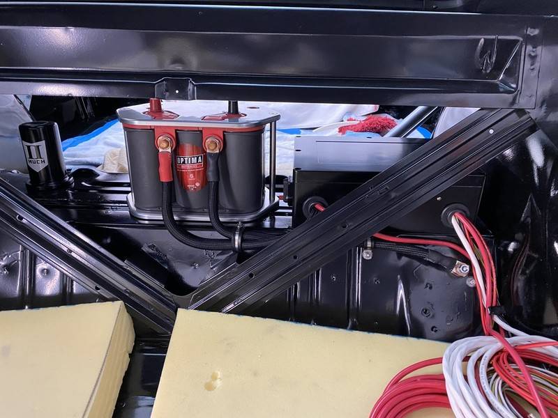

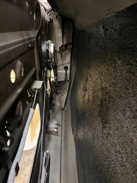

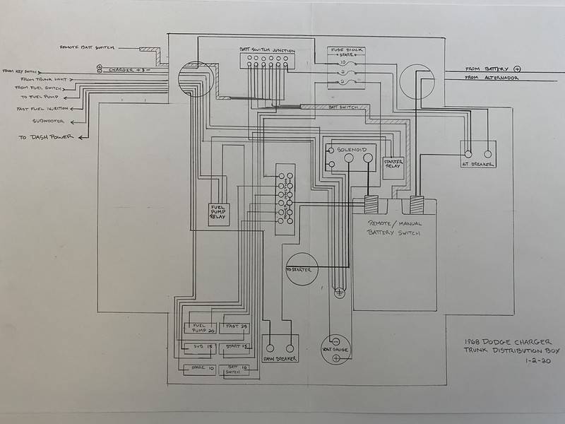

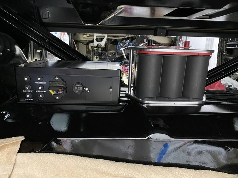

Trunk mounted battery and breaker box installed. I still have a lot of wiring to do but making progress.
well that saves me the time for figuring if there was room for 2 AGM batteries and or a small hidden subwoofer box. looks like possibly both could fit the battier got a bit further back in the trunk area. OR put the box end of the sub UNDER the rear deck lid kind of sort of like nissan did on my other car.
what's alpine box under your deck lid?
