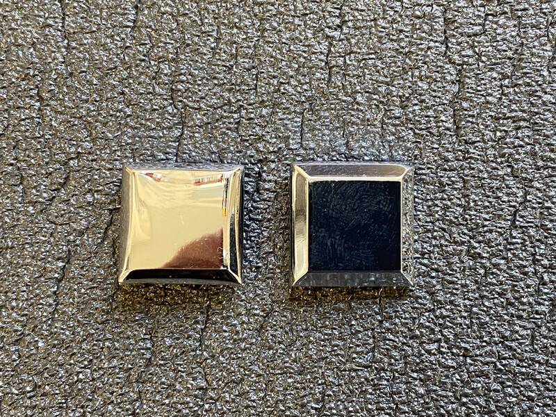

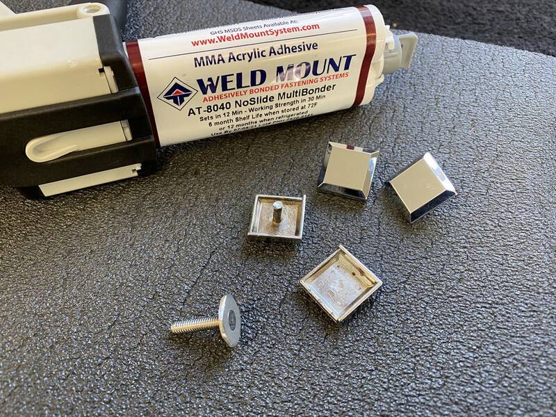

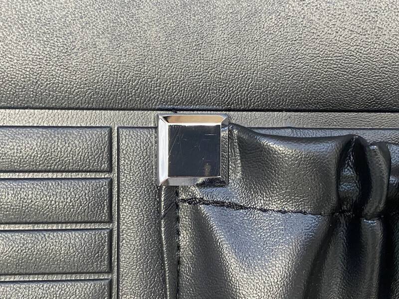

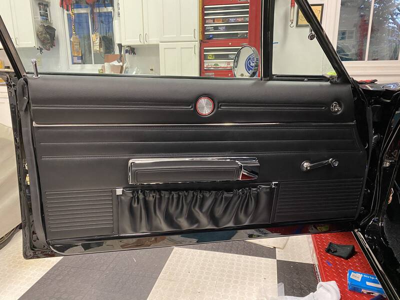

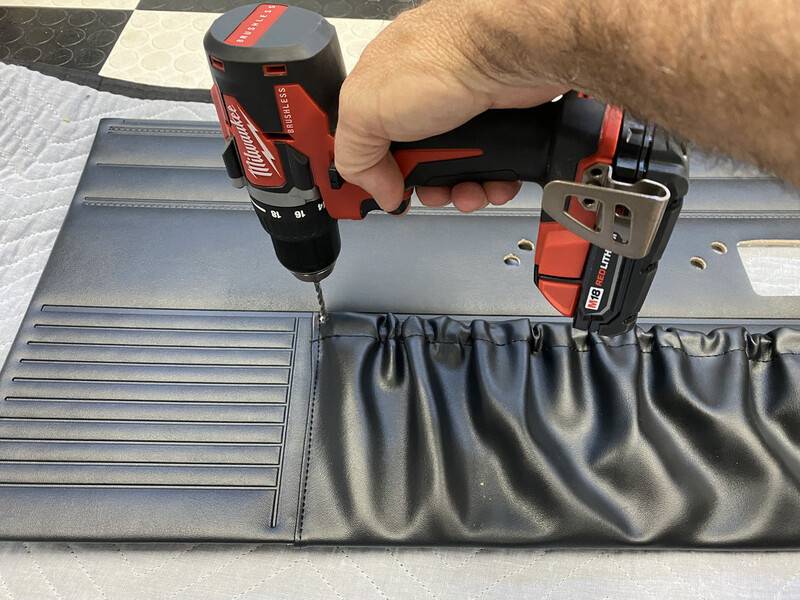

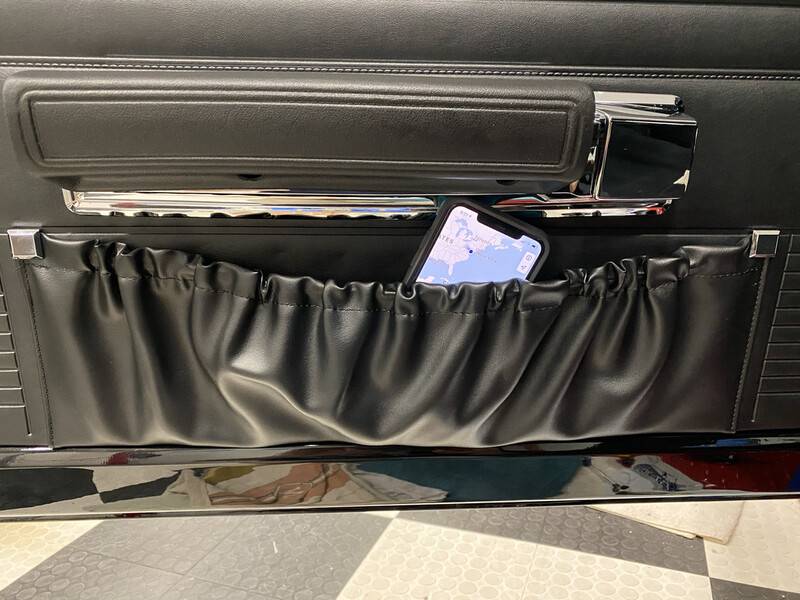

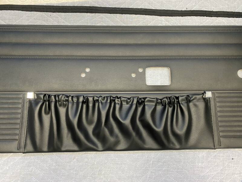

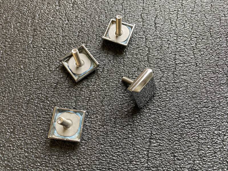

The reproduction Map pocket cufflinks did not look as nice as my originals (3rd pic) Unfortunately removing the originals doesn’t leave enough of the stud to reattach to the new panels. So I used my Weld Mount studs and epoxy on longer threaded studs making the cufflinks installation very simple. I think the 68 map pocket is a little big for today’s maps;-)
pj

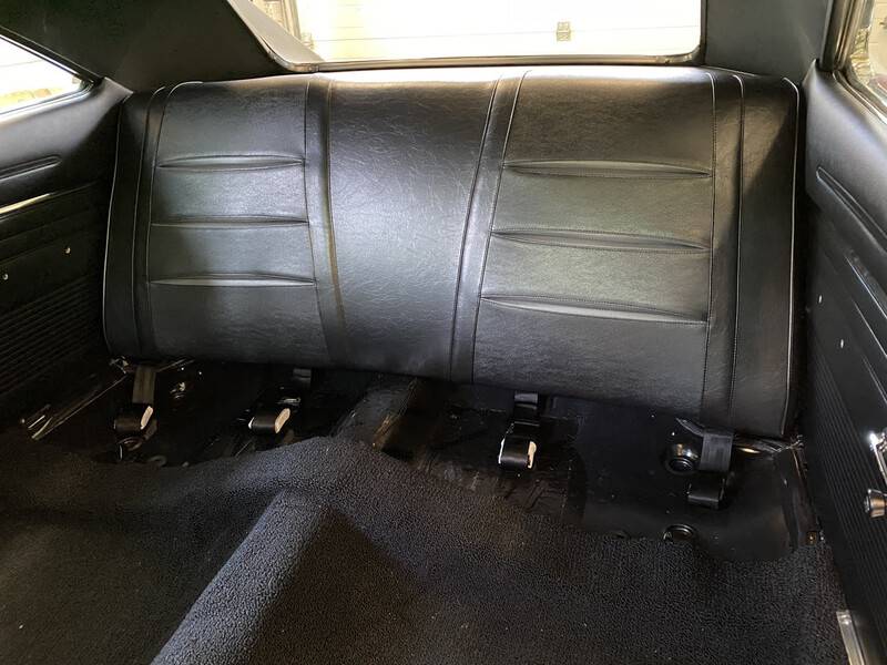

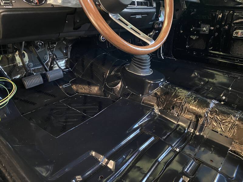

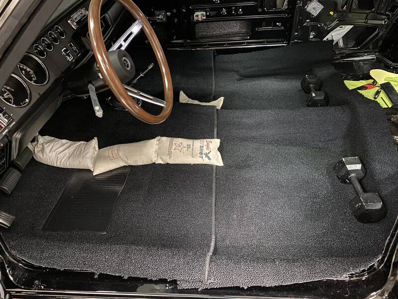

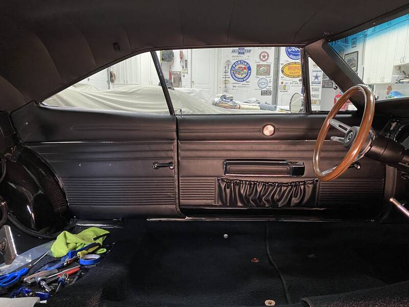

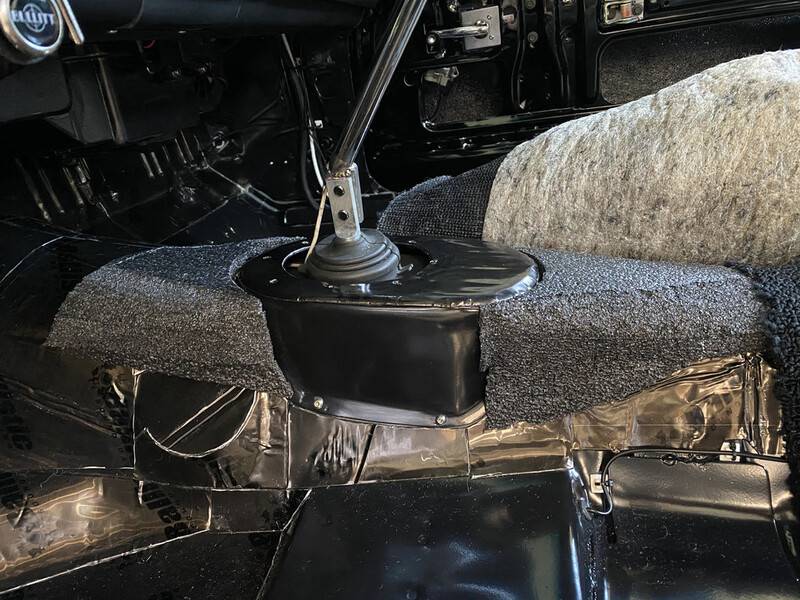

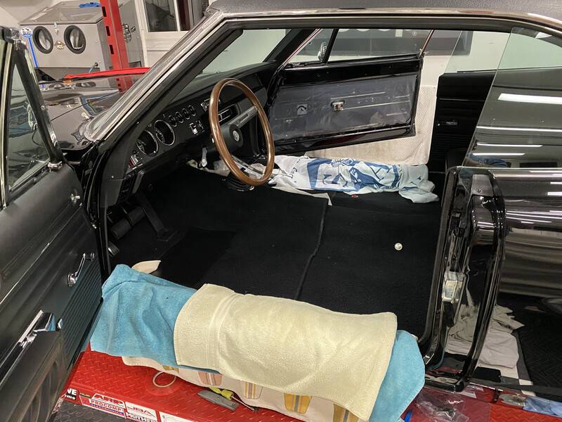

Legendary‘s carpet set fits great with a few modifications and the addition of some foam to fill the gap around the modified shifter tunnel. It’s nice that they make this carpet extra long at the firewall so you cannot see any of firewall. Just letting it relax for a few days with a some 25 pound lead bags.
Thanks
Pat

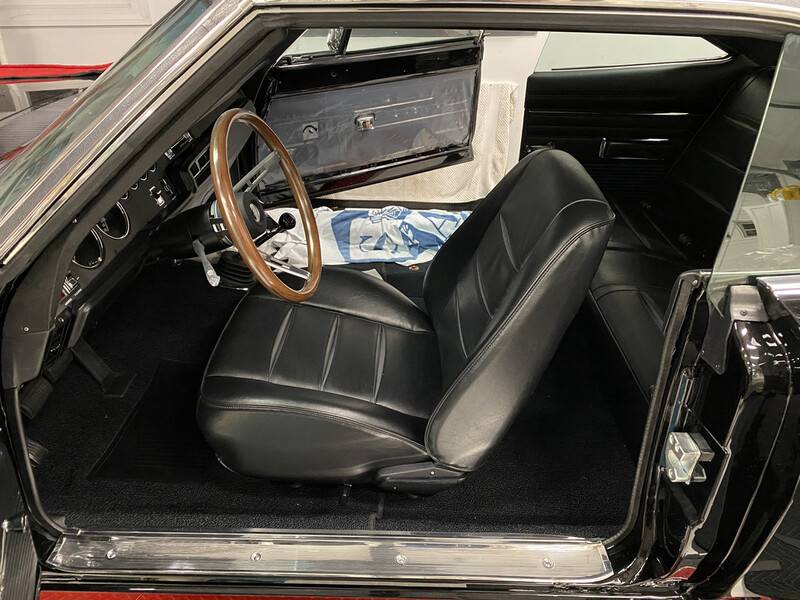

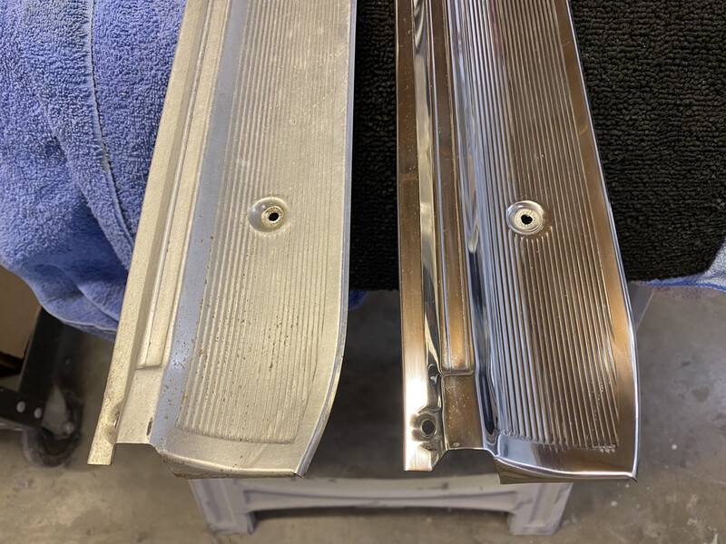

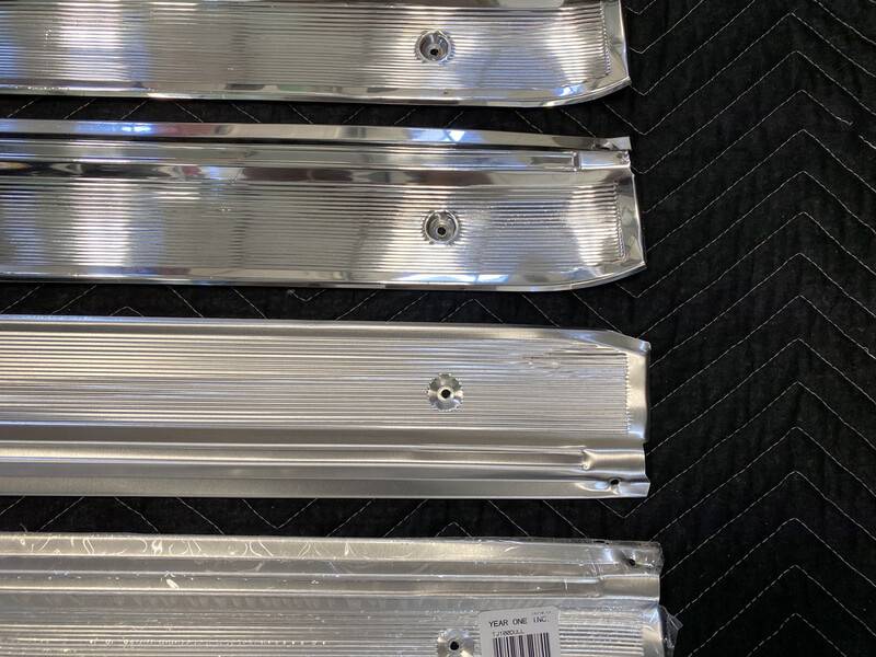

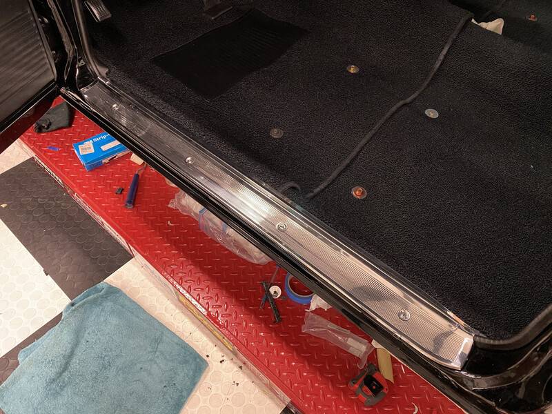

I decided to reuse the original door sills. The repro‘s don’t look as nice as the originals after polishing, even with a few dents and scratches.
Thanks
Pat
