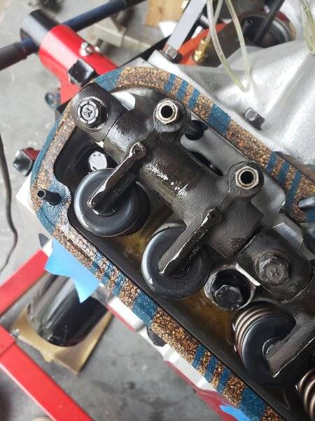

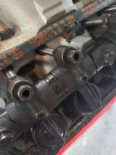

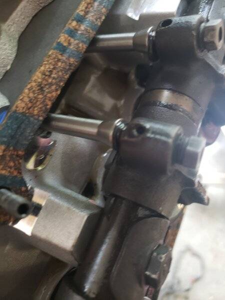

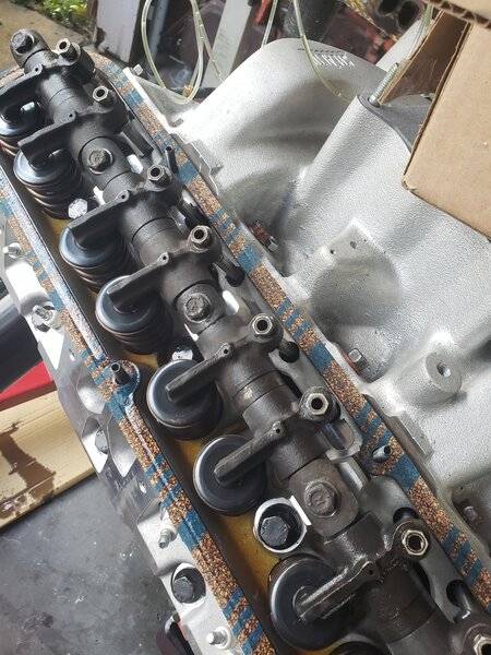

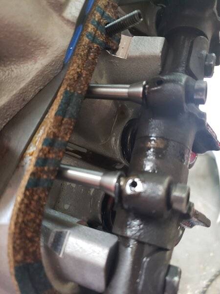

Who has run 273 rockers on there 360?
So I primed and turned engine over and primed and I didn't get no gusher like with stock rockers. I did this for over an hr. Many rotations of the engine. I got little trails from top hole, some of the rear holes oiled(not all) some dripped underneath. I even pulled one rocker shaft off to make sure oil holes where clean and clear. Do these rockers Just not use alot of oil or what? Almost makes me want to clearance my stock rockers and throw them in with some stock length pushrods. I don't see it oiling any better and i don't want burn up a new engine. This was also with 75-85 psi oil pressure. Is this normal or is something wrong?

yes orientated correctly.. notch is down on both and to rear on passenger side and front on driver side.. i have also cleaned all oil holes in shafts and rockers.. when i put factory rockers on here i get plenty of oil flow..
