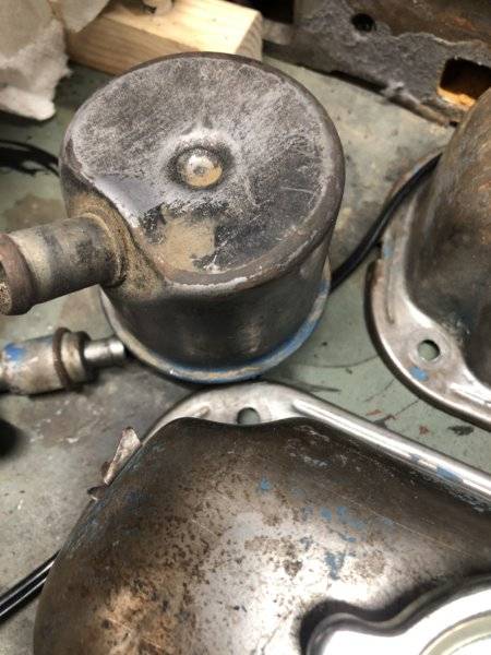

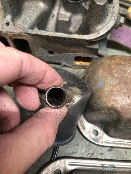

All I saw was the baffle but could there be some form of scouring that is stainless not sure as I can’t get in there. The solvents I used are greatly dampened (slow to move) when I pour it out. This could mean some scouring material is packed in there. All that just to keep the motor from burping out oil? Shouldn’t the airflow be coming in and going out the pcv on the other side?

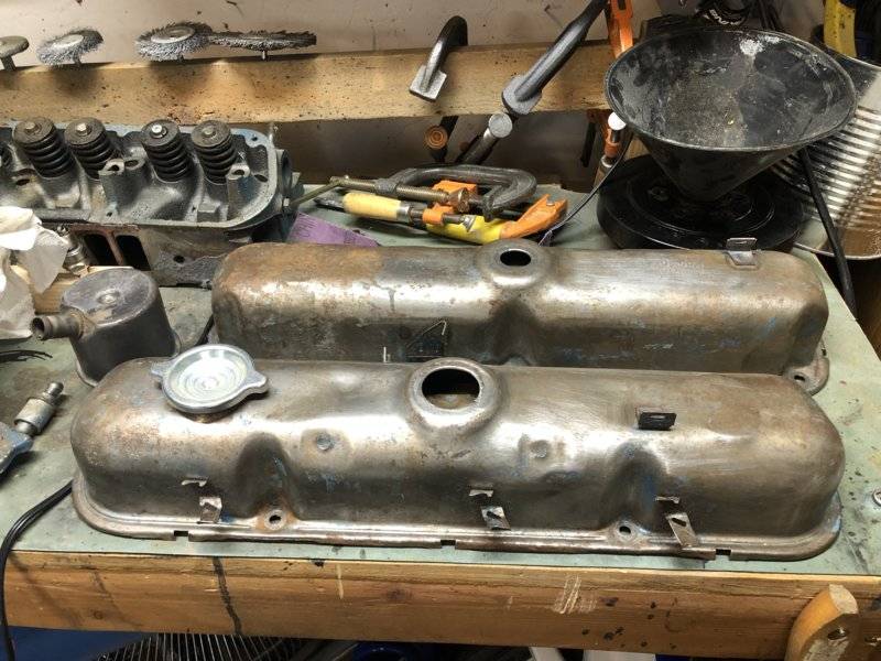

Trying to not go stir crazy so little bit of hobby time is good medicine for me. Cleaned off my old valve covers such that I can replace the chrome ones which I hate.
Soak it in Kerosene
I would like to reuse my 1970 valve cover breather as I like that stock look AND new one are like $50 min.
Question: Can I clean it out somehow and if so whats a good method?

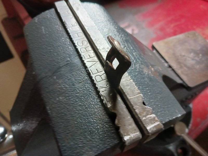

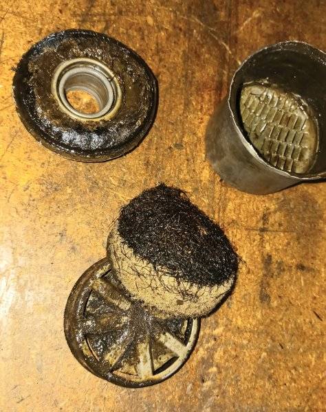

I know this is an older post, but after soaking and cleaning mine it would not come clean.
So I decided to open it up carefully with an old can opener and clean and reassemble.
Looks like the filtering material is similar to the little white filters GM used in the air cleaners in the 70s and 80s, with a layer of horse hair on top of it.
Hopefully I get this clean and back together.
