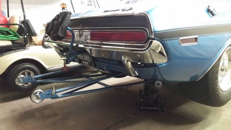

I have a narrowed 1 ton Dodge truck axle under my Challenger. Cut the full floating ends and old spring perches off. Added car ends and new perches. Ordered Strange 40 splined gun drilled l.w. axles, l.w. spool and 4:10 gears with a aluminum stud girdle cover.
With Strange brakes and pro stock style calipers (which cost more) to clear the inner bead lock ring. Adding whellie bar brackets and anti roll bar brackets. Everything was just under $1700.00. My buddy and I did all the fabricating. Obviously, with just mild street/strip car parts, it can even be done for less money.

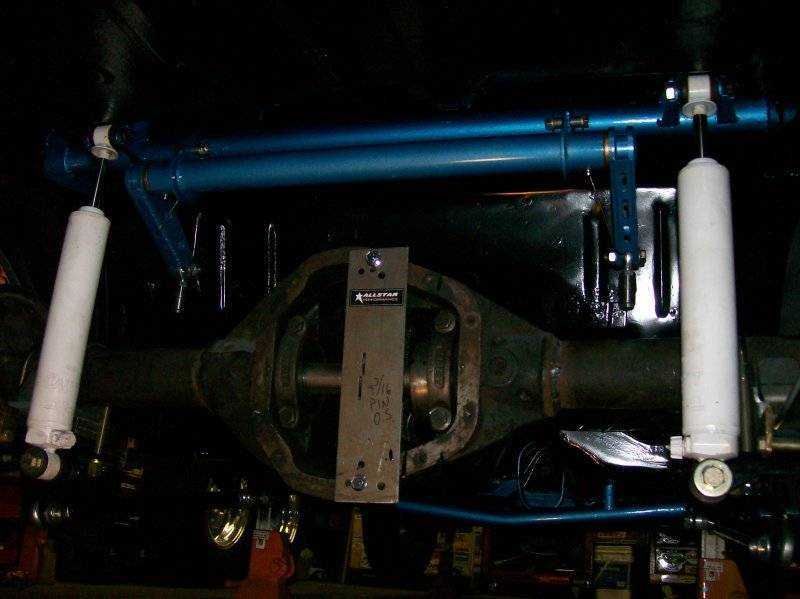

Got one narrowed to 52 inches under my 63 Fury. Like said, new ends and perches. No snubber. Using Caltracs. ruffcut
