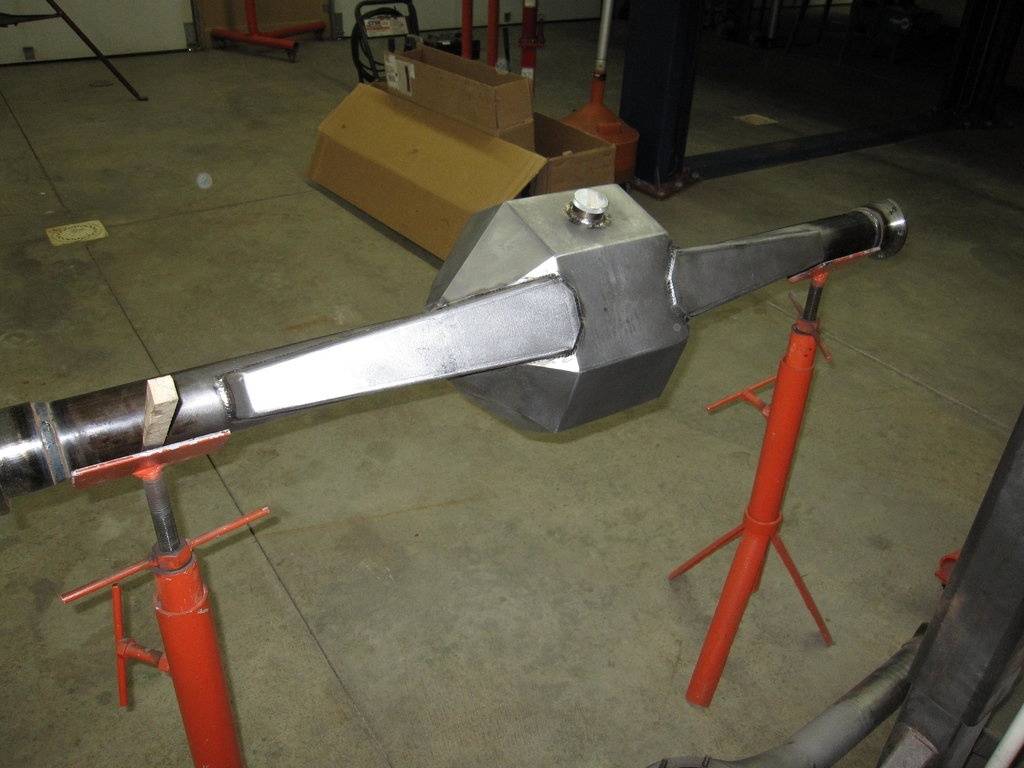

Hi fellas,
I am a diehard 8 3/4" fan, so I went to the fabricated Moser axle housing. It is a real nice piece but, I also ordered it with a back brace (why not spend an extra $150). My mistake was forgetting I had moved the springs inboard. The U bolts didn't clear the brace and the shocks sure as hell did not! So I'm cutting and shortening the back brace. Just beware if you follow my path!
In retrospect, I believe the back brace is overkill anyway. The Moser housing is much heavier duty than the OEM.
Mike

Hi fellas,
MikeView attachment 496781

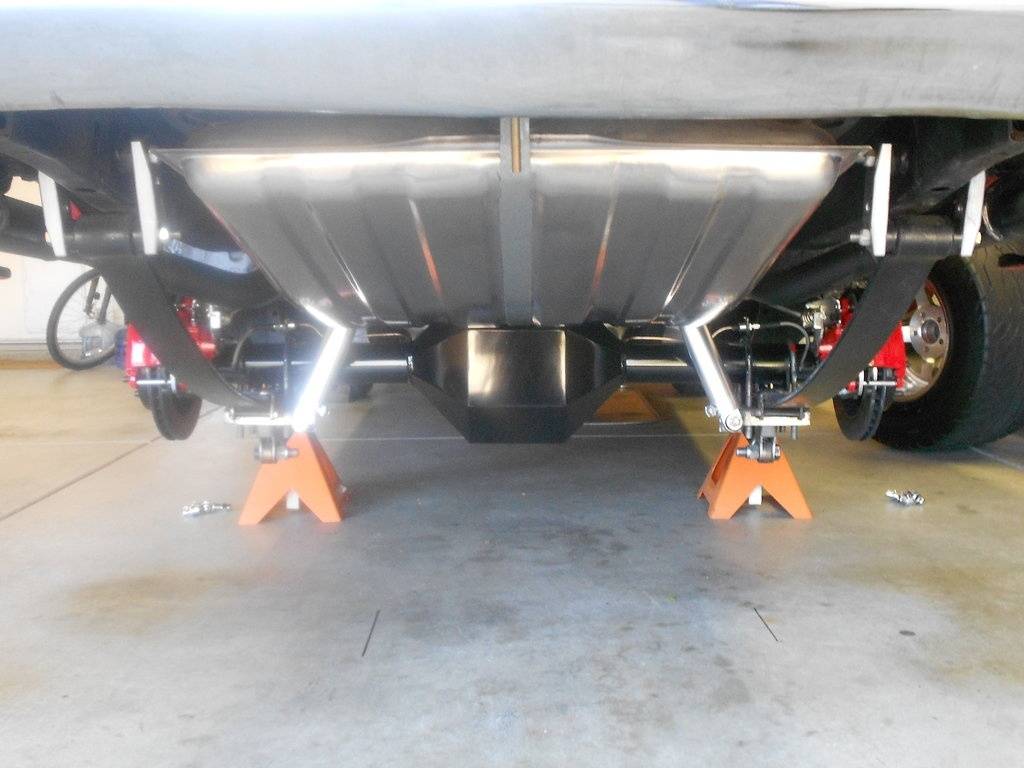

Mike something like this is what I'm Talking About !!, you Don't need a Dana The 8.75 is Bad ***, Plus the 8.75 is really easy to change Gears !! Yup I run 4.88, 4.56 & 4.30 For racing & For the Street!! Also a Gear Vendor, 45 min & I can literally have any of the 3 center sections I want, plus one time I broke my ring gear at the track and Dropped in a spare.

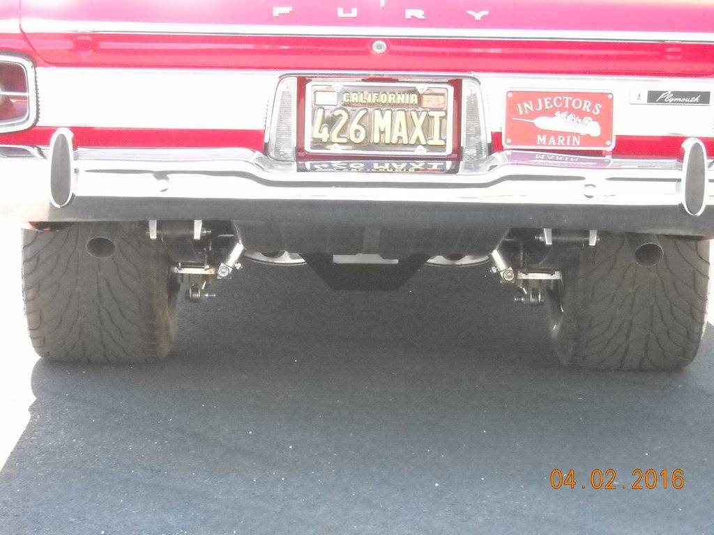

Mine's been in since last year. No problems. Pretty much a work of art, including the bottom drain and 2" filler on top.
