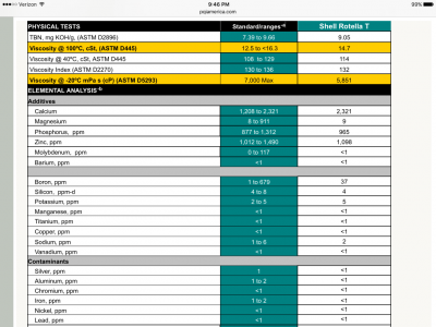

Rotella T3 15/40. 1200ppm of zinc. More than sufficient and reasonably priced.

"Shell is marketing their new CJ-4/SM oil as "Triple Protection," meaning it provides enhanced qualities for engine wear, soot control and engine cleanliness. Shell's Rotella indicates that on-road testing confirms the new Triple Protection technology produces better anti-wear characteristics than their existing CI-4+ rated Rotella oil. This is achieved despite a lower zinc and phosphorus additive level as called for by the API CJ-4 specification. The 15W-40 Rotella T with Triple Protection oil has approximately 1200 ppm of zinc and 1100 ppm phosphorus at the time of manufacture."

remember people,dont compare apples to oranges here.zinc is anti crush presure lube.1200 ppm or better is needed for flat tappet eng's only(higher spring presure with no roller bearing).dont need to worry with hyd or roller type eng.rotella did change the formula a year or two ago and i have not seen any new spec's that tell the real zinc ppm.
