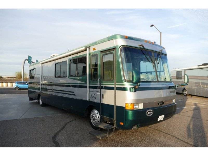

Cummins 5.9 diesel pusher, with an Allison 5 speed trans
you can find some of the smaller ones cheaper too
they are out there go to a RV Motorhome specific search
& forums
