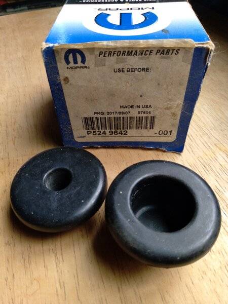

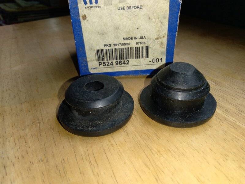

MP discontinued the grommets before they quit casting the valve covers.
This little plug and grommet set bears the same part number as the original grommet, and searching for it specifically (with or without the P) should bring up at least a couple suppliers. The kit was $17 if I remember right (outrageous for two chunks of rubber) but the question of whether they'll fit is answered.

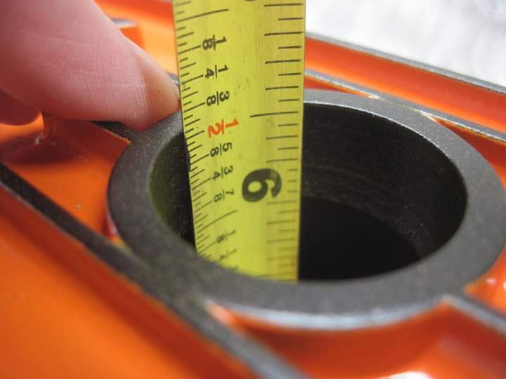

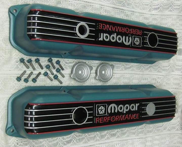

The biggest problem with aftermarket "Help Section" generic grommets is that the seating groove is too narrow to fit in the half inch thick knockout boss. (You can also cut the bottom off the plug to use a larger PCV valve if necessary.)
I hope this helps!

The knockout boss was way thicker than 1/2". Try more like 3/4"+. I'd be willing to bet that the grommets you show measure the same as the Phord ones do. 1.25" groove diameter and groove 1/2" depth. Those did not fit the VCs I have without machine work.MP discontinued the grommets before they quit casting the valve covers.
I hope this helps!
They will be here Sunday! Does anyone have a link for the PCV that fits these?
