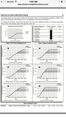

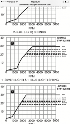

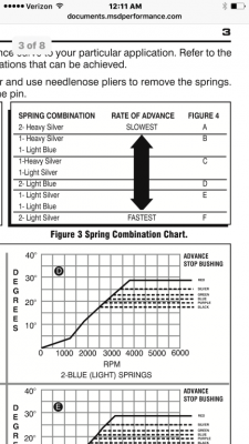

Anybody running one of these? What springs are you using for the mechanical advance? I have a basically stock 440 6bbl. Based on MSDs chart, using a light silver and light blue spring would bring all mechanical advance in by a little over 3000 rpm which sounds right but I haven't bought one yet, I'm just kicking tires.

I have an all mechanical advance on my unit from MSD with no vacuum at all. On mine the light blue and light silver springs bring the timing all in by 2500, the unit comes from the factory with the blue 21 degree advance stop bushing. The curve can be changed with springs of course and the amount of advance off of initial is determined by the bushing. Hope this is informative. And by the way, MSD is the balls....every one I know uses them and they are outstanding ignitions systems.
If you want a faster advance curve, there are aftermarkets springs that are lighter than the MSD light silver.

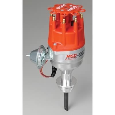

I have the RTR pictured above and haven't had any issues with it. I found it easy to work with. It's been awhile - not sure of the springs I have in it but I didn't change what it came with for my 440 Six Pack.
