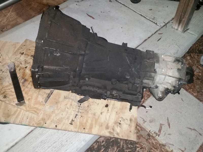

Got the transmission out of the truck today . . . 315,000 miles . . . time for a rebuild . . .

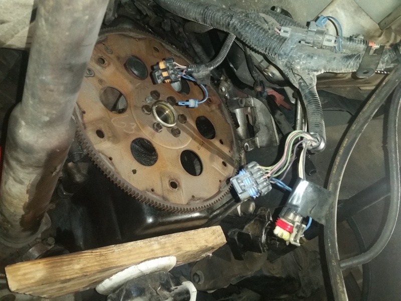

And a big old gaping hole under the truck ( in case you thought is was just a spare trans sitting around . . . )

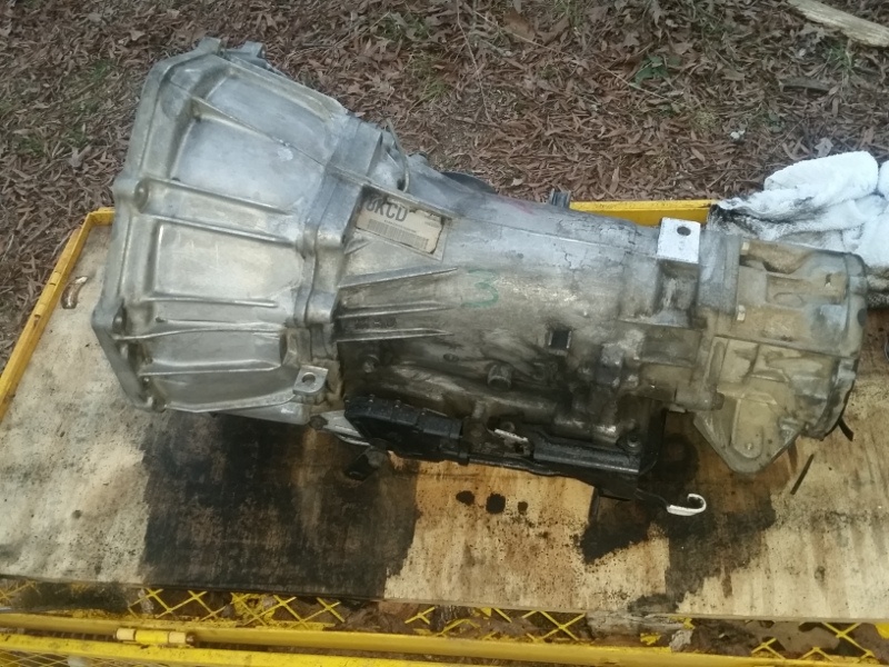

Believe it or not . . . I actually found a transmission under that pile of dirt . . .

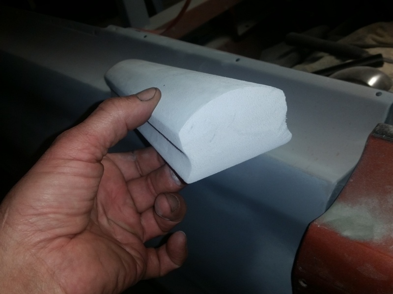

And here's a view of the durblock that I got for my bodywork . . . got the 16" version, and it seems to work well on my panels . . .

Posted a pic of the one that I bought and use . . .

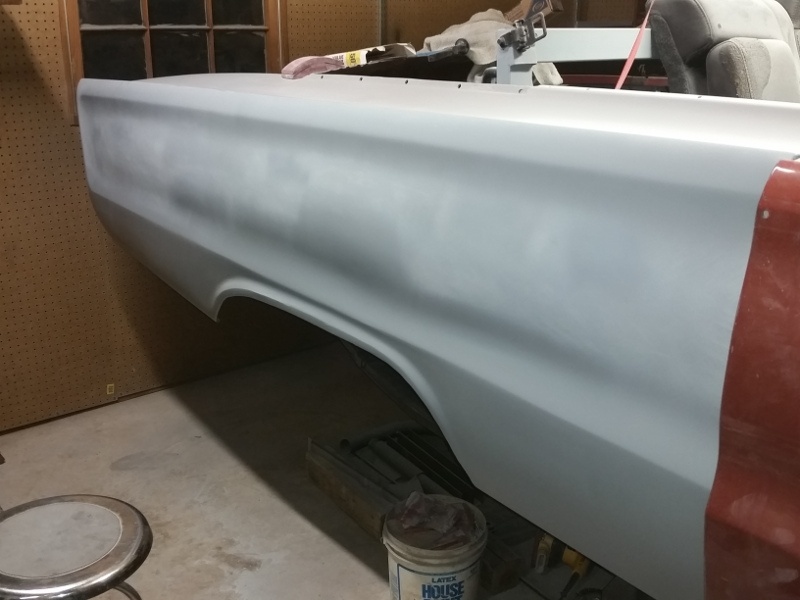

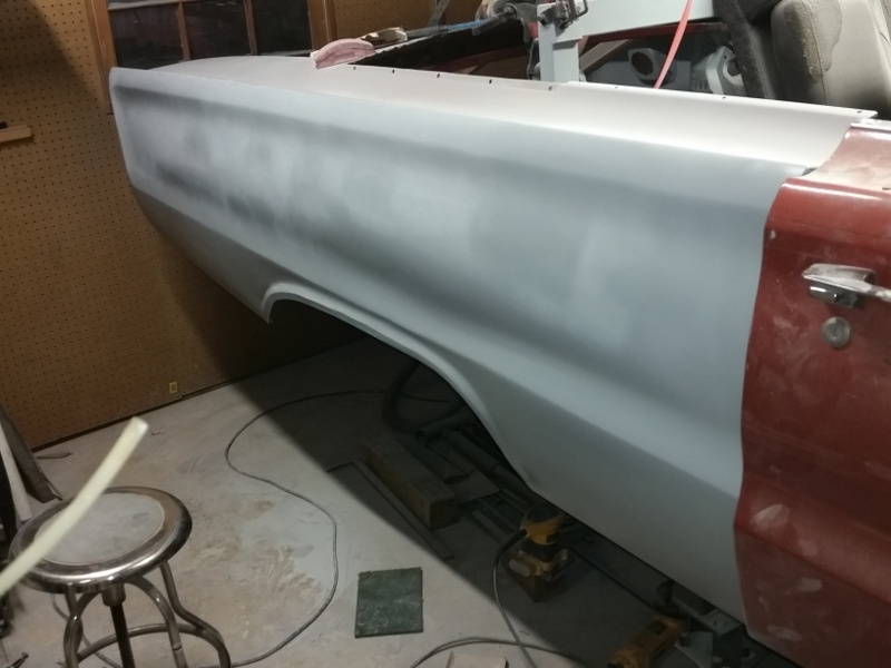

Spent the day working on this panel, and it's really ( finally ) coming together for me ( except the wheel lip )

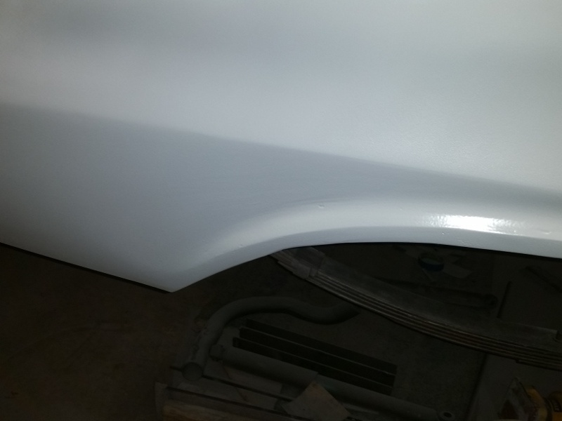

And this area . . . I think I've finally got it nailed down . . . ( good thing I don't do this for a living - I'd starve ) . . .
Still fighting with the area behind the wheel, one spot over the wheel, and the whole wheel well lip . . . lots of angles and curves . . .
Back at it again tomorrow . . .
Looking good. For the radius around the lip, broken record time:
http://www.dura-block.com/product-page/round-hook-loop-block-11-l
Don't be afraid to cut the round one in to smaller pieces to work the radius around the lip and use big long strokes around the wheel well. It will take a while. I spent a good week getting the wheel well in front of the rear wheel rebuild to look normal (where a long ago accident happened).
Are you using expensive filler that dries fast and sands like butter? I used Marsol (3M now) Platinum Filler. That stuff drys in 20 minutes and sands like drywall plaster with 80 grit. I was getting 2-3 coats on each evening as I was getting that corner shaped. Put on what you think in your mind is too much and when you start thinking you can sand off just a little more and it will be perfect stop and throw on another coat :)

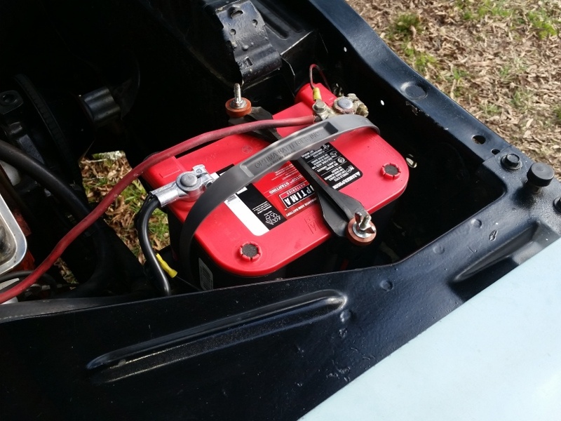

Well . . . she's got a new "heart" . . . ( then I spent a couple hours cleaning up the acid with baking soda and water, found loose and missing bolts on the battery tray from the previous owner - fixed all that - and did a little much needed cleanup on the 66 ) Now I need to make a "new" battery hold down . . . YEAH - Another project . . .

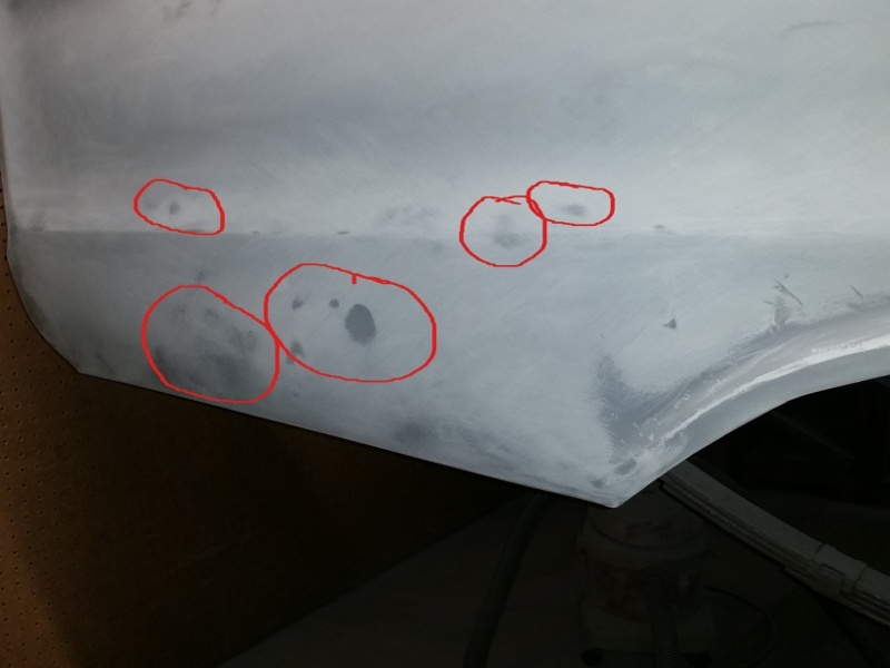

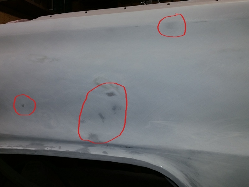

But after all of that, I still made it to the shop and here's the first round of sanding ( I thought I was close - WRONG )
In front of the wheel well - thought this was nailed . . . WRONG . . .

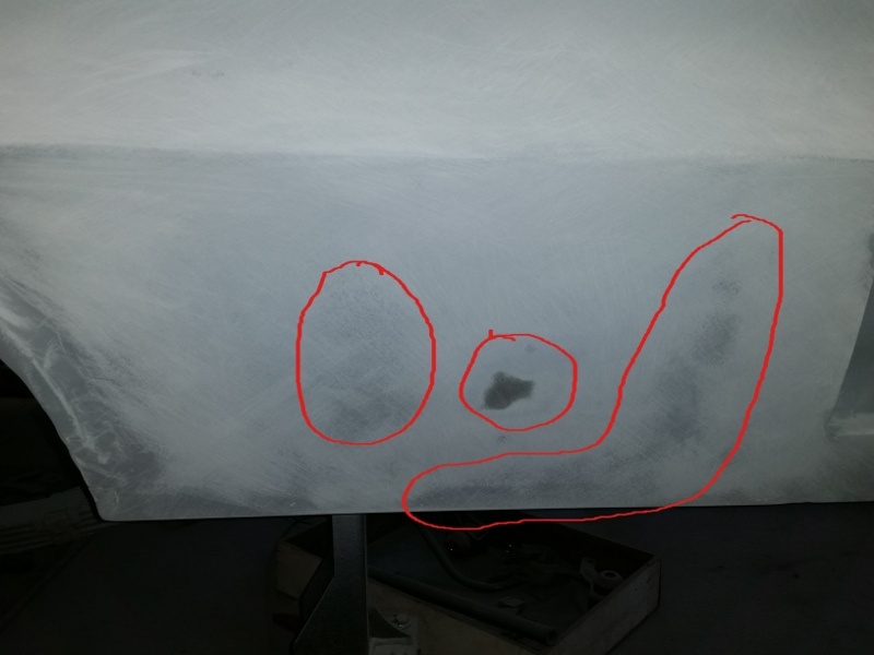

Behind the wheel well, I knew this was bad ( don't even look at the wheel lip . . . ugh )

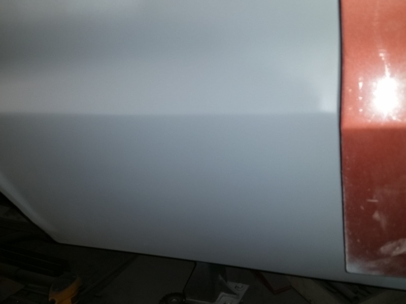

But after a couple rounds of plastic filler skim coats, epoxy primer, and high build primer . . . I'm liking the results . . .
The whole body shot ( even got the shop cleaned up, swept up the dust on the floor . . . I'm pretty happy . . .

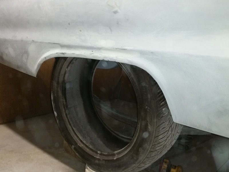

Couldn't resist . . . 747Mopar gave me an old 365-50-R20 tire he had at the house . . . do I tucked it up under the car . . .
WOW . . . I like it ( if only it was a little wider . . . yeah . . . )

Ha Ha and you thought you were close :) The next words of wisdom I can give is if you think you know where it is low/high it is really low/high at least 4x larger than you think. When you slather the filler where you believe you need it take it out 4x from where you planned to and and make it way thicker than you think. It will be about right!
