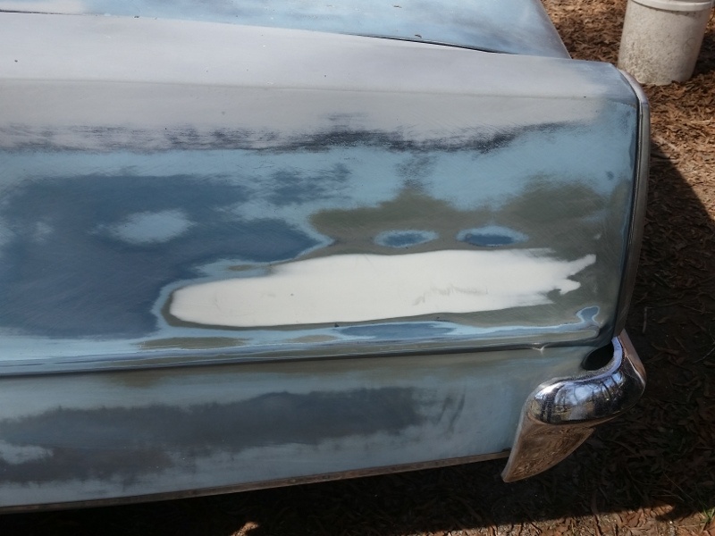

Ha Ha and you thought you were close :) The next words of wisdom I can give is if you think you know where it is low/high it is really low/high at least 4x larger than you think. When you slather the filler where you believe you need it take it out 4x from where you planned to and and make it way thicker than you think. It will be about right!
Good advice, saves a lot of time putting more on the first time rather than adding and adding and adding lol.

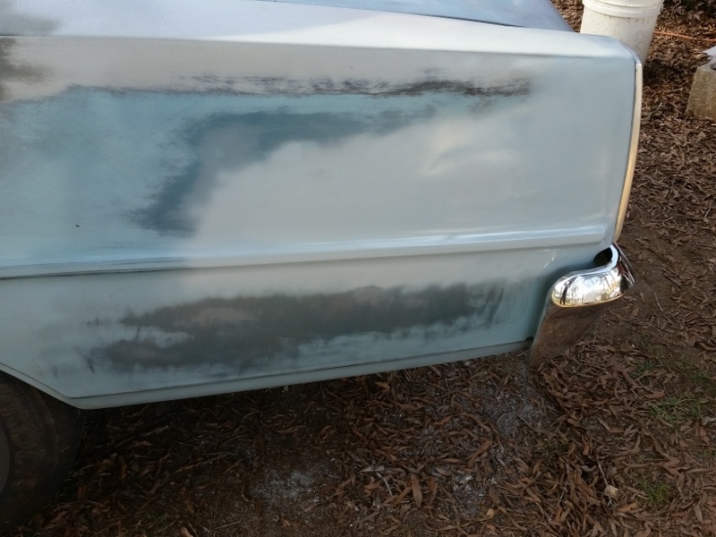

Jim told me about glazing compound, and that the low spot is really 4X what you think . . . so, I figured I use the Chevy II as my "experimental guinea pig" . . . filling in the side emblem holes and trying to get the panel straight . . . here what I had when the feathering was done . . . Thanks Jim ( or is that thanks a lot Jim )

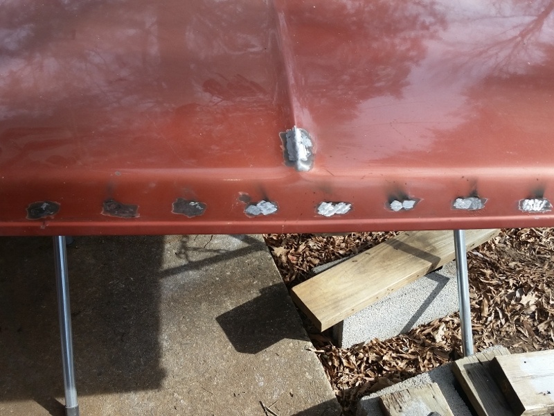

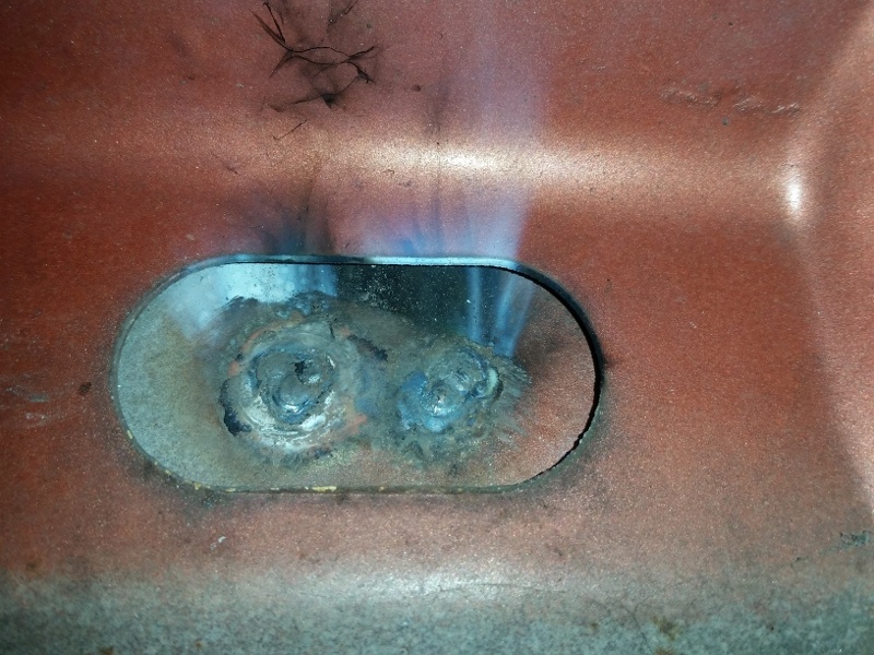

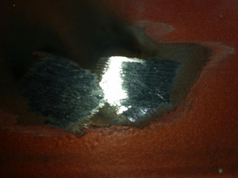

With the Chevy II in progress, I needed a break from more sanding, so I broke out the Belvedere hood to fill in some more holes . . . Weld in the PLYMOUTH mounting holes and the hood ornament holes . . .
And grind down the welds smooth . . .
Check in on the guard dog . . . S - L - A - C - K - E - R ! ! ! Asleep on the job ( again ) LMAO . . . .

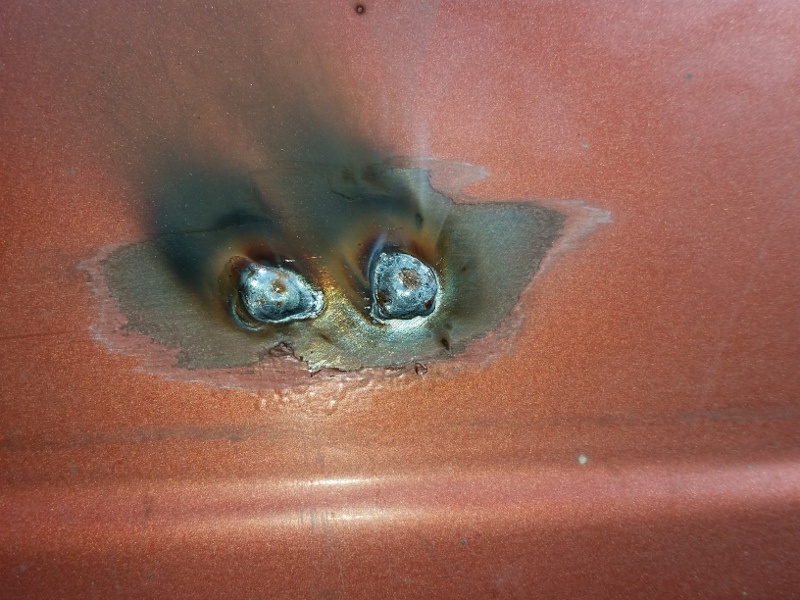

And the finished product . . . holes all welded and ground down . . .
Back side of the welds looking pretty good too . . .

Got back into the shop and sanded the passenger rear quarter panel, thinking I was about 90-95%, but with Jim's input . . . I guess that puts me at 70-80% instead ( going backwards ) . . . but I've got glazing compound and practice on the Chevy II that I can now apply to the Belvedere and make it look that much better - just remember the spot is 4X bigger than you think, then sand it off . . .

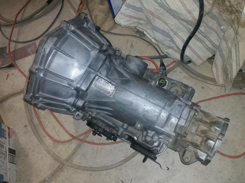

Finally got the word back on the transmission today . . .
"something in the valve body was destroyed over time ( the truck is a 98 - that's 19 years old ) causing high line pressure and the result of that is the second gear bands getting spun around the housing and not engaging correctly. That apparently destroyed 2nd gear . . . was not ready today, so I'll be waiting until Monday to pick it up.
The rebuilder stated this about my rebuilt transmission - "this m-fer is built the best way that it can be"

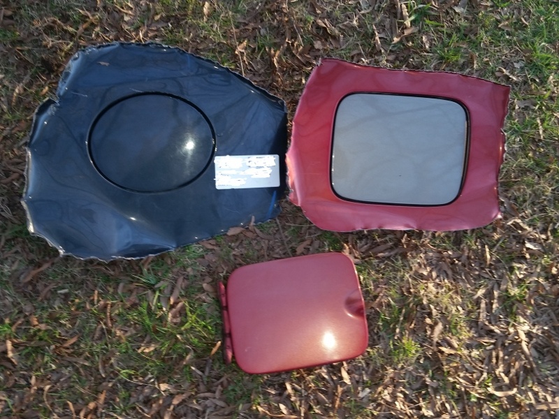

Spent most of the morning at the local pull-a-part ( or in my case it's "tear-apart" ) trying to find replacement covers for my 66. The gas fill cover that I had originally got for the 66, ended up being installed on the 67 Belvedere . . . and I really like the way it turned out . . .
So here's the (2) candidates that I got for the 66 . . . both will have a handle by the drivers seat to open the cover.
I pulled the one on the left first . . . but in thinking about how "square" the shoebox looks, I also grabbed the one on the right . . . from the color, you can see that the original cover ( red ) had a finger grab that prevented it from being flush with the car. As I was waling around the lot, I found the other cover ( that is in place ) that is fully flush . . . which is the cover that I would probably use if I go with the square cover . . .
Or do I go with the oval cover just to make it different ? ? ? I'll have to put some thought into it . . .

I'm liking the square gas door for the shoebox but I think either option would look pretty trick.

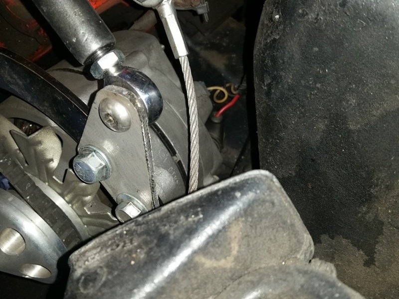

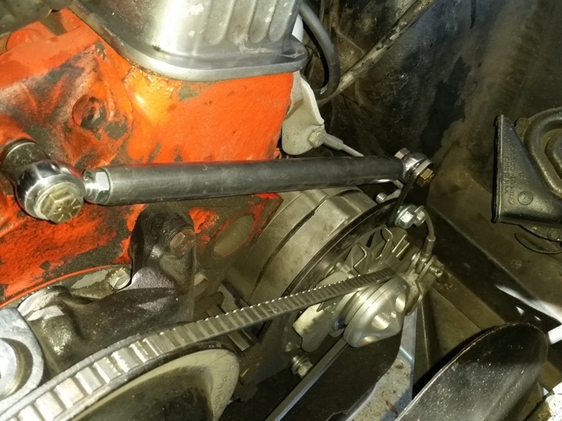

Got some more TLC for the daily drivers that needed to get done, so I had to finish up a bracket for the shoebox . .

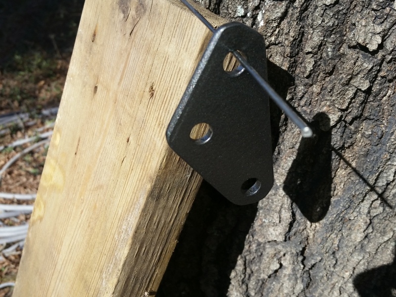

Made a new brace with ball rod ends, left had thread on one end, right hand on the other - to allow tensioning the alternator belt.
Needed to make a bracket to get it attached to the alternator - this was the final fitting for the bracket.
Add paint, and get it ready to put into the car . . .
Outside of the block needing some cleaning, and painting, here's the final product - worked out very well.
( replaces a "quick" simple bracket that I needed to keep the alternator from vibrating )

The rebuilt transmission and new torque converter ( the repair sheet states that high pressures made a mess out of the old one )
And this rebuild was quoted as being done the right way . . . can't wait to see how it drives . . .

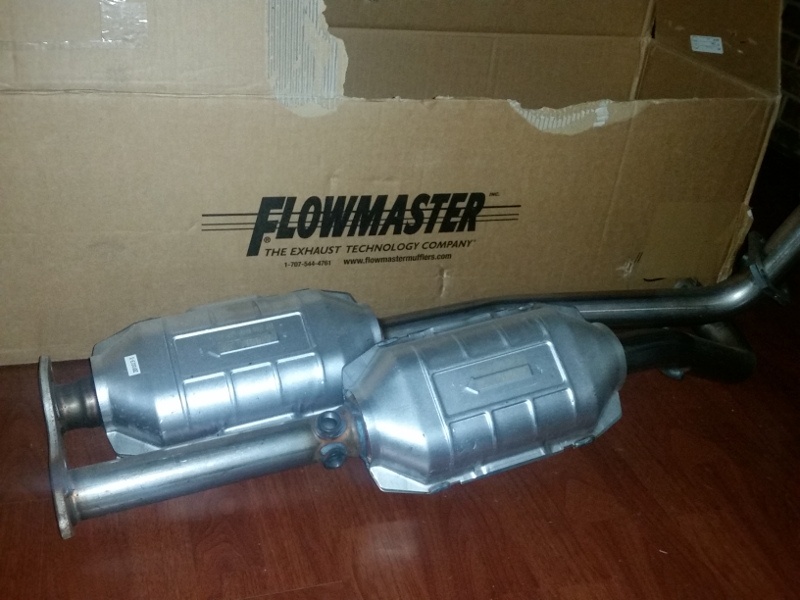

And the new catalytic converters too . . . was getting engine codes die to them - so it's a whole new exhaust going in . . .

I definitely agree with Goon on the filler door, oval would be obtuse with all of the straight edges/angles...

Hey Goon . . . I have to agree with you on the rectangular cover . . . It's more in line with the style of the rest of the car . . .

I'm leaning toward the rectangular one . . . it's the same as the one I've got on the Belvedere . . . looks nice . . . so sorry that your father-in-law didn't think of adding it, I guess that I just want to be different . . . ( lol . . . and I am )

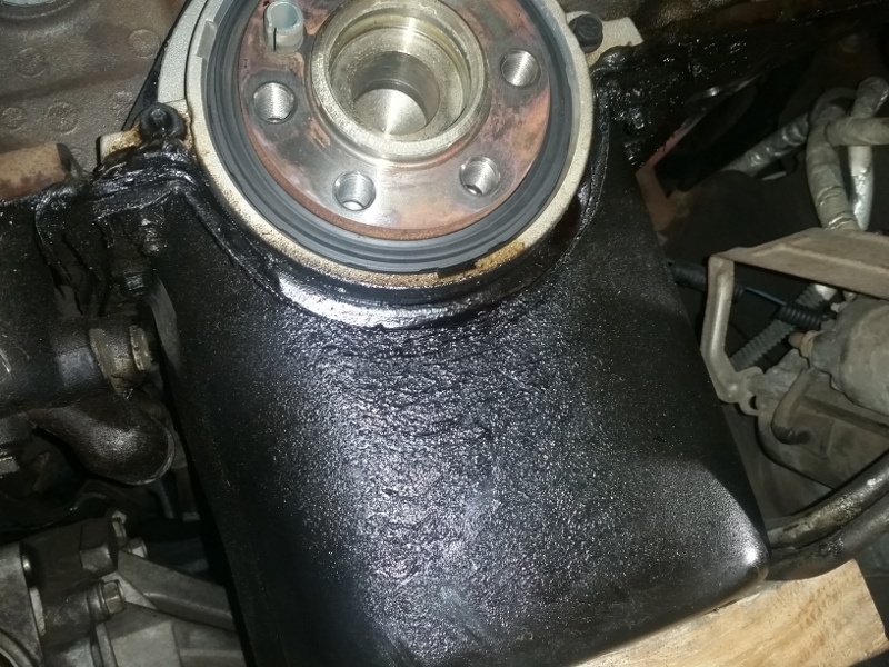

Got a replacement rear main seal for the truck . . . since I was this far into it . . .
And . . .
It was hardly leaking at all . . . I mean, only a little bit, from the bottom . . . maybe . . .
The darn thing was a hard as a rock and I'm glad that I got it done . . . maybe that will help ( a little ) of the oil that I lose ( but it doesn't leak where I park ) . . . it's all on the oil pan ! ! ! LOL
